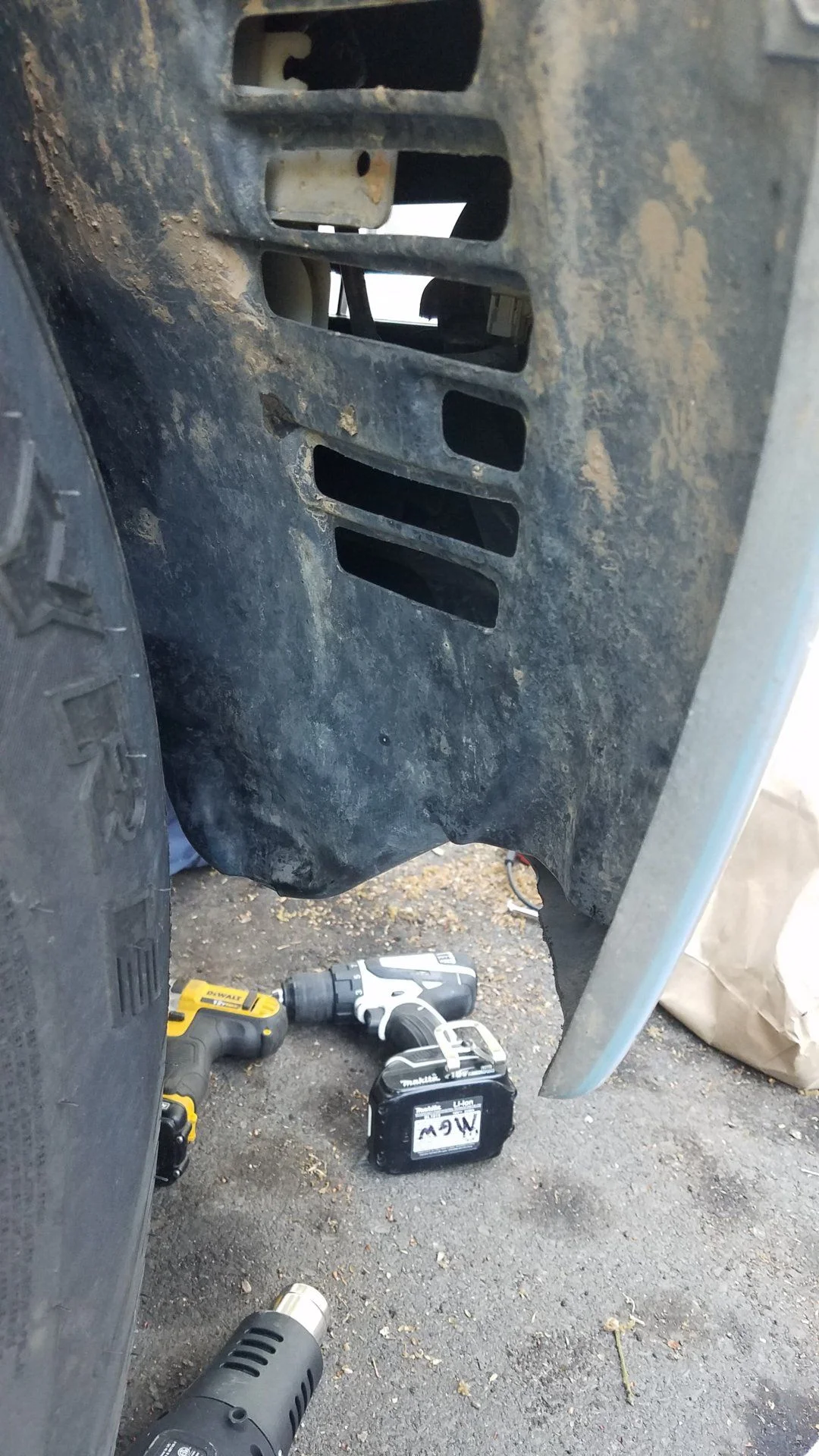

Just trimmed the bumper, moved the liner forward and heat gun around the well. Any issues with the pinch weld? I'll probably secure the spare inside with a cover until a more permanent solution. Or custom drawer setup with d rings to strap down the tire.

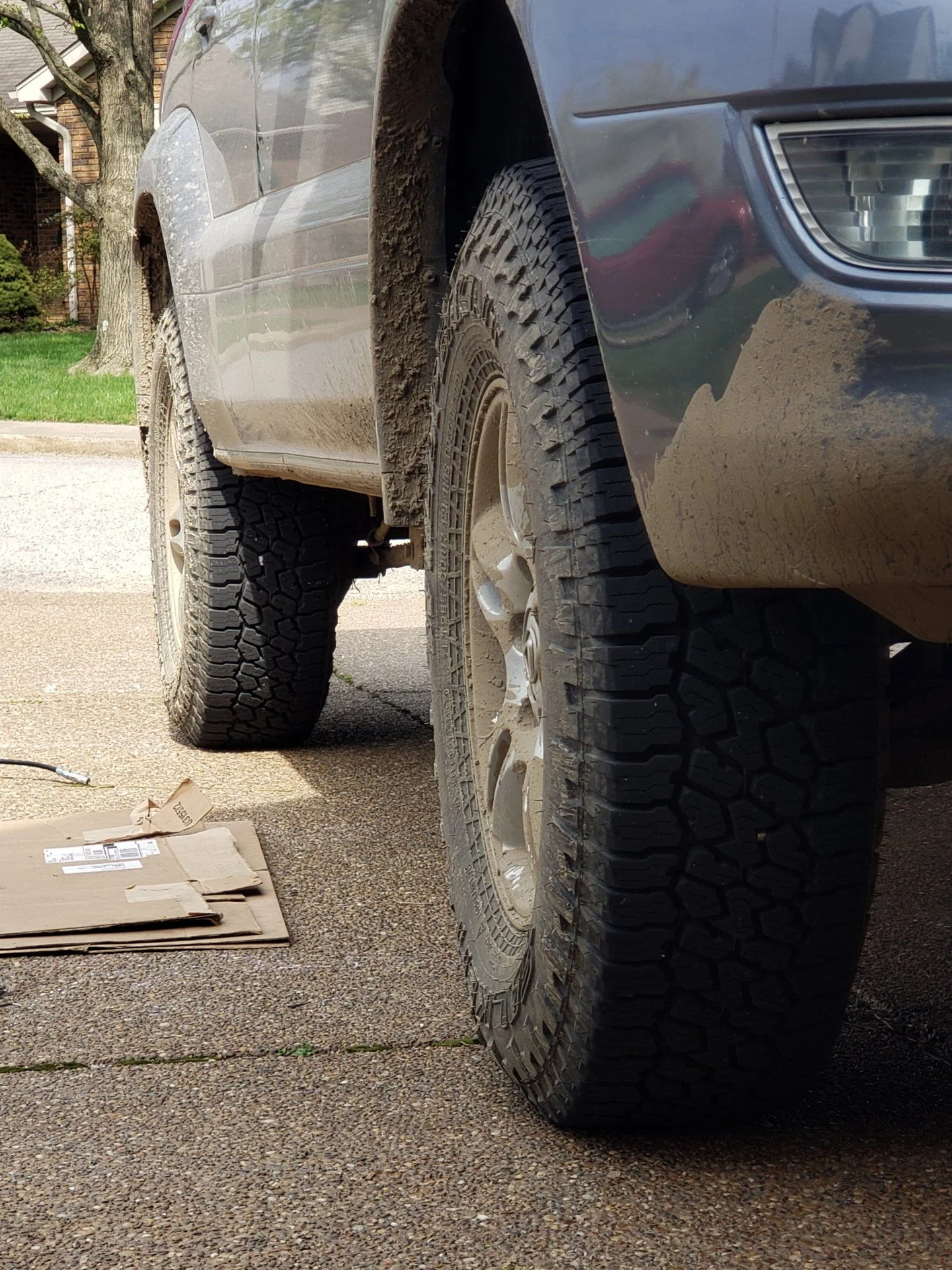

Hello. I just went through the same process and settled on the LT255/80/17 wildpeaks for price point and fitment ease. These tires feel way better on road than the stock spec street tire i started with. Very little noise but noticable weight with stop and go. Offroad they hook up great on dry surfaces. No mud yet. Didn't notice a difference with atrac. Did notice a smoother ride doing mild offroading without airing down.
They look good! I've heard way more pros than cons about the 255/80/17. I've moded it for extra fitment, hopefully was enough.

Did you trim off the front of the fender liner then move it forward into the bumper and secure it with screws? I have a heat gun to push in the upper portion of the liner. I figure I would have to trim the outer corner tab of the bumper. I hope I won't have to trim the bumper much.
Yes I cut the lower portion off and then shoved it all the way forward. I was able to just drill a hole in the liner and use heavy duty zip ties to keep it tight and from flapping at high speeds. 👍
