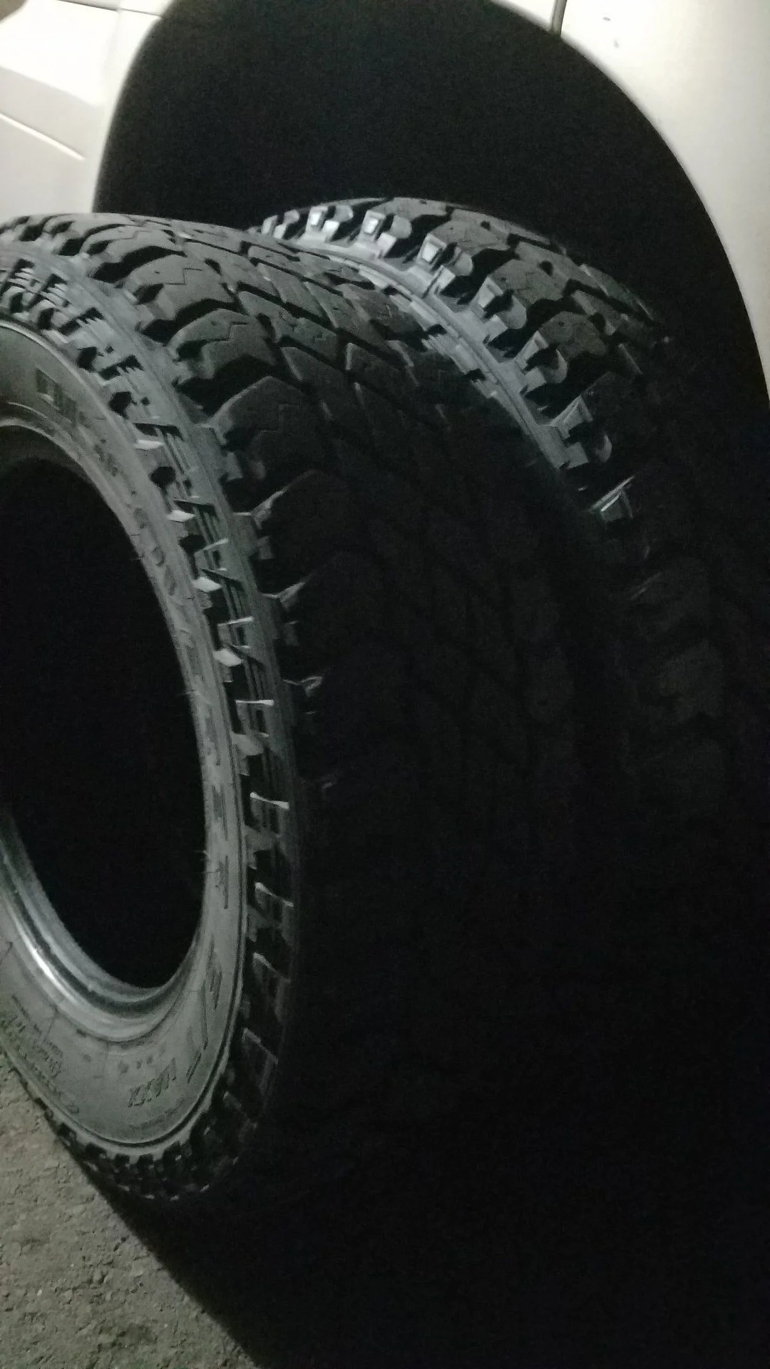

7 months later and finally made the move. Some used/worn 245/75/17 st maxx laying around at work went on back in August during the fire storms. They were cupped in the rear and rode like s***.
The 255/80 are smooth and no pull. When parking at the grocery store heard what sounded like corner of the bumper making contact. Otherwise, these tires look perfect. Now my eyes can stop bleeding from the tire research.
