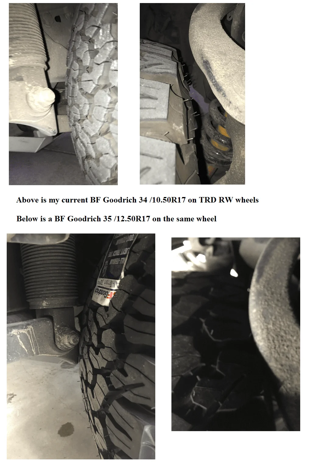

So the local 4wheel parts shop helped me out and test fitted a BFGoodrich All Terrain T/A KO2 35/12.50R17 on one of my wheels. And yeah it ain't gonna work without something changing. I had hoped I would be able to have them mounted up and daily drive until I figured out which way I wanted to go with the mods to accommodate the tires, but rubbing is too much for me.
I have a KDSS relo on the way, but I'm starting to rethink about the need for regearing, some of the folks not being happy about using the KDSS relocation, etc. So I'm stuck at this point. However, in the interests of helping provide some information, here's some shots of the BFGoodrich All Terrain T/A KO2 34 /10.50R17 versus the 35/12.50R17
Wheels are at full lock. Reminder this is with an OME medium duty lift.

That's exactly what I found too with that exact tire. Really wanted it to work out, but I am so glad I went down to a 285/75/17. It's the biggest tire you can safely run on these without going down the rabbit hole too far. 285/70/17 takes even less work, but I think the 285/75/17 is truly perfect on this truck.

Looks like you have stock UCAs? If so I doubt you'll be able to get enough clearance with 35s in the area around the mud flaps. I have 34s and I had to do a lot of massaging to keep them from rubbing when turning and driving >5-10mph back there. With 35s you're adding another 1/2" of sidewall height, so you will need to push the caster more positive to give you more clearance. Then once you add caster you need to watch out for KDSS bar rubbing on the DS and sway bar rubbing on the PS.
Having done 34s and dealt with the rubbing, I personally wouldn't go to 35s on a daily driver. They are doable but you're going to need to be very patient and willing to deal with the occasional scrub.
Yep, stock. Was hoping that the 35's would be OK as a daily driver until I could decide on either changing the UCA's , and the KDSS relo, or the Tundra arms. But with the folks mentioning the additional need for re-gearing etc (I had to re-gear a Rubicon LJ I was running 35's on so I experienced the improvement), I think I'm gonna keep my current 34 KO2's. They only have 7k miles on them and seem to work well. The biggest reason for attempting the switch was cosmetics. The awesome rigs here rocking35's had me wanting to try it out. I appreciate the advice though, it's confirming what I feel like is the way to go for my setup and use.
