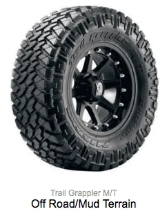

Maybe these:
I have those exact tires listed as option 3 in my table...

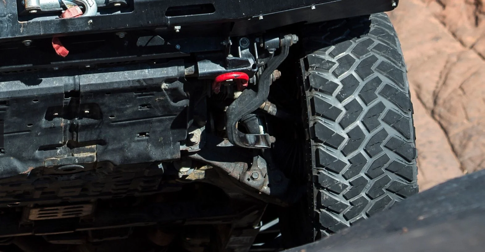

So if your 12.5" wide ko2s rub...how is @WillyBeamin fitting the Nitto Trails that are actually WIDER?
And what's different about your rig if anything...oe are KO2's somehow bulging in the wrong places?
He's also on RW wheels...
I'll jump in here real quick and then @Willy beamin can jump in an correct me if I'm wrong on some of this. Willy has been looking for a narrower tire and has also been looking at small wheel spacer options for the front of his rig to pull them out a bit(back in line with the rears) and also to help with the rubbing on the UCA and KDSS bar. All of us running 34's and 35's kiss that bar to an extent, just look at all of ours, they are scuffed and a bit rusted. It's a balancing act running bigger tires on these 200's, but the small rub here or there is usually totally worth it, IMO! This is also why I have been calling on someone to start making a reshaped KDSS bar for us, I think that would be a game changer!
Thanks Ken. I wondered if he was rubbing as I'm pretty sure Slee's LX with Nitto Trails rubs...not to mention that's on an LX with only AHC rather than a lift--though lifting doesn't help KDSS.

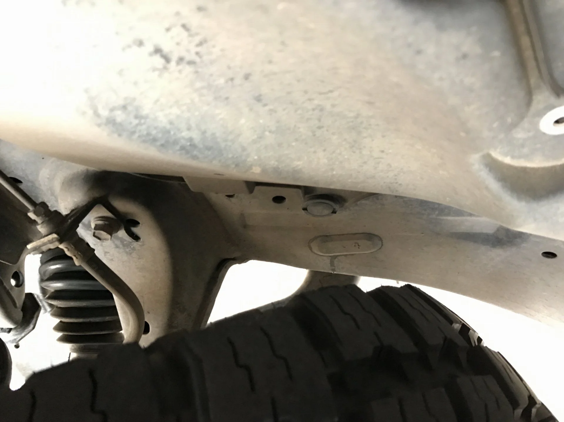

Any chance you could shoot a photo of where the KO2's were hitting? Maybe it will show up as a clean spot in there? Would also be helpful to know what spot on the tire hit worst.

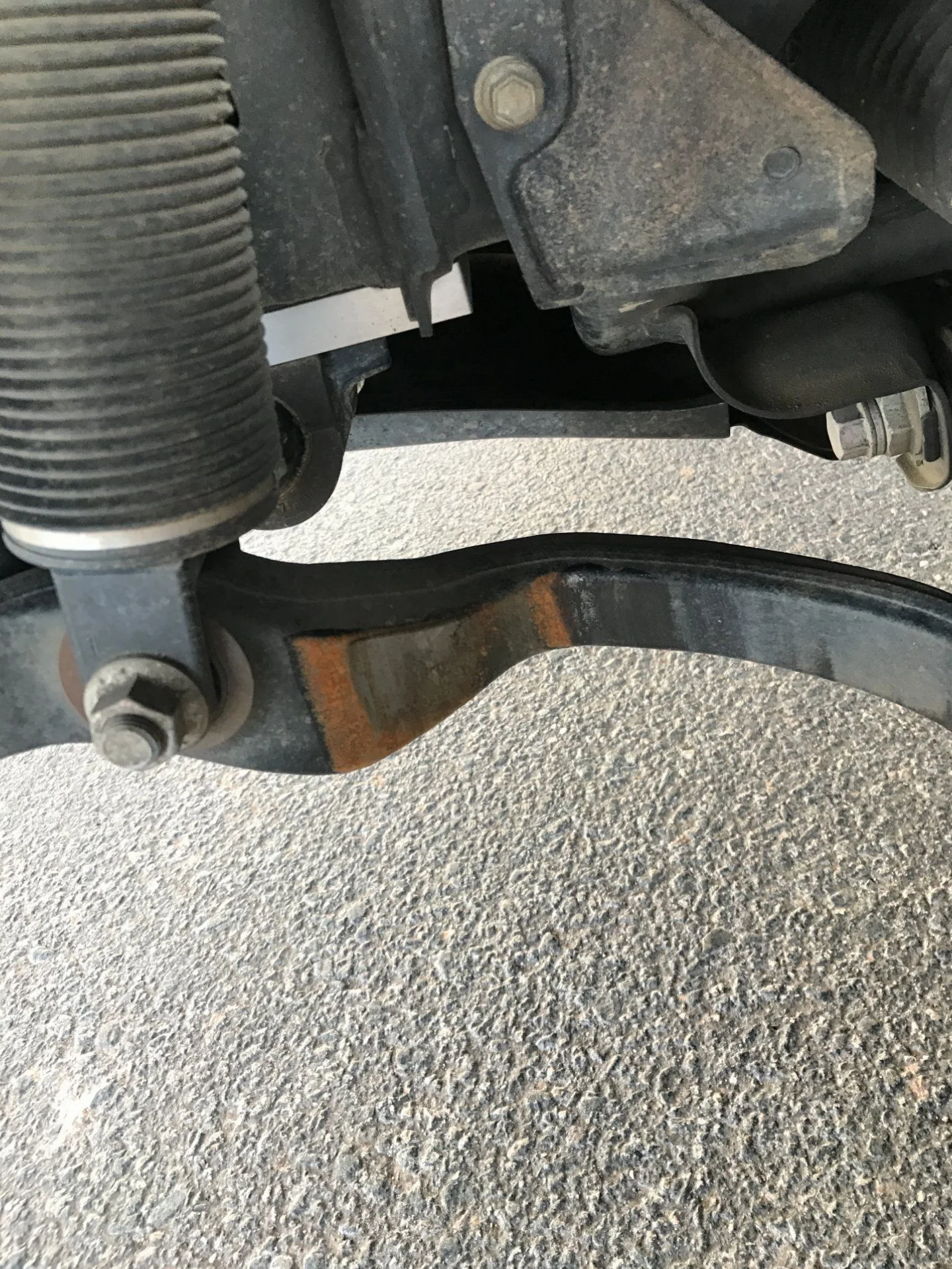

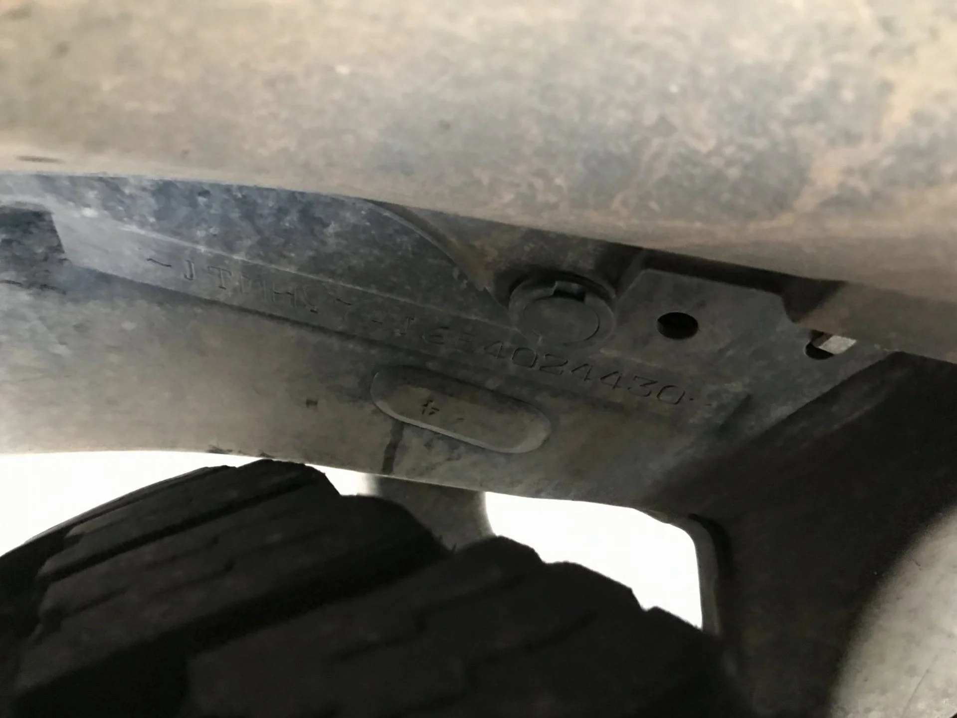

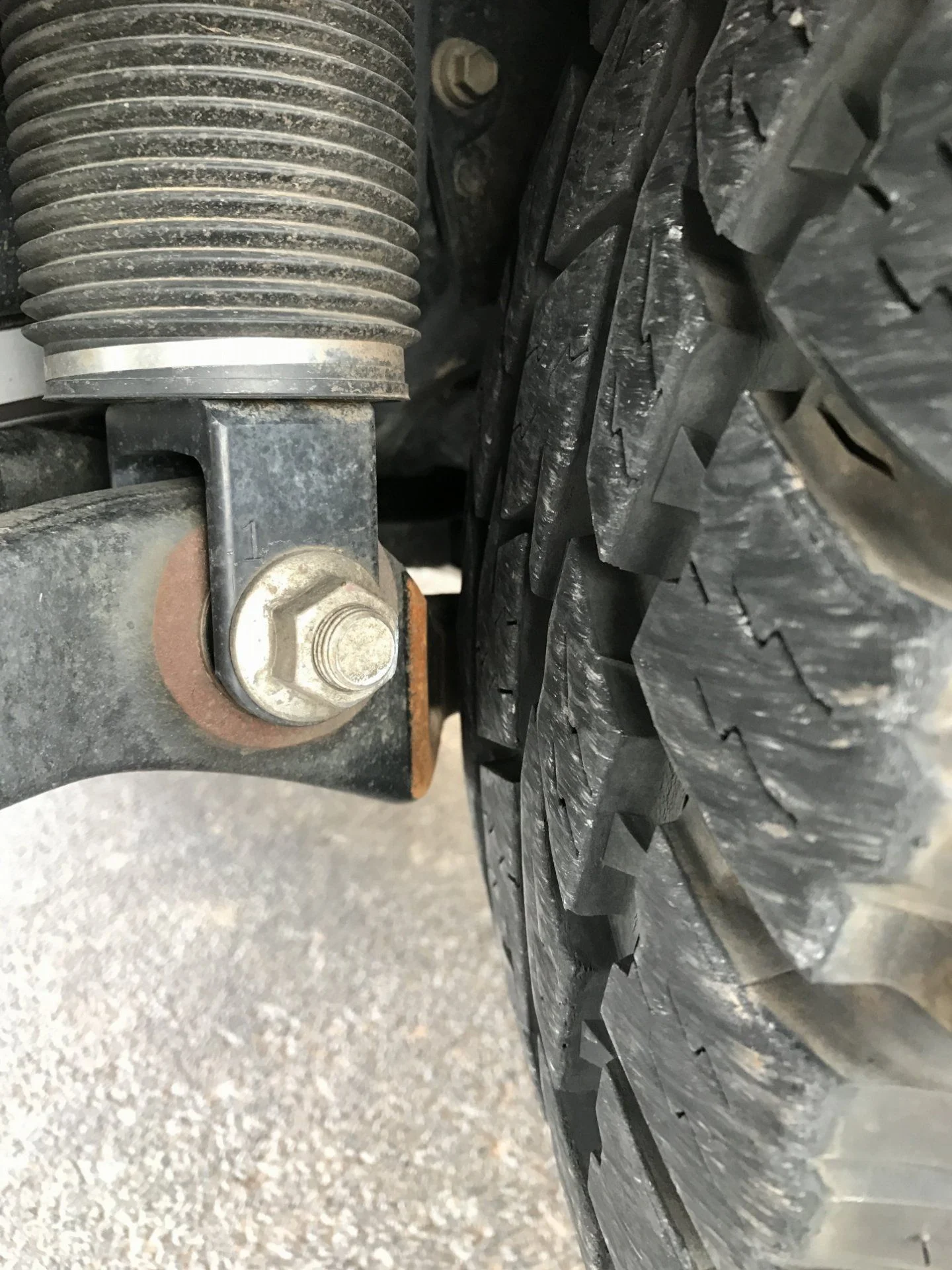

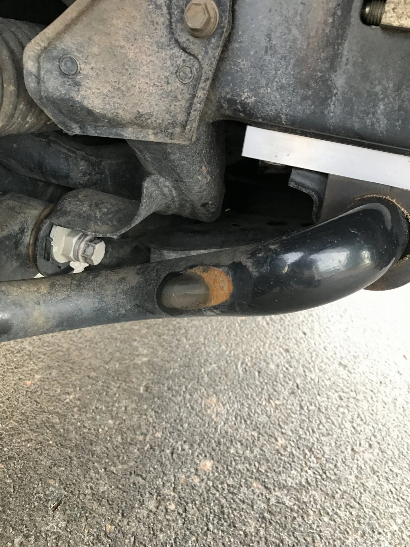

For all intents and purposes the KO2s are the same size as my AT2s, but the KO2s rubbed slightly less. Here are shots of both front wheels and where they rub the sway bars. They clear the frame ok, but I haven't been able to see what they're like fully flexed. It's actually a bit annoying since the tires would fit pretty well without the massive KDSS system there, but I wouldn't want to ditch it.
View attachment 1417284 View attachment 1417285 View attachment 1417286 View attachment 1417287 View attachment 1417288
Thank you. And ya...that must be frustrating indeed.
Removing the sway bar isn't bad if the wheels (knuckles with wheels off) are level with respect to one another.
Remove the linkages and there is no torque on the bar.
Then just use a floor jack to line everything up for installation.
Looking at the pictures, it seems like a shorter sway bar is needed. Not sure if it would clear the frame if it were shorter.
The seemingly simple solution is to widen the stance.

Not sue there's any room to stuff if wider... Looky Beamin's photos...
The Nitto trail grappler in the 35x12.5x17 measures 13.19" in width. A tire that wide works, you know it will rub at full lock, it will tuck and still turn - Moab and Ouray proved that two years in a row. Start your focus on 13.9" width tire on RW wheels and work your math down from there. The beauty about the Slee swaybar relocation bracket is that's its just one item added to the mix and it works. I'm excited to see what becomes of a KDSS bar redesign. The jury is still out on the Tundra conversion for me. I like to roll phat tires and tuck them like shirt tails
