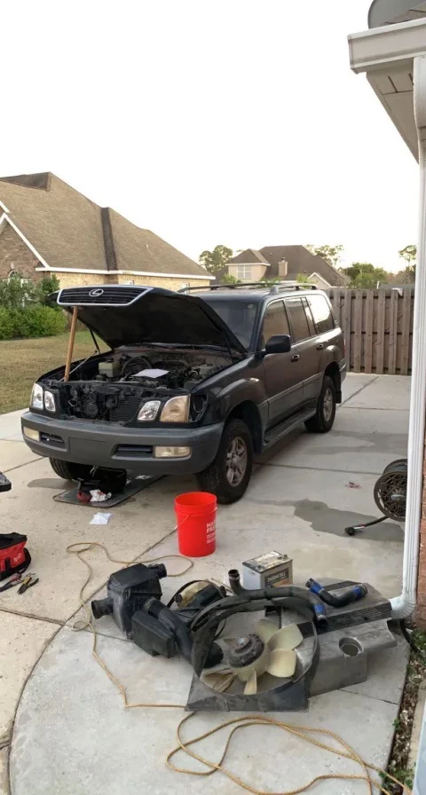

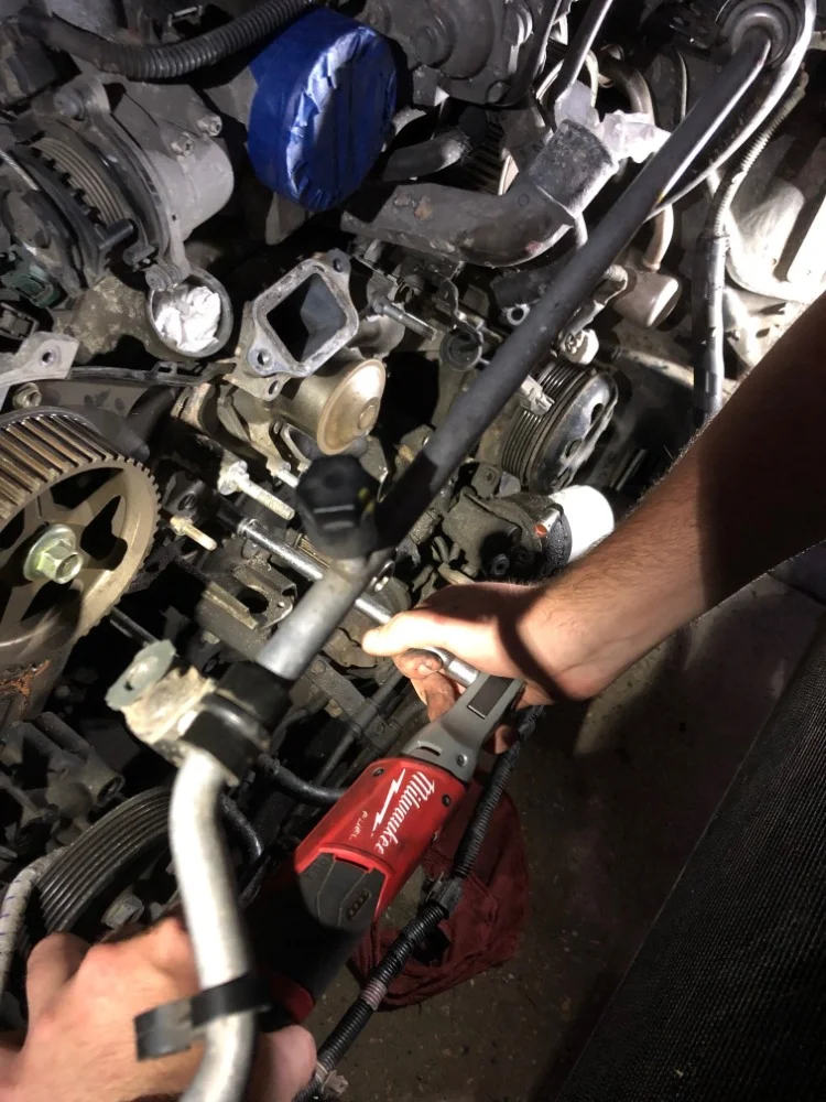

We get her home, timing covers off, and sure enough, she is 2 teeth out of time. "See, I knew it" we thought. So we ordered a Aisin timing belt kit, Aisin fan belt pulley bracket, side marker lights, valve cover gaskets (it has a mean passenger side valve cover gasket leak), a new mirror, and some other bits and bobs. Fun fact, some parts are Lexus specific and need to be ordered from parts.lexus.com, not parts.toyota.com. Like the parts don't exist in the Toyota parts database or something. At this point, the truck is officially in "Awaiting parts" status.
The parts start to roll in. Good thing that Springhill Toyota and Lexus of Mobile are right next to each other. We dig in. a bunch of stuff.

We got into a groove, and worked late into the dark. Which in December, is about 7 PM.
We get the timing belt in, assemble the puzzle pieces that are the front accessories and covers on a 2UZ-FE and start her up. She sounds better, but still not good. Sounds like she is missing. The racket is coming from the driver's side of the engine.

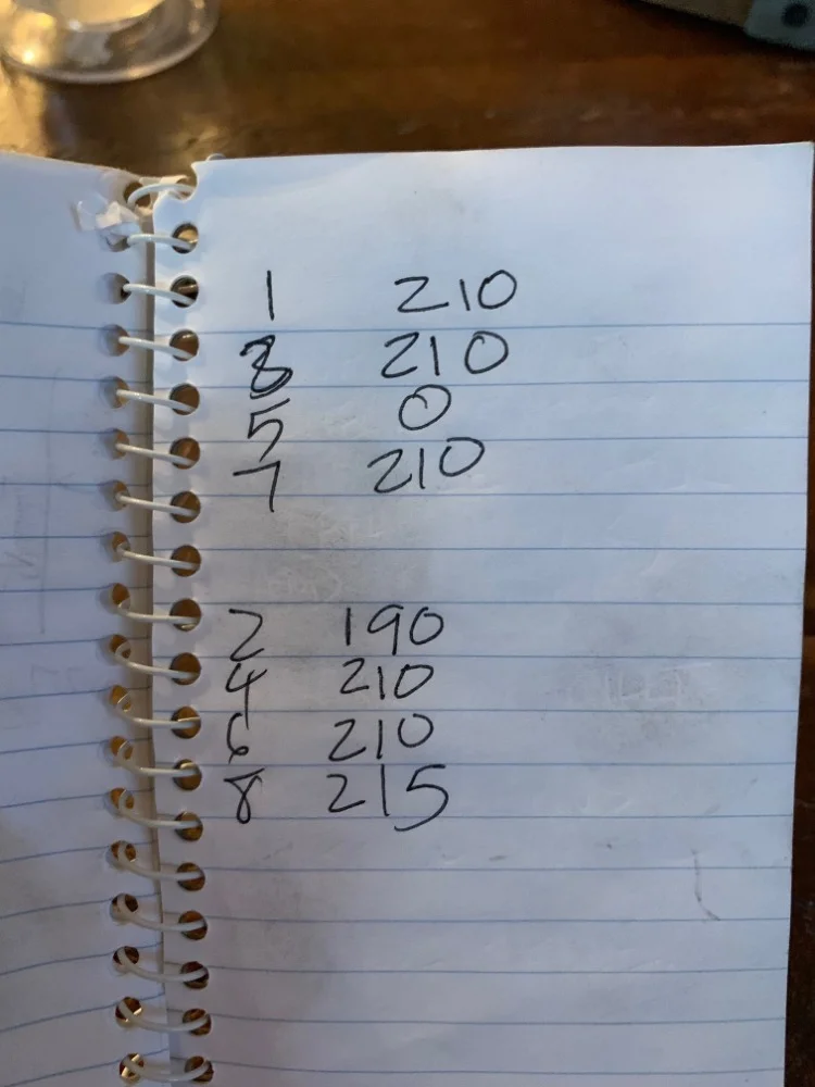

Doubt sets in. Hmmm. Let's do a compression check. According to the internet, max pressure is 192 psi, lowest acceptable is 142. Here are the readings:
Now is the time to say, "Lady, there's your problem..."

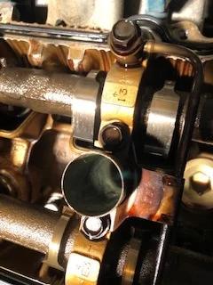

Obviously, some the cylinders are carbonized up driving the pressure up. And #5 is not being a team player. We are hoping for a stuck open valve. We pull the valve cover. nope. all four of #5's valves are doing their job.
So we stick a socket extension down the spark plug tube. And press down. The piston head moves down pretty easy. oof. Time for a new engine. Stay tuned folks, for 2UZ-FE swap #2.

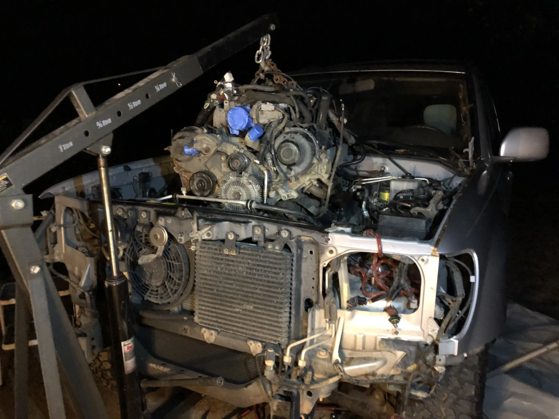

This happened today. Pulled a beautiful motor from a 2000 LC with 200k miles. We were able to hear it run and do a compression check before we pulled it. Compression came out perfect. Since it is from a LC, no need to change the manifolds, throttle body or harness.
We did have to put a starter in it first to get it to run, which was its own adventure.
Just to back up a bit:
We show up at the guys house and the truck is on a trailer. That wasn't discussed. They guy said we'd be able to start it by tapping the starter. No amount of tapping was going to get that thing to turn over. After some hemming and hawing, we decided to put a starter in it. The seller paid for the starter. :clap: He goes off to the auto parts store and we get to removing the intake manifold. 90 minutes later (right about when the rain starts coming down), the starter is in and the truck starts right up. Great oil pressure, sounds very smooth, compression is all above 200 psi and within 15 psi of each other. We have a winner. since it was raining, the guy let us use his carport to pull the engine. 6 hours later, the engine is out.
Turns out you actually do need to get ALL the bellhousing bolts out before you can separate the engine from the trans... @CarterB341

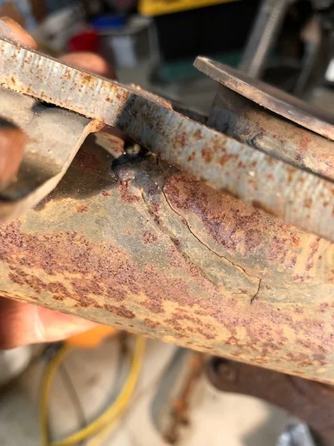

Great time to inspect manifolds for cracking or stress lines. From a guy who's manifolds just started ticking.
