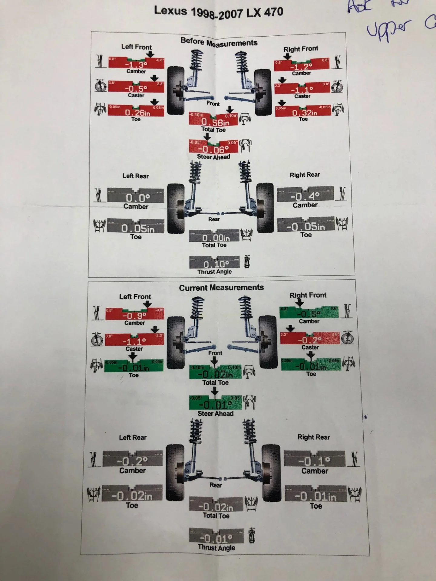

I just installed the 2" Ironman Nitro Gas Lift -Level 3 to my '98 LX 470 and I immediately took it to a shop for an alignment. They weren't able to correct the Caster. Did anyone else struggle to align their 100 series after the Ironman lift? The shop recommends I try purchasing upper control arms. Do you recommend control arms or have a better solution to this issue?
Assuming that your suspension bushings and joints are “good”.
One option is aftermarket control arms, that add a preset amount (typically ~3*) of caster (Nitro, Trail Tailor, Dobinsons, Total Chaos, etc), or are adjustable (SPC) and allow you to adjust camber & caster beyond the factory adjustment.
Another option would be to reduce the amount of preload on the torsion bars (read as less lift in the front).
Before you get too involved with correcting the alignment, I would verify that you still have a “reasonable” (50-75mm) amount of droop, otherwise it will still “suck”, even with the correct alignment.
👆🏽That’s your problem.
Your front is probably lifted too much. Reduce it down to 21 inches center of hub to fender.

I have no personal experience with the Freedom Off Road UCAs, I’ve only used Nitro, Trail Tailor, and SPC UCAs. I’ve had relatively positive experiences with all three, but have my own personal preferences. In the thread that I linked above, I questioned whether the price was “too good to be true”, and wasn’t real excited about what I remember as a proprietary ball joint from the manufacturer (upstream from Freedom Off-road). There are probably people on ‘mud that have tried them by now.
Do you really want to base your purchase decision, purely on price, for one of the things that keeps your front wheel vertical, while you’re going 75mph down the freeway/highway?
If you’re really looking for the “economical” solution, without spending/wasting money, check your droop before you order the UCAs. You may have a “free” solution that just requires turning a 30mm socket (hint, hint)
Do you really want to base your purchase decision, purely on price, for one of the things that keeps your front wheel vertical, while your going 75mph down the freeway/highway?
Definitely like the sound of that! Thank you

^^^ This. My front lift is 20.9". Just a hair under 21" I don't think anybody can tell the difference. It sure rides nice with a 3" rear lift.
