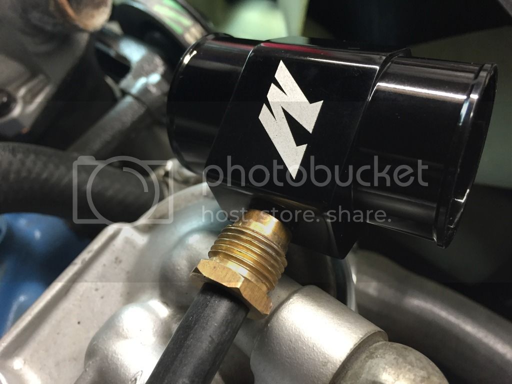

Next job. Wasn't really keen on how the water temp gauge would go above 3/4 on the gauge when climbing long hills and egt's staying 900F-1050F. So, finally got my mechanical water temp gauge installed to know exactly what kind of temps are indicated by the factory gauge.
Had to tap the aluminum adapter to a 14mm 1.0.

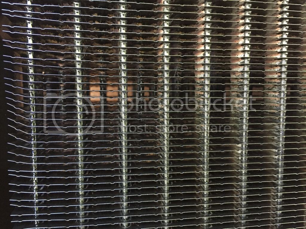

Then I dropped off the radiator at a local shop. Says part of the top was blocked.
so he put in a new core that he claims is a stronger design and better cooling.

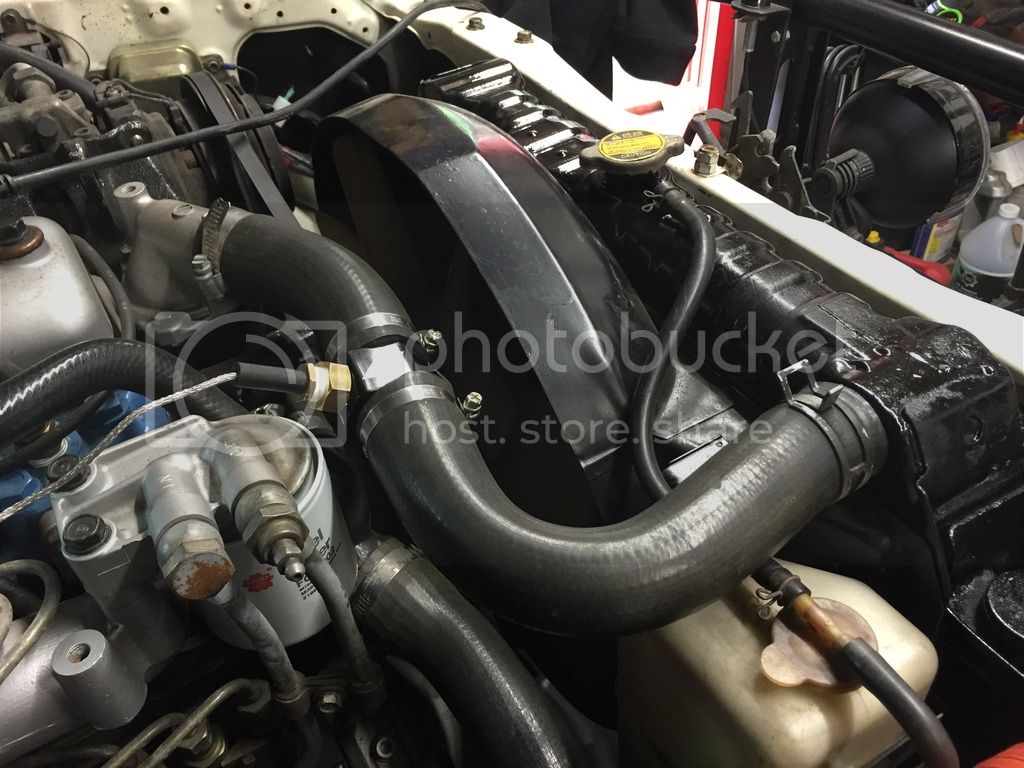

Here she is ready to go in.
finished installed.

Great to see you're looking after a lovely pick-up. Don't you love the good feeling from making improvements? The new rad must give you great peace of mind, too. And thank you for posting the parts numbers and manufacturers - i'm taking notes.
I have another thread I think in the diesel section about my high water temps at above 65mph, even with the new rad, flushed/cleaned 3 times bigger opening thermostat, a air scoop to direct air to the lower 4in of the rad that is blocked. All to no avail? Want to get Evans waterless coolant but hazmat shipping to AK is really high, almost as much as the coolant and cleaner itself.
