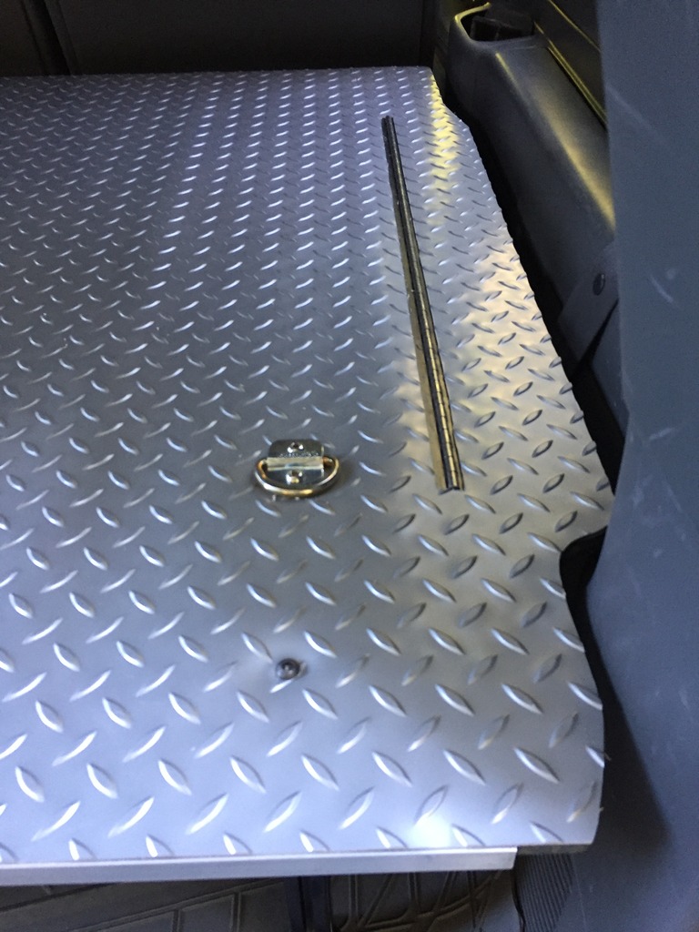

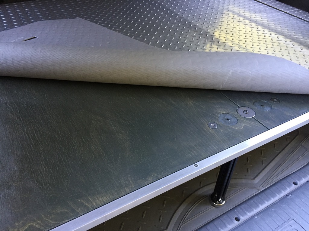

Well, I am almost done with the SS1 shelving system. Initially I wanted to get a drawer system but ultimately decided in favor of the SS!. So far I am pretty happy. It's light, easy to remove and allows me to store longer items out of sight. I bought the kit and it was pretty straight forward to assemble. Finished it with a grey stain and a coat of Polyurethane as I was not sure if I was going to use anything else. I ended up getting a rubber mat from Amazon. I will still have to glue it down and install the hardware over it.
Now I am looking for a few boxes for a nice custom fit.
