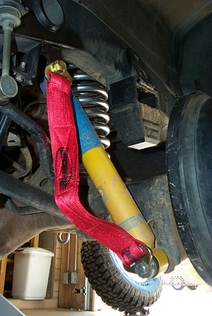

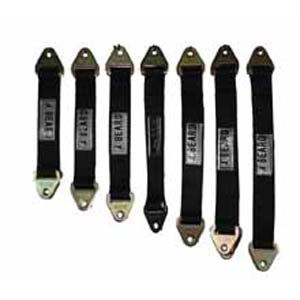

what you are talking about is called limit straps. search is your friend.

and yeaa ... limiting strap is a must on almost every airspring if you not using the dampers as limiter and that is a bad idea
15" travel :bounce:
limiting straps?

something like ..
