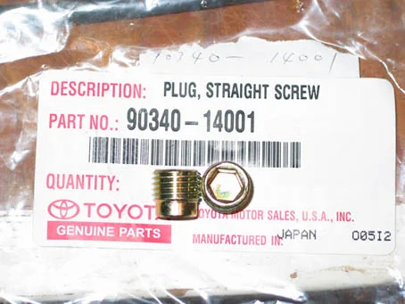

I've never used or seen the OEM plugs in any head. Most have the brass 1/4" NPT brass plug with the allen head. I take it the OEM ones are steel. I have also seen the threaded inserts from the OEM air rail welded up and if done right it looks pretty clean and seals nicely.

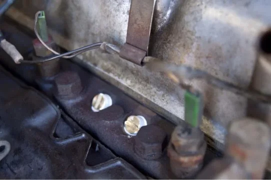

I cut my stock air rail adapters and welded them up and ground them flat. Took 15 min and was free.
You realize that you welded the wrong end of the injection ports shut???
The shoulder is needed if you do not use a tapered thread plug.
attachment.php
And the hex makes it so the plug can't go down into the hole and hit the bottom to seal.
That's why it needs to be an allen.
<cue sad trombone>
I had hex brass plugs lying around, so I ground all the hex head off & put a slot in the top so I could use a screwdriver to thread them in, it was free. You can do that with yours if you want to save it. You will probably never get them back out, but you will probably never be reinstalling an air rail.
I couldn't no go out like that. Here is my V2.0 air rail plugs. I had some Allen head bolts on the shelf and they slid right in. I let them stick out a little bit then welded up the gap. Then ground them down. Redemption!....... Still funny tho
