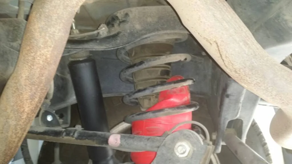

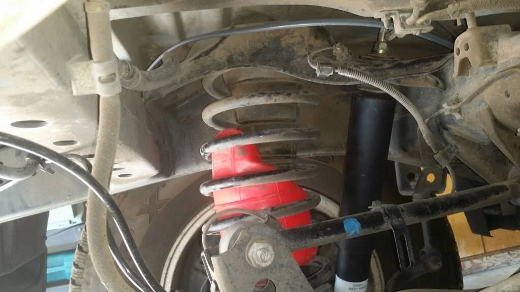

Mine will hold at 5 psi but I finally got around to checking the installers work. Check this garbage out. Page 4 of installation guide says remove bumps stops. Before I run the installer into the ground by naming them I am giving them a chance to correct their evil ways. Pure unadulterated incompetence here
:eek::eek::eek::eek::eek:
yea, but does it say remove REAR bump stops? ;)
Just kidding. That's pretty bad...:bang:
I had to leave town for various work trips right after the install and finally got around to checking it out
As long as they keep air while using them it's no big deal to keep them uninflated
It could be a big deal because you no longer have bump stops....

My Airlift 1000 instructions said to "remove" the bump stops. Didn't say anything about cutting them....
You are correct per the AirLift instructions. I was going off memory, and the Firestone Coil Rite bags say to keep the top section of the bump stop in. When I ordered my first set of bags from etrailer, I ordered the firestone bags, and they came in a FS box, but had the red airlift bags in the box. Not sure that the soft bumper inside is actually going to keep you from bottoming out though.
There are other bump stops on the frame above the axle. I'll probably never flex the rear axle enough to hit those stops. That kind of spring flex is performed by the 40 and 60 series I have. I'm just trying to keep the ass end from sagging with my 400 lb tounge weight on travel trailer
Ok, they fixed them and have them installed properly so I am somewhat satisfied. However when I dropped the truck off I explained to the store manager the problem about the first store claiming they threw the bump stops away when I asked about them and then found them still mounted to the truck. Today I go pick it up and the second store really did throw them away. Well I keep all my stuff and told him I wanted them back but they were gone. So he is getting me new ones from Toyota in case I want to go back stock. All it would have taken was some communication from the service writer to the shop and this mess would have been prevented. What a cluster fxxx.
