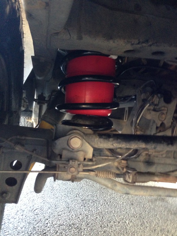

I installed a set of these (Air Lift bags) over the weekend - about a 2-3 hour job overall including teardown and putting everything back on (tires, spare, etc.).
I'm running OME Heavy Duty 866 springs in the rear - they are approximately:
5 1/2” inside diameter
9 1/4” top to bottom inside
I contacted Air Lift directly and, after giving him (Jeff at Air Lift) those measurements, he recommended #60733. They went right into the inside of the coil spring without any issue once I had the coil removed to remove the cone bumpstop.
I did not drill-out the hole at the bottom of the perch (on the axle). Like spressomon, I used 1/4" ID rubber fuel hose as a protector for the air line, perfect fit in that hole. The air line was a bit of a tight fit inside the rubber hose, so I cut 3" lengths and used a bit of grease on the outside of the air line, then fed it thru those small sections of hose. I put about 5 sections of the hose together starting at the bottom hole, then just used electrical tape to hold them together and then again where the last hose ended to the air line to avoid slippage.
We'll see how they hold up. Drove around about 10-12 miles is all so far, I'll report back any issues.

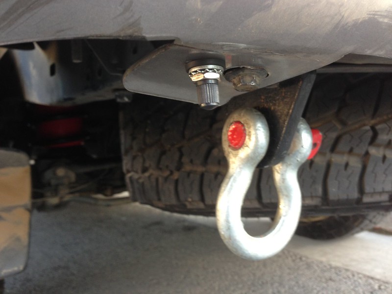

I installed an air lift because it was cheaper than getting the Slee Heavies. My truck is getting heavy, but without a rear bumper, it's right between needing 860s or Slee heavies. On trips, it gets heavier. So air bags it is for now. It's weird lifting your truck an inch with a bike pump (my compressors air chuck just broke).
I used a 3/8in ID black vinyl tube to protect all the 1/4" air lines. I routed them to follow the ABS sensor wires along the rear UCAs, then along the gastank filler neck. I may need to relocate the Schrader valve to somewhere more protected. There was just already a hole where I located it.
I used the T fitting to link the left and right bag. My theory was that it'd work as a self leveling/sway bar like system this way.

Response to everyone considering setup. As far as placement of the valve, I too used the small hole in the bumper but I am going to run it inside as the Schrader valve is rusting. Open to better suggestions.
