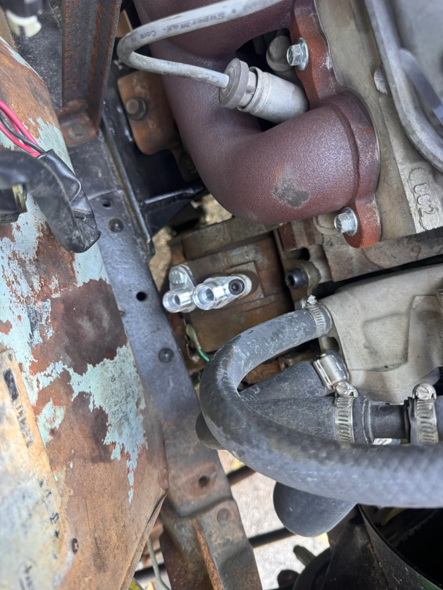

I chose the under dash with no compressor, hooked to my LS compressor.
I’m $400 into mine currently. I expect to be sub $500 with cold air blowing.
