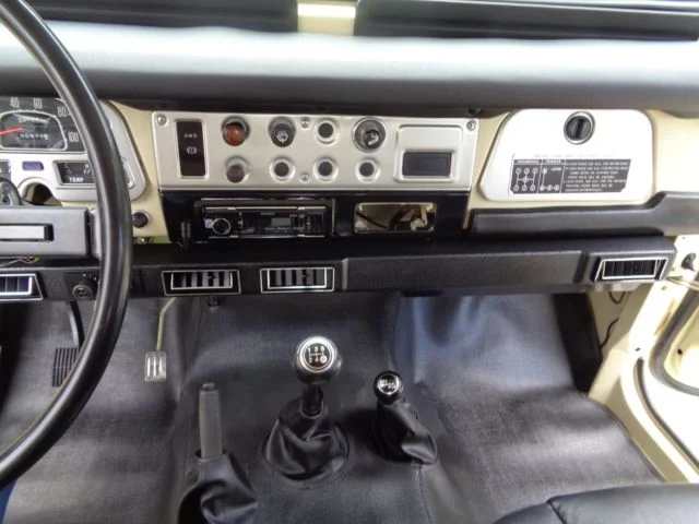

X2 on the Old Air Product underdash units. They look very similar to the original Nippondenso units. I installed the CAP-200B model which has the black face. I also opted to have the factory delete the front panel controls and instead installed them remotely in the dash for a cleaner look and easier access to the controls from the driver's seat. Cools well even in Florida heat.

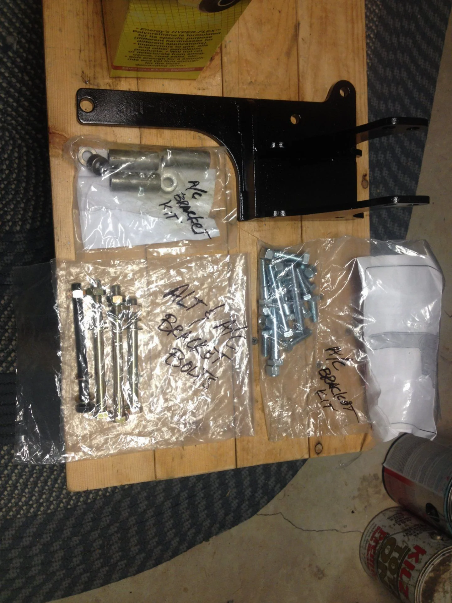

Use the a/c compressor bracket from Vintage Air. It relocates the alternator below the A/C compressor for a very clean and stable install:
Bracket Kit (158217)
Kit includes Part Numbers:
158216 Bracket Assembly, Compressor/OEM Alternator
158212 Bracket, Compressor Adjustment
191131 Hardware Kit
If you have any questions let me know.

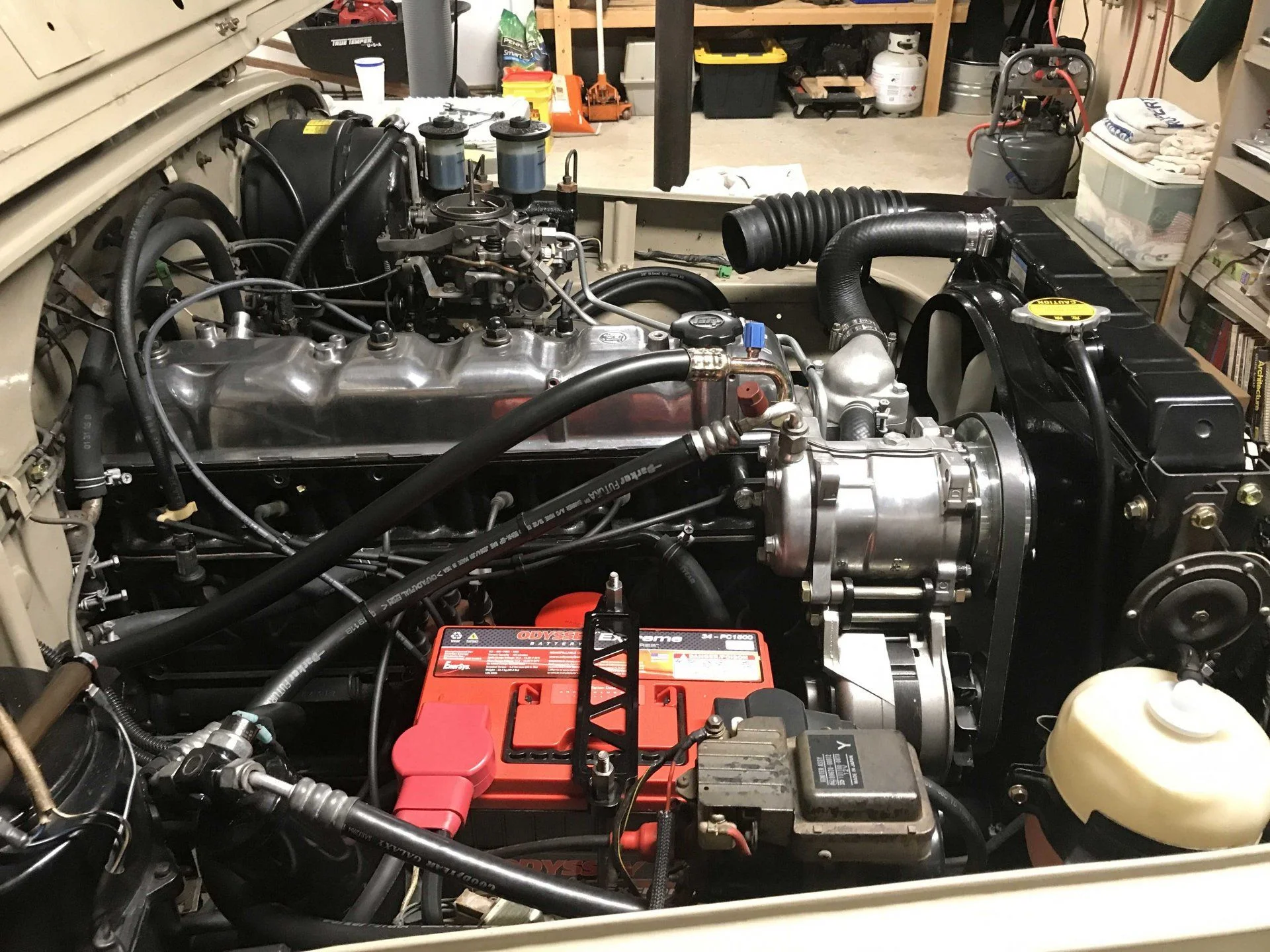

The Vintage Air #15465-VTB bracket/kit is what I used at the time. However, I sourced the longer M10 AC & ALT connecting bolts from McMaster-Carr.

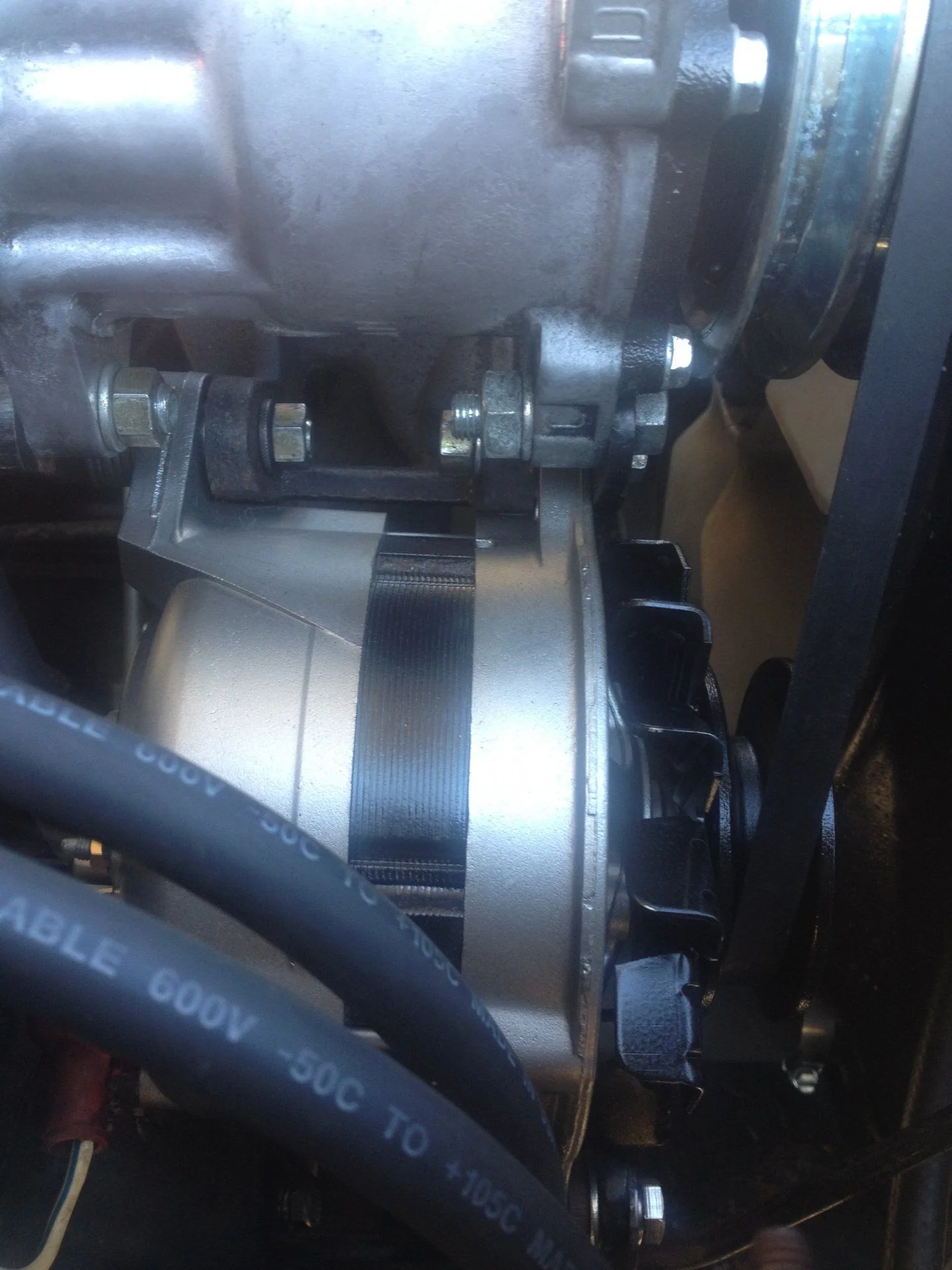

I went from the below, CCOT's AC & ALT multi brackets that didn't align the pulleys very well. It looked as though it was cobbled together.
To this, Vintage Air's AC & ALT single bracket that does align the pulleys well. Looks more professionally done.
So if I am following this correctly....the Vintage Air AC & ALT single bracket is used to mount the AC compressor and the ALT and will mount onto an F2? Rick can you attach a photo of your PS mounting location. Is it in the factory tapped holes?

Could you attach a photo of your ALT/AC Compressor alignment

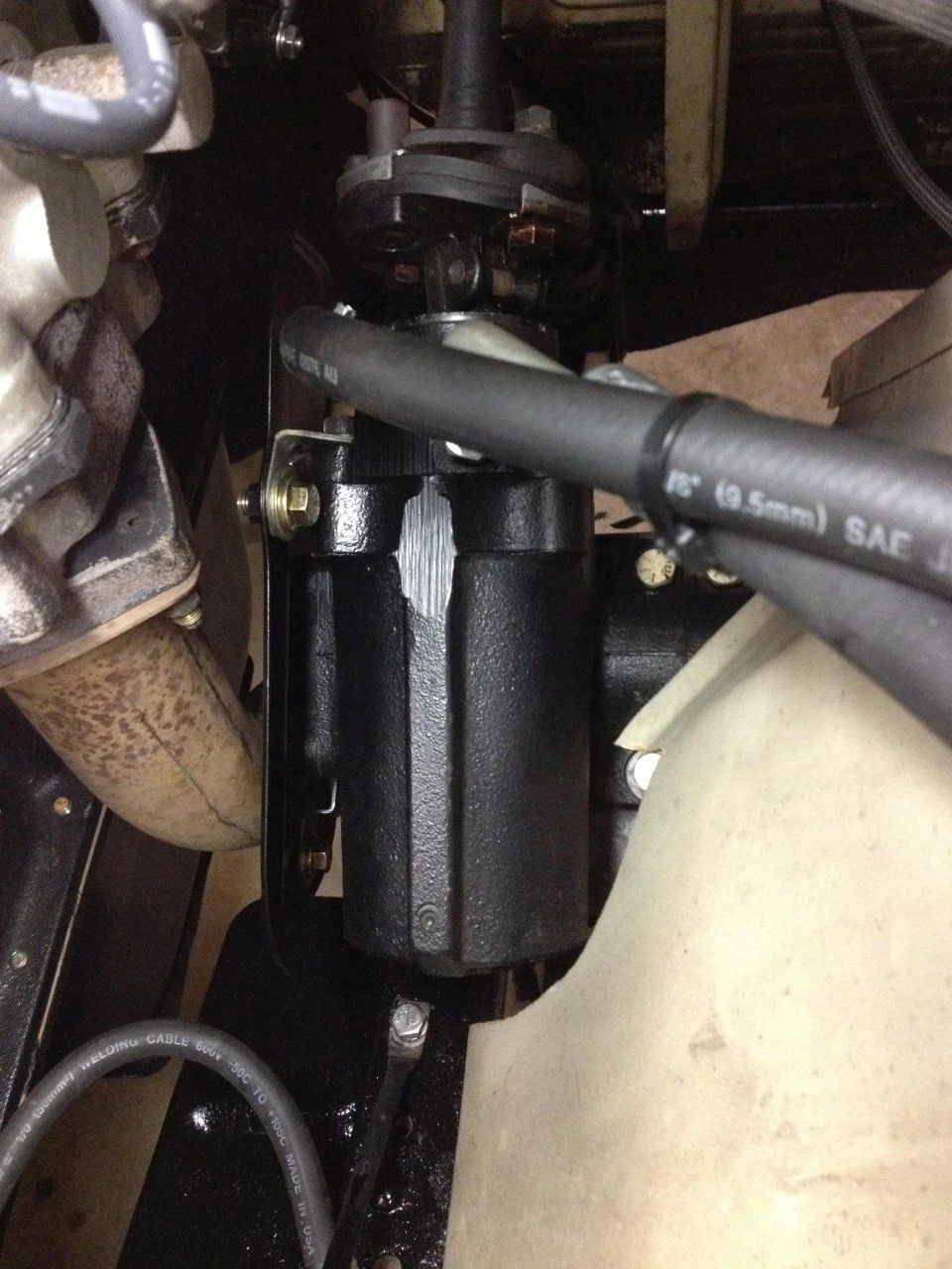

I have the mini truck PS unit that sits on an after market bracket where the OEM steering box sat.

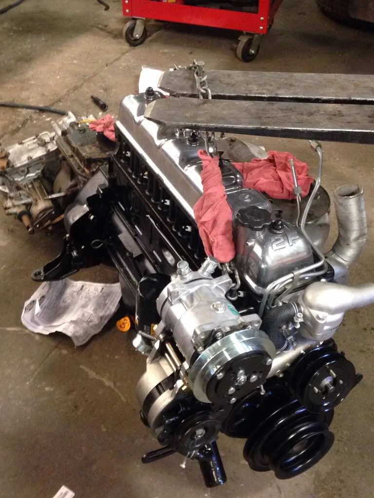

The PS pump is installed on the bottom of the engine.
