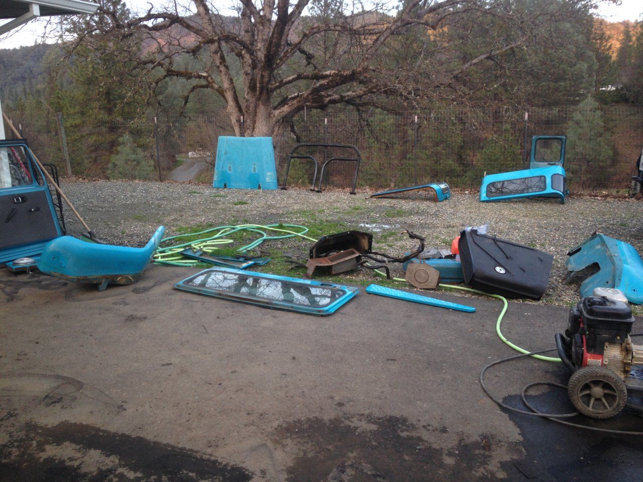

um, not so much... I have taken out many, many burnt up cooling parts and have also done the 120K service of belts and water pump and air conditioning clutch. Next is to remove the heater coil and see if there is a dead beaver or dead opossum stuck up inside.
Today we found the belt was new but sloppy and we are doing that tonight.
Am I stupid? Sure! No one can take that title from me, But I have so much metal that I need to cut corners and do this week end warrior.
Plus can you recommend a good toyoya guy in 96001? no so easy unless you like Lithia Toyota and I dont.
When I asked for a used 2008 "FJ200 Land cruiser" they had me drive 2 down to look at a stupid "FJ" I told them its sacrilege words and drove away.
What im doing is a major refreshing of my FJ80 that I have had for over 20 years.
sorry to many Cruisers and to many beers to do spell check
