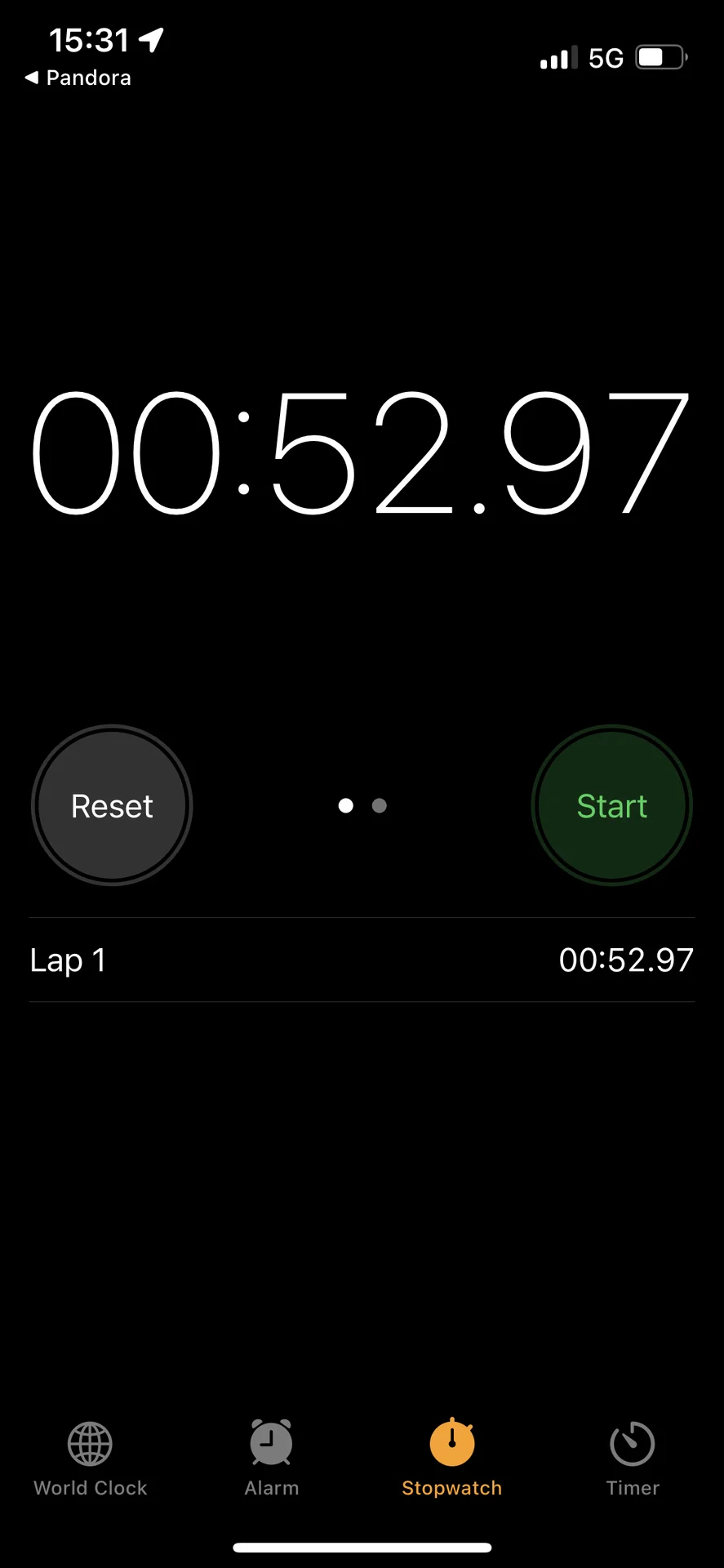

After the bleed the fluid level was spot on in N so I ran some tests. Here's the time from LO to HI. Without me in the seat, from the time I shut the door until the light stopped flashing.

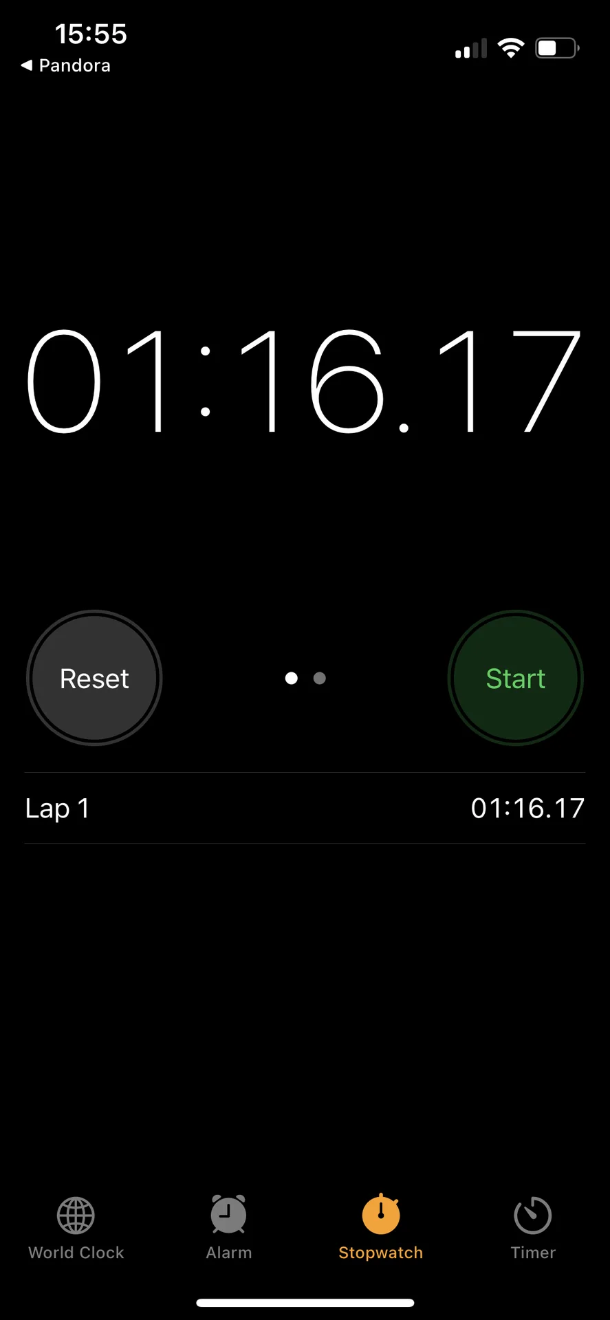

That seemed like way too long to me. I still had extra fluid so I decided to bleed it again. More air came out, especially from the accumulator. Ran the test again.
What the hell. I still have more fluid left in the can so might as well give it a third bleed. After the third bleed I was out of fresh fluid but the level was right on the MAX mark at N height on the reservoir. I ran the test again, forgot to screenshot it but it was around 56 seconds. So I tried it from LO to N.
That seems reasonable, I think? I tried it from N to HI and once again forgot the screenshot but it was at 24 seconds. That seems odd, 19+24= 43 but it takes a lot longer to go straight from LO to HI. So I ran the LO to HI test again for giggles.

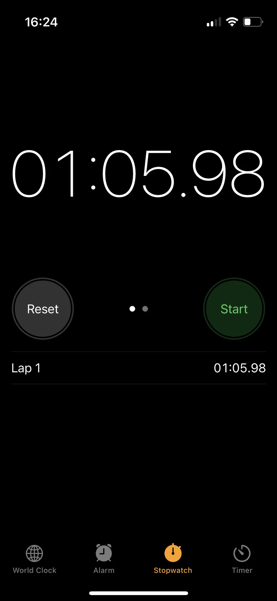

Did a time test again. 18 seconds from LO to N, 24 seconds from N to HI and 51 seconds from LO to HI. Better. I'd like to bleed out each corner at least one more time to be confident that I've got all the air out but I'll need some more fluid first. In HI the fluid is really low in the reservoir so I'd prefer some more insurance anyway.

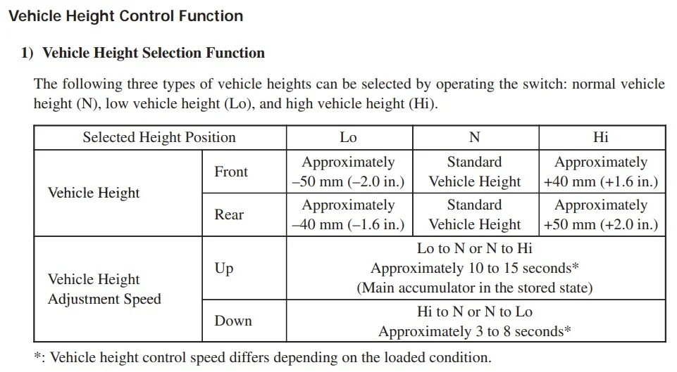

FSM suggests the following numbers for raise times and height differences.
Your raise times look reasonable.
AHC Raise times will vary with
  1. air in the system – your repetitive bleeding appears to be eliminating air, persistence pays, AHC Pump spends less time compressing air (or nitrogen),
  2. nitrogen in the system, leaking through slowly failing membranes in old ‘globes’ -- your fluid displacement “HI” to “LO” with 14+ graduations mentioned suggests overall healthy ‘globes’ IF the test is done with AHC pressures within the FSM-specified ranges,
  3. high vehicle mass compared to ex-factory stock condition with no persons, no build or accessories, no load, fuel full,
  4. adverse condition of the AHC Pump -- age and wear and also more particularly the condition of the internal strainers inside the Pump and also the Strainer inside the Return Valve. (The Intake Strainer rather than the Bypass Strainer or the Return Valve Strainer are the more usual problem),
  5. faulty Height Control Accumulator -- the ONLY purpose and function of this Accumulator is to speed up “LO” to “N” and “N” to “HI” raise, otherwise it does nothing during vehicle operation,
  6. increasingly common AHC harness problems – especially the BI1 connector high up toward the back inside the LHS Rear quarter panel (same for LHD and RHD vehicles) -- see alerts published on this forum by @suprarx7nut and @2001LC -- also see my Post #9 with pics in this thread which also leads to other Posts with pics: https://forum.ih8mud.com/threads/ahc-done.1299423/#post-14719487
Suggest stay with Toyota/Lexus AHC Fluid in 2.5 litre cans -- Part Number 08886-01805 -- unless all doubts have been overcome with quality (gel issues) in US supply of AHC Fluid in 1 litre plastic bottles -- Part Number 08886-81221.
AHC Fluid which has passed through the system inevitably will have picked up some aeration and debris. New fluid is best if possible -- but becomes expensive when doing multiple bleeds. If re-using AHC Fluid, suggest let it stand as long as possible (overnight?) to allow air, nitrogen to dissipate to atmosphere and visual cleanliness can be inspected.
In my own case of longstanding very slow and incomplete raise “LO” to “N” during testing (improves after driving), all other causes have been addressed, so I am suspecting harness issues. The only problem is that I live in Brisbane in Eastern Australia but the vehicle lives with my son-in-law in Perth Western Australia -- the test write-up I did for him is attached. We will get back to it one day!!
Meanwhile, all and any advice or suggestions are welcome.
