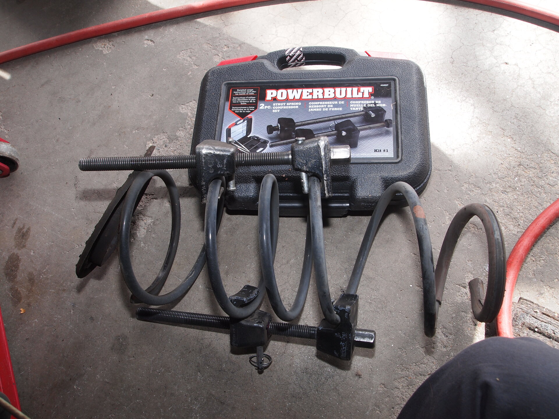

After cutting out the OEM shocks, then removing the stock springs I can't now get the replacement springs to fit. I have removed the rear drop links, disconnected the rear sway bar but still can't get enough room to install the new rear springs. I am going stock 105 rear springs with no lift, they new springs are exactly the same height as the old ones but I still need about 5 or so inches more drop to be able to get the new springs in place. The brake line is at the limit of extension. I have even tried the evil spring compressors but they won't compress enough. I've done the 'jack up the other side' technique but no better.

If you still don't have enough room. Use locking strut spring compressor.

I doubt you'll need strut locking spring compressors. But use if you do.
I have those too but hate using them - maybe i will compress half an inch or so if needed - cheers

just an update for anyone interested - I used a bottle jack to force down the axle on the side I was having trouble with plus used spring compressors to shorten the spring about an inch. Worked fine - many thanks
