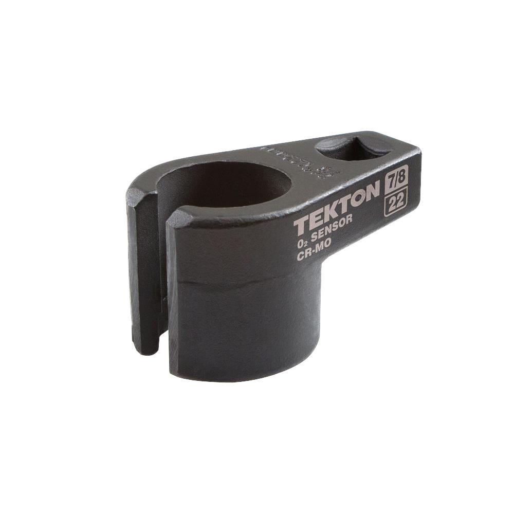

I struggled with removing the accumulator and globes. Impossible to get a wrench on that top bolt, especially with the globes in place, and no 36mm wrench.
First one I was somehow able to get a grip on the head with some pliers, but that didn't work on the rest. Next one I ended up bending out the accumulator with a cold chisel and big old hammer to reveal the top tab, then hit it with a sawzall.
Last ones, after removing the accessible bolts, I used a floor jack and scrap 2x4, and applied force straight up on the accumulator from below and snapped that silly tab off.
