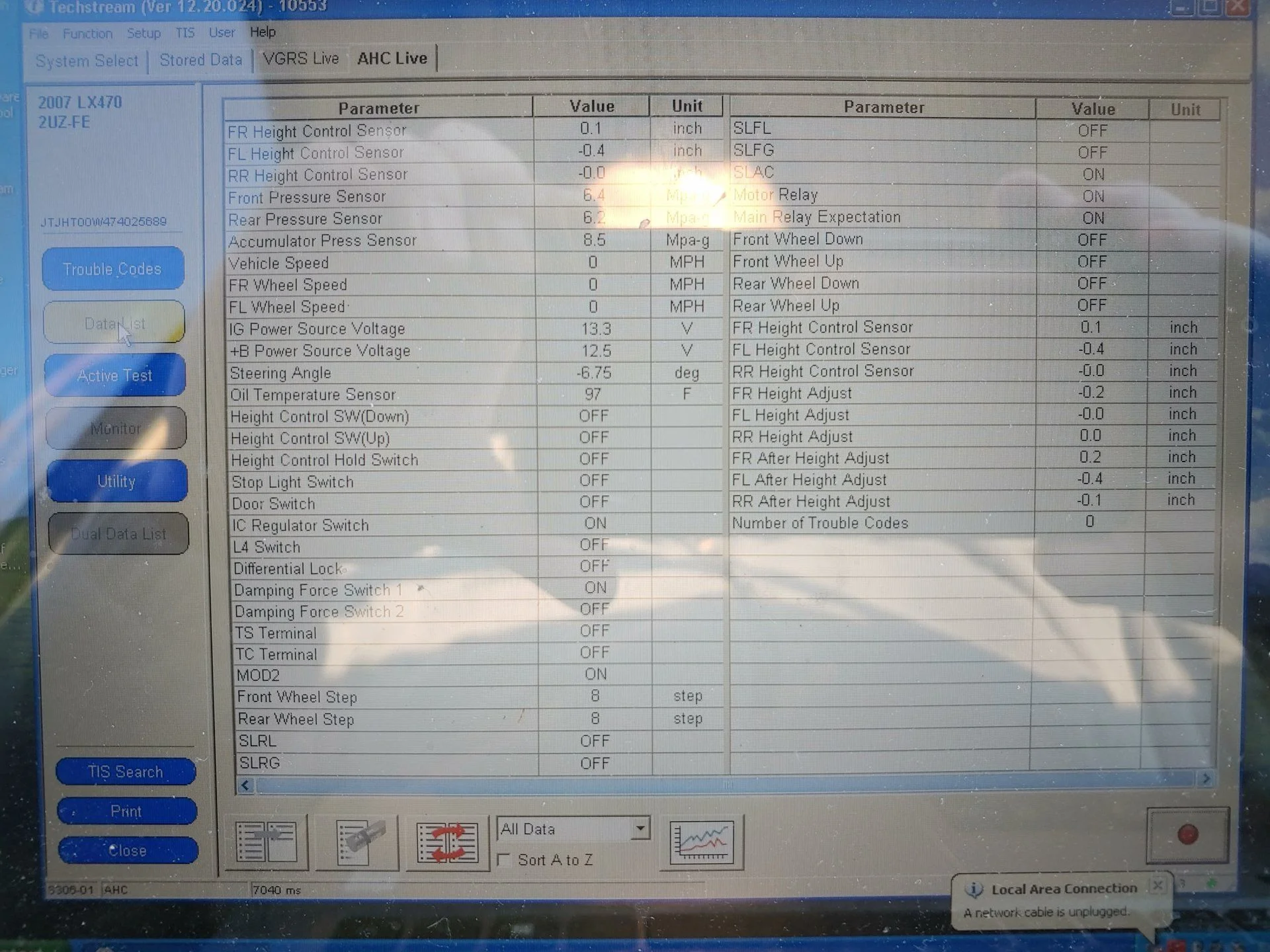

I'm thinking of capturing some more data at some point and if those accumulator pressures remain in the 8s I'll probably blead some more. Also the more I blead the darker my fresh light red suspension fluid got so I might also swap that out for good measure. Also made me wonder if as I recycled the fluid if I was dissolving gunk somewhere and it was getting broken up and suspended in my fluid causing it to darken.

Now that you can get from L to H, a graduation test is a good idea to get a general health snapshot of your globes.
Remember to read the pressures after a low to neutral cycle and wait for the data to update after the pump stops running. The tb's can be backed off to bring the front pressure back to 6.9. you get .2Mpa increase for each full counterclockwise turn that might help along with some more careful bleeding. Did you bleed the accumulator on the last round of manual bleeding?

Collected more data when I got to work. Accumulator running high 8s and taking 1-2 min to go from l to h. I can live with this but I'd like to get ahead of this if possible. I think I still have some air in there. I'm going to do some more bleeding with new fluid and bring t bars back down and see where I get. Won't be able to get to it till late Saturday at the earliest. Not quite level where it is sitting.

I did, will not be thinking teardown until I bleed a little more, get some fresh fluid, and get some more data. I'm a few weeks from having significant time for a teardown. Will have a little time Saturday evening for more bleeding. I think there was air and gunk in there. Driving it after tricking it into n seems to have dislodged a clog so that the accumulator could be blead. Then subsequent fluid bleeding and air bleeding helped to get the air out.
I like your bleed some more plan. Normal-ish front/rear pressures and low accumulator pressure combined with slow height changes would suggest air in the accumulator still. You could even just repeatedly bleed the accumulator and refill the system to see what you get.
