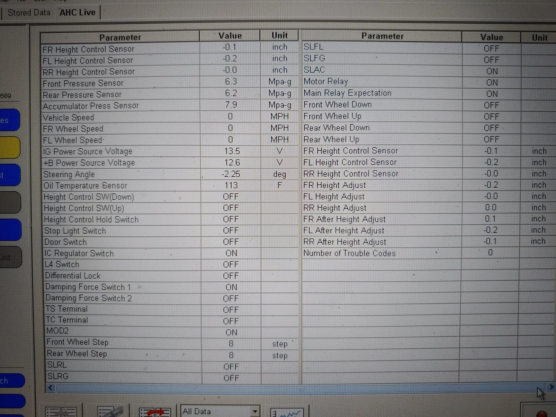

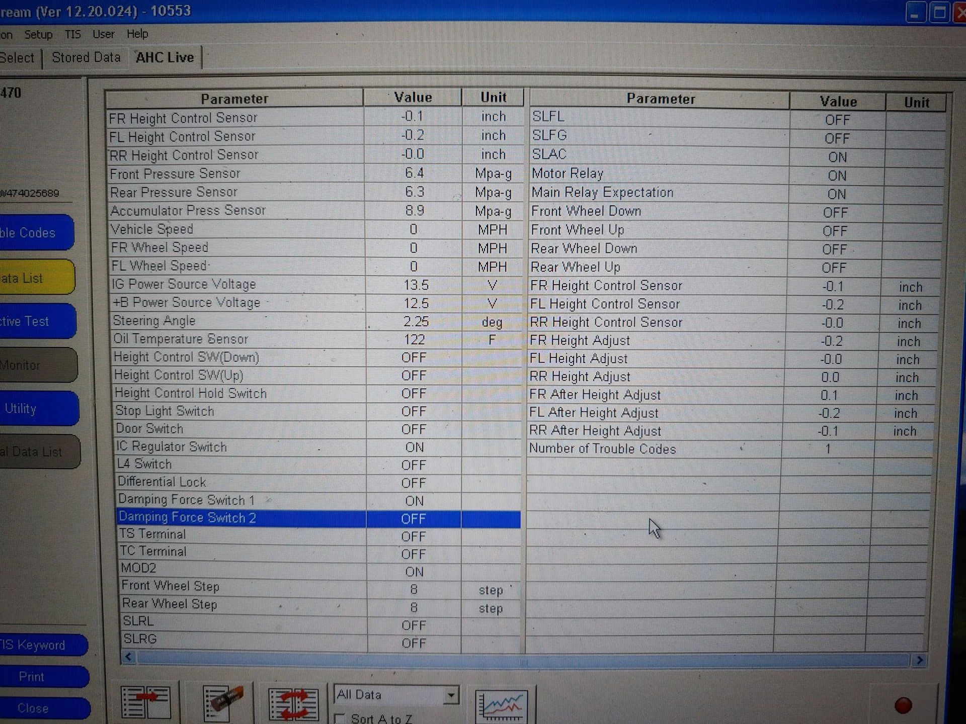

ok were probably heating the pump pretty good anyway with the "utility" bleeds go for it but i would leave out the accumulator from the manual bleed processI'm thinking I do one bleed to the bump stops as @ramangain suggests and then I have to call it a night here now in n

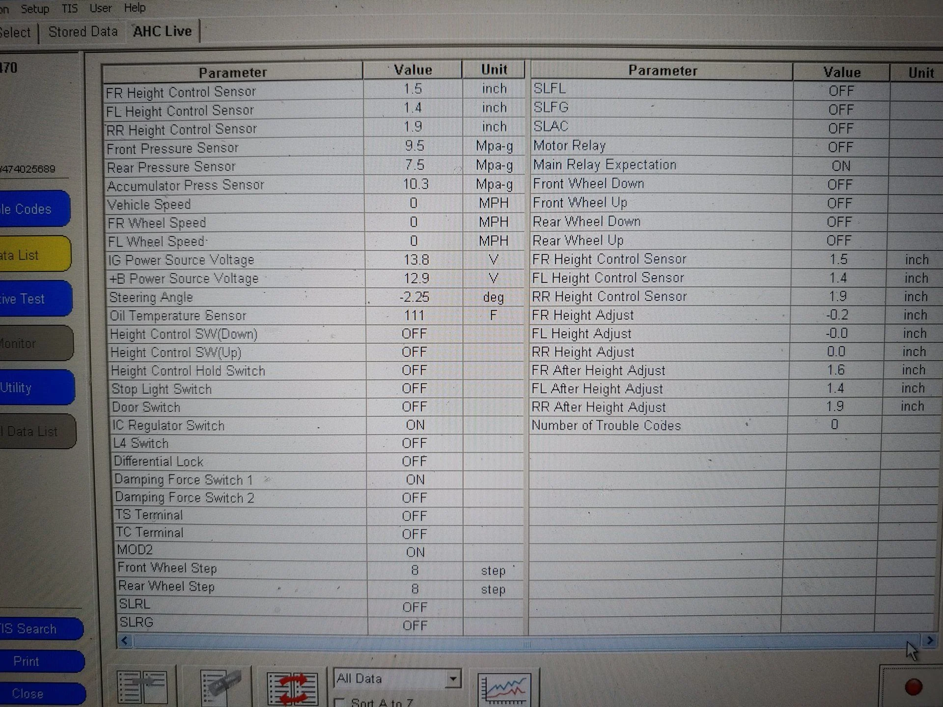

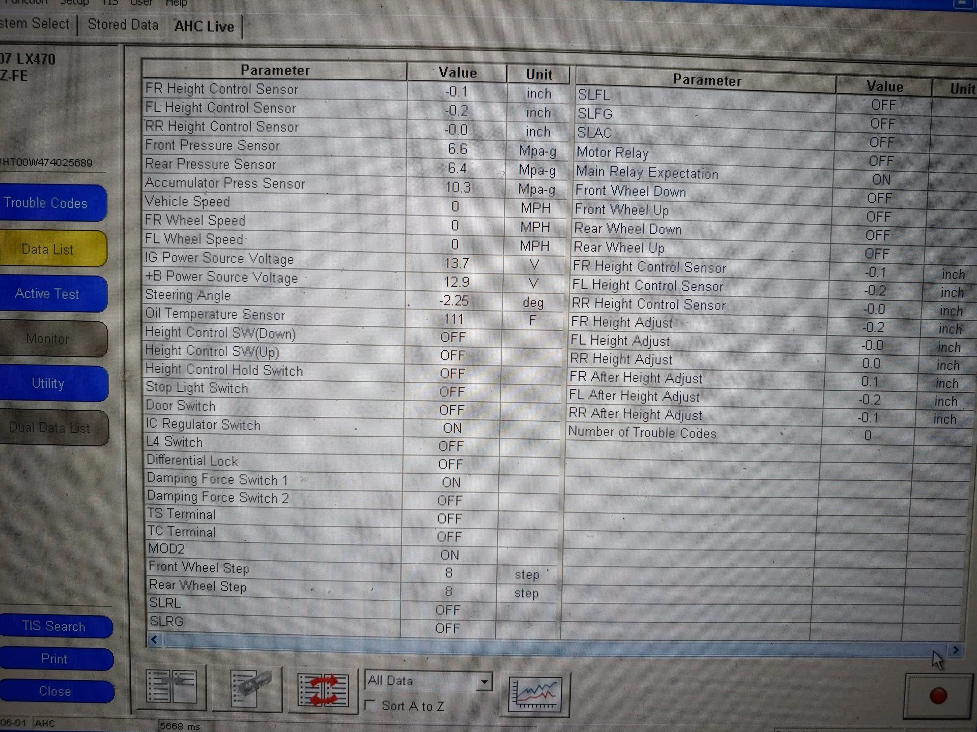

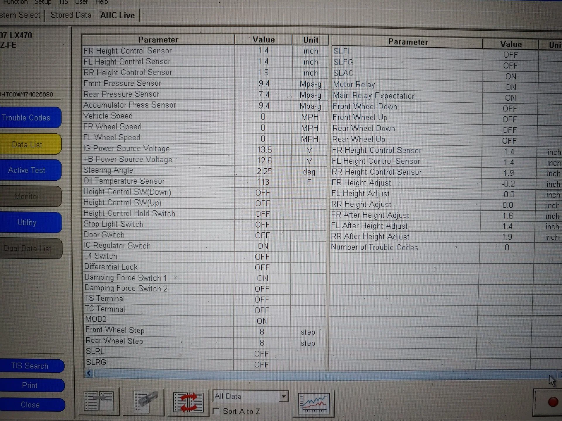

That is an outstanding result!Ok back to n, had to clear the codes and let it pump a bit before I got to n, took 2 tries
