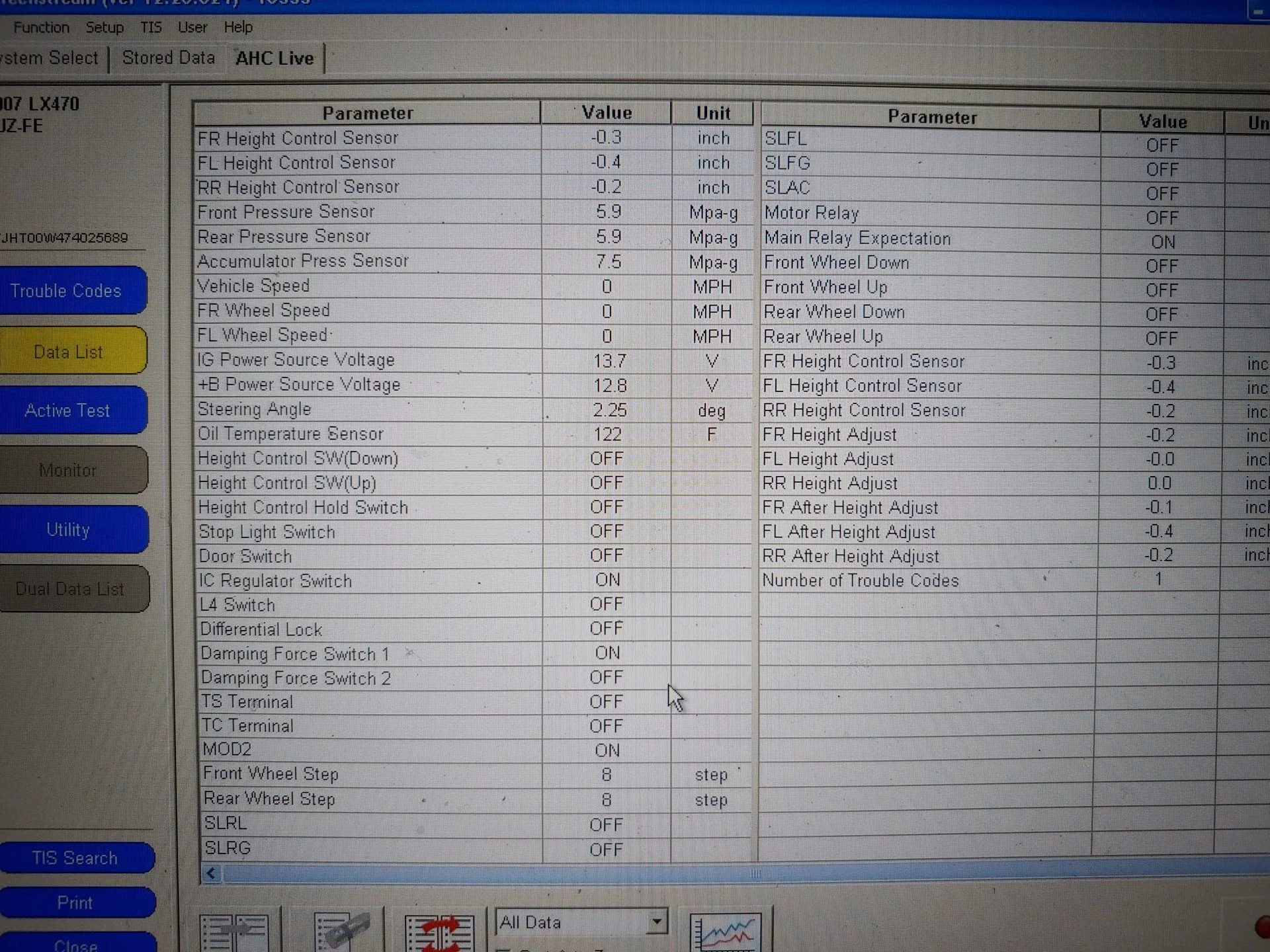

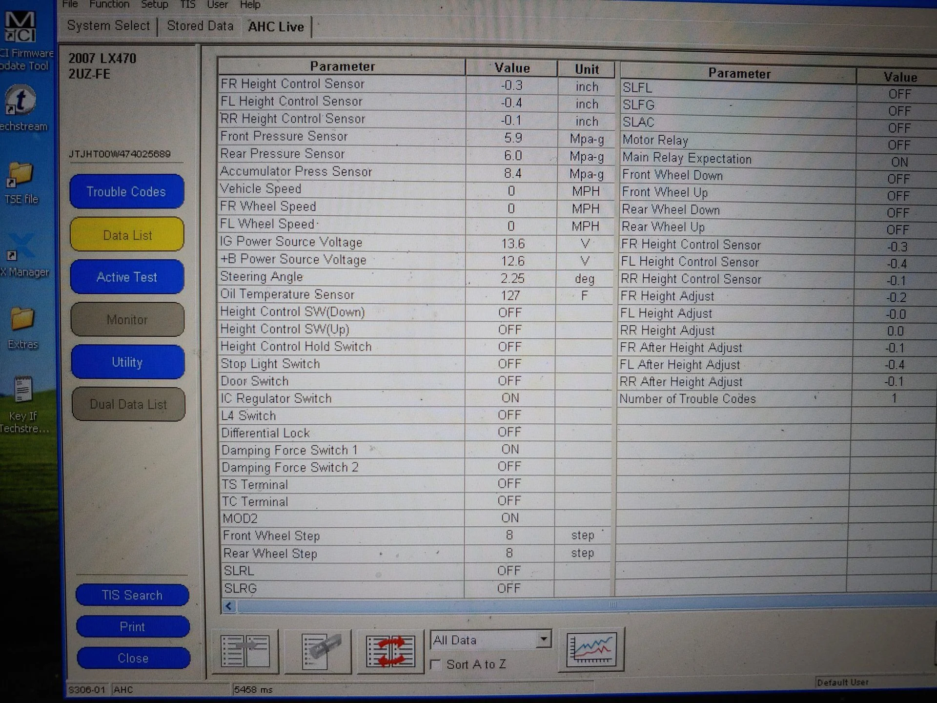

Ok wasn't following you about the "utility" bleed. Now I understand. I blead another time till it was bubble free. Now I just tried the force bleed/utility bleed procedure twice. Both times it started pumping before I hit the up button and would run for more than 60 seconds after
now data is

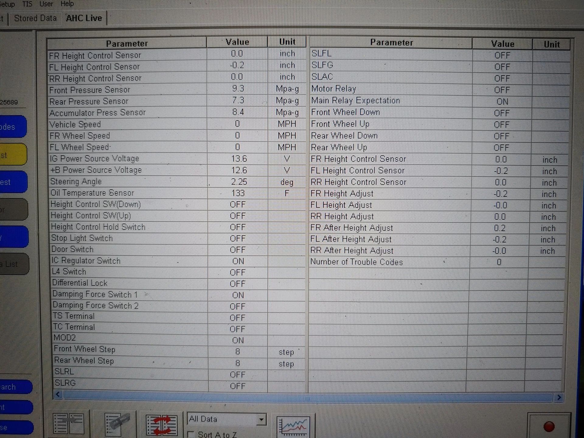

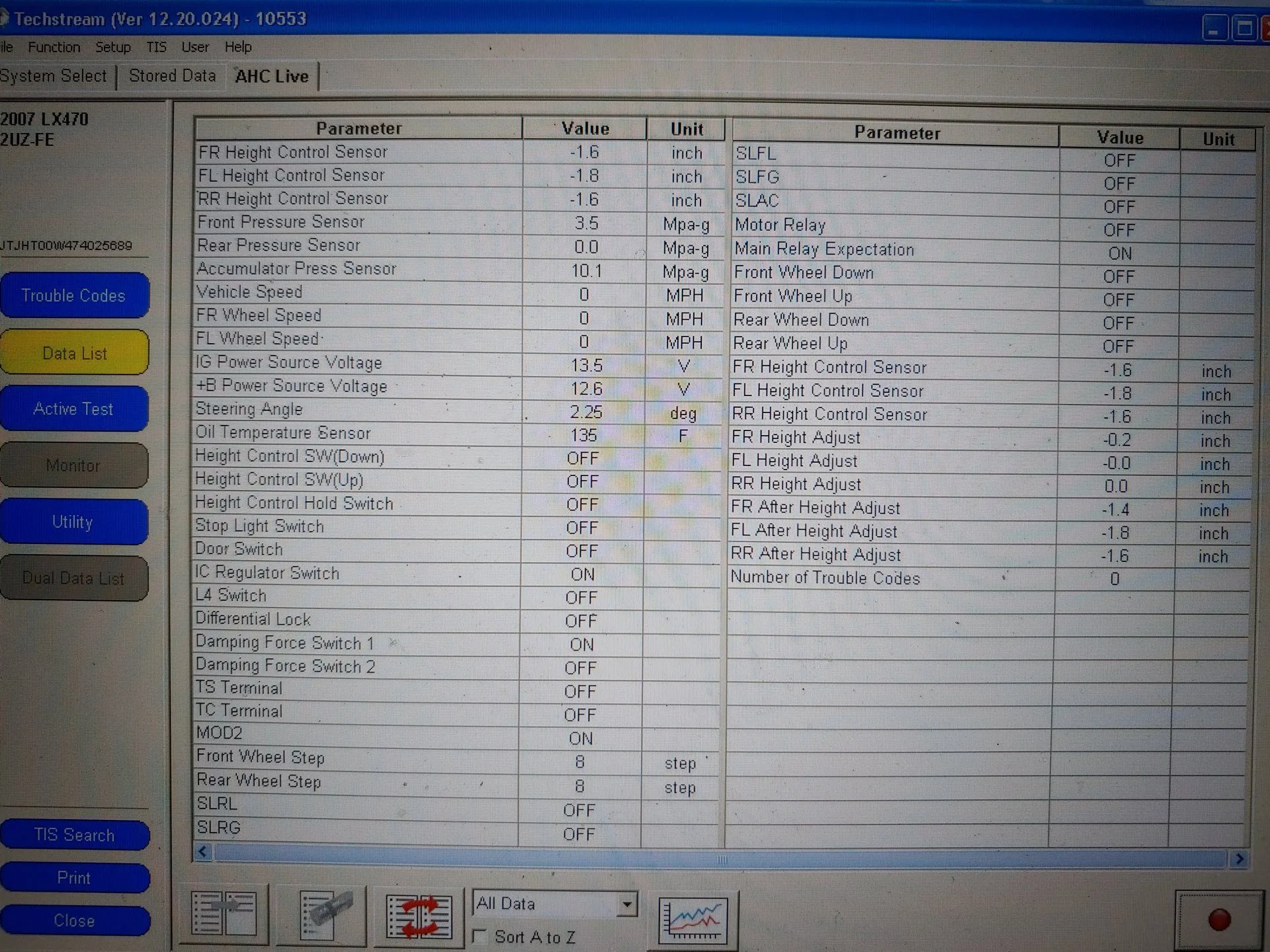

No no. Don't bleed again, yet.
Adjust your tbars to get front pressure sensor to 6.9
Get that thing smack to spec
yea so that "utility" bleed instruction was if it fails from L to N using the utility function in techstream which it passed laboredly. @aharlan001 if you remember where the TB's were return them otherwise leave them be for now.
