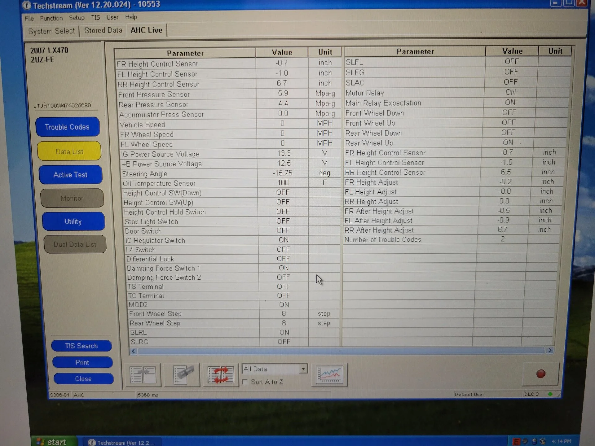

Techstream data photo is sitting on a relatively level place with rear on bumpstops. Strangely after moving the vehicle from this spot to the driveway the rear end came up to it's normal height.

Height sensors are original as far as I know. I just tested the rear sensor and it is giving me values to spec. 4.07 at one extreme (4.05 is spec for HI) 0.29 at the other extreme (0.45 is spec for LO) and 2.29 in the middle (2.25 is spec for N). I guess I can test the fronts too while I'm at it although I don't think I'll be able to get to it today. Based on the techstream readings this shouldn't be the problem though. If that is off the table I'll turn to c1718 next which according to the DTC code chart it is a fault in:
1. Pressure Sensor Circuit
2. Fluid Pressure Sensor Circuit or
3. Suspension Control ECU
Perhaps c1718 is causing c1713? Or maybe it's somehow one of the front sensors causing the rear sensor code and that is causing c1718? Seems unlikely since both front sensor readings in techstream are reasonable. The only problem that causes both codes is the Suspension Control ECU...

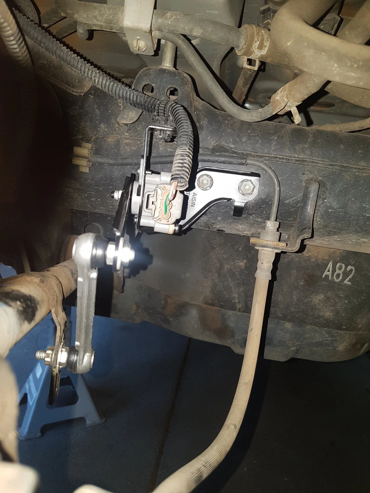

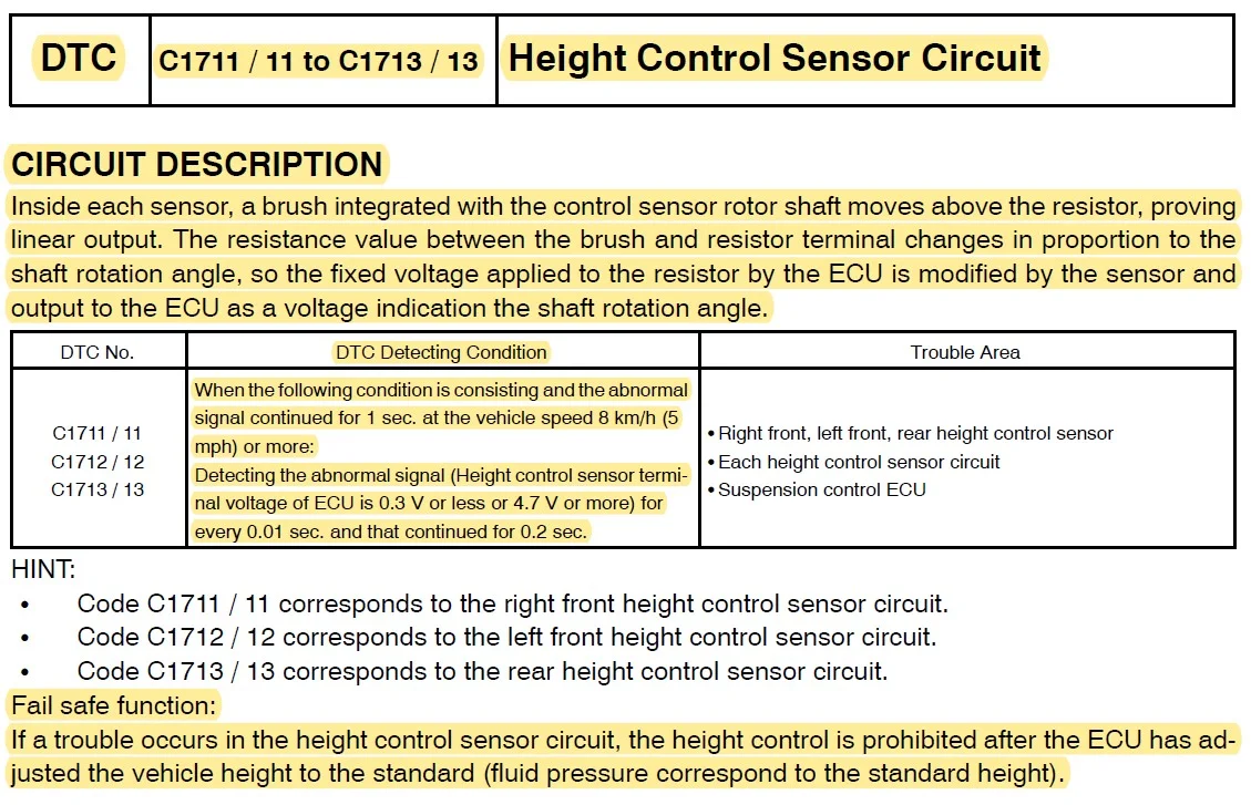

Intermittent C1713 combined with erratic rear height behaviour as described means a definite problem in the Rear Height Control Sensor circuit, meaning any of:
  • the Height Control Sensor, or,
  • the connector, or,
  • the harness.
The fact that removal and re-installation fixed the problem, at least for now, suggests an erratic contact and possibly intermittent open circuit or intermittent short circuit somewhere at some location within the Sensor or within the connector or within the harness.

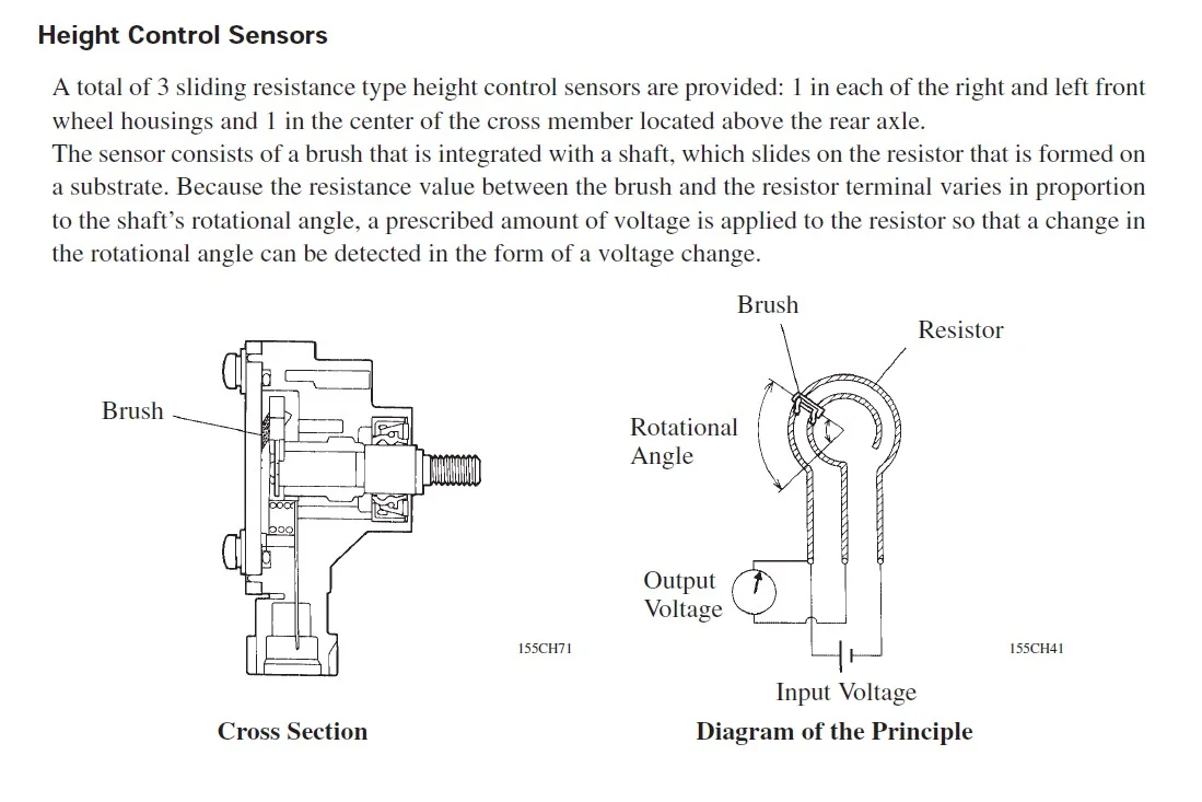

After ~17 years of continuous movement every time the vehicle is driven, wear of the carbon track within the Sensor and/or wear or loss of pressure by the brushes which run on the carbon track (either causing constant or intermittent open of high resistance circuits), and/or moisture/dirt causing ‘tracking’ (short or low resistance circuits) within the Sensor are all eventually inevitable in this ‘wear item’.
Suggest close inspection of the connector and the wiring leading into the connector.
Also suggest replace the Rear Height Control Sensor for reliability as planned anyway. At ~17 years of age the Rear Height Control Sensor has had a fair innings in a hostile environment and it is well past its best. Strongly recommend using only OEM replacement Sensors (TOYOTA/LEXUS or possibly AISIN) to avoid the short life of the various subsitutes and fakes.
The Front Height Control Sensors are not implicated in the symptoms described -- but in 2024, they are closer to end-of-life than they were 14 years earlier in 2007 ex-factory. The intended further inspection/testing of Front Height Control Sensors is warranted anyway.
By the way, a faulty or damaged Height Control Sensor may transmit signals within the FSM-specified range of timing and within the FSM-specified voltage range of 0.3 volt to 4.7 volt, but at the wrong positions, meaning that the actual height of the vehicle is incorrect. Provided the voltage signal is acceptable to the ECU, there will be no DTC even if the vehicle height is incorrect – so observation of vehicle behaviour is an important part of diagnosis.
It is not clear why C1718 is showing -- suggest check the connector and wiring and test the Pressure Sensor at the AHC Pump, as intended. This is the only Pressure Sensor in the AHC/TEMS system on LC100/LX470.
ECU problems are possible but seem highly unlikely in the absence of other symptoms.
