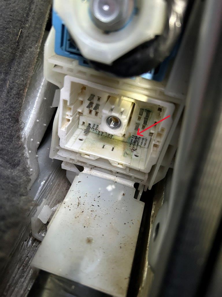

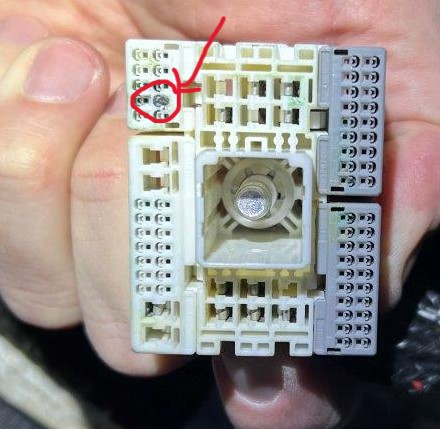

I haven't looked up the wiring schematic yet to absolutely confirm this is causing MY issue, but my guess is that it is. Open to suggestions on how to fix this... I guess the right solution is to pull all of this apart, extract the broken pin and repin the connector. Sounds like a nightmare.

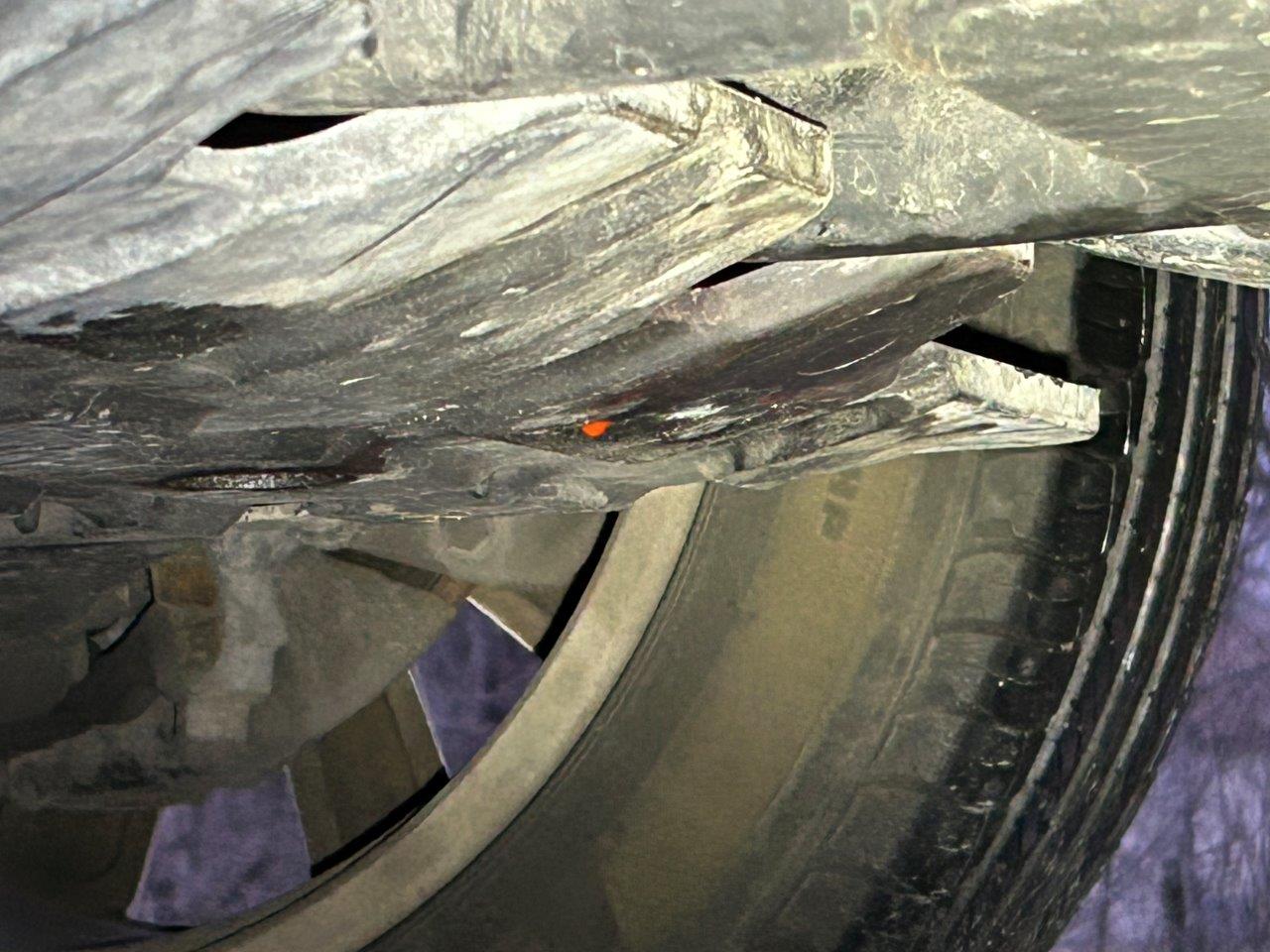

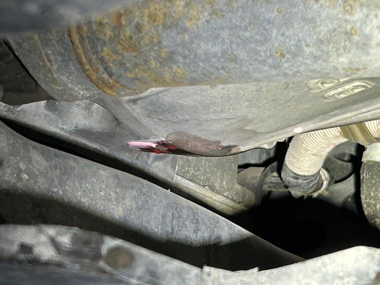

On to the AHC issue. Pulled the service cover in the wheel well and found the fluid is about 1/4" below the min line with the height set to the Neutral position. I believe it's supposed to be between low and high in Neutral? So, there must be a leak. Incidentally, I found a drop of viscous pink fluid on the garage floor for the first time when I pulled it out. It seems Toyota likes pink fluids, so I'm not 100% sure what it is, but I do see oil collecting below the transition here:
Thoughts on whether this could be AHC fluid, or it not, what is it likely to be? It got dark and I couldn't trace it back to a source today.

Clean AHC fluid is pink-ish and so is Toyota long life coolant. If it’s oily it’s probably AHC fluid
The first pic of pink drops are the bellhousing, correct? If so you most likely have a valley plate coolant leak.

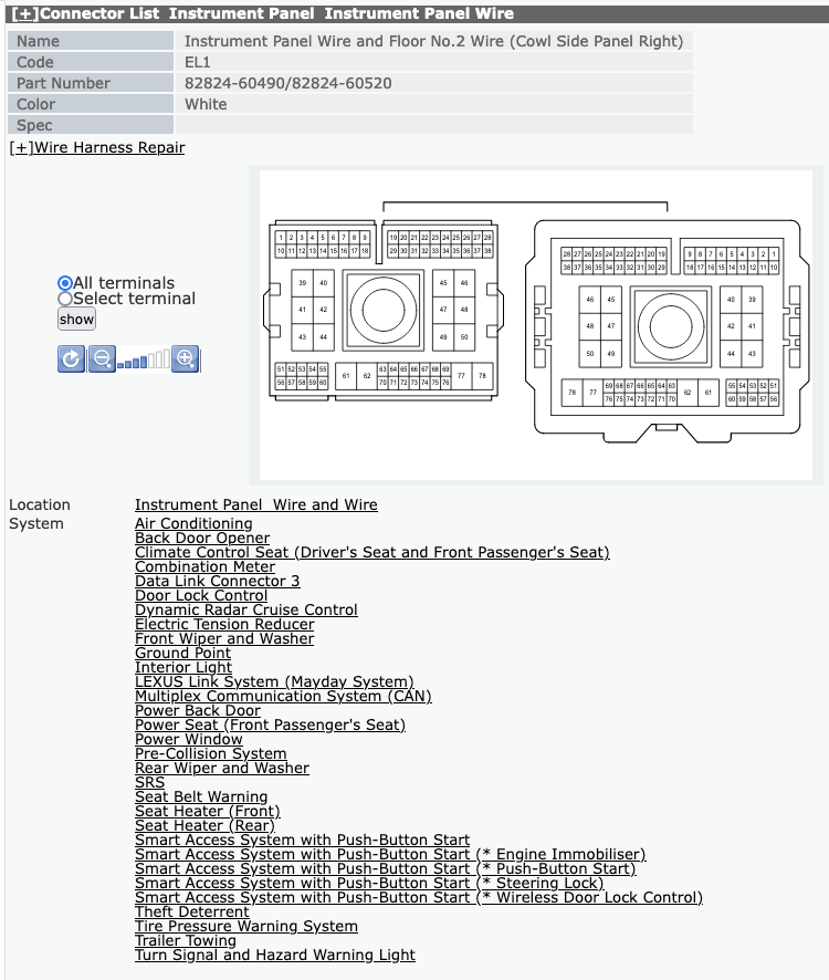

And yes, you'll need to repin that wire. I've done it for much larger connectors.. will dig into the FSM to see if there's any intel on those compact ones.
Edit: that appears to be pin 54 on connector EL1. standby for what it does and possible repair stuff.
Especially where you can see it dried to a pink crust. AHC Fluid wouldn't do that, and the coolant definitely does.
Yeah, it is. s***. Is that a big / expensive problem?

It's not big in that it won't fail dramatically and leave you stranded, it'll just leak slowly and risk you running low if you don't stay on top of it.
The fix itself.. intake manifold has to come off, SAIS valves too (which is the hard part of the job, or so I've read).
Just search for valley plate leak.. lots on this topic.
Looks like pin 54 is for the front right door lighting, though frankly the circuits are pretty confusing.
