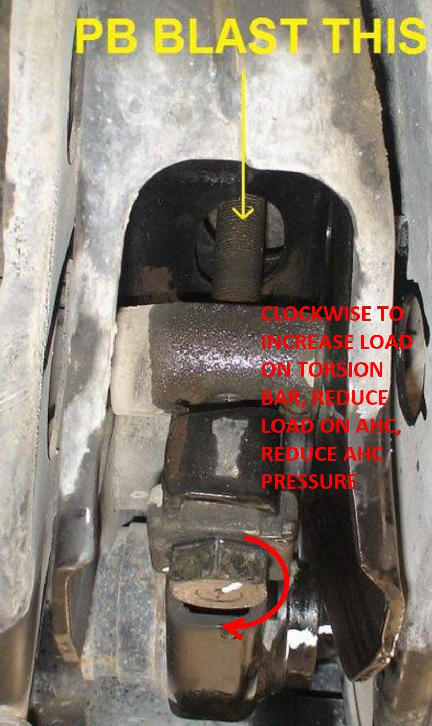

Clockwise = tightening the nut = righty tighty when you’re staring up at it from under the truck. Doesn’t matter which way your head or feet are as long as you’re looking up from underneath.
no I trust you, i just thought i was missing something is all. makes sense! and clockwise turns means under the car head pointing to front bumper on my back?
Yes – when looking from below at the bolt-head on the Torsion Bar adjuster, turn clockwise for two separate purposes:
  1. increase level on that side during the ‘cross-levelling’ step. NOTE: The main purpose of the so-called ‘cross-levelling’ step on an AHC vehicle is to ensure that both torsion bars are carrying equal loads. This will happen when the hub-to-fender distance is the same on Front Left and Front Right,
  2. increase the load carried by BOTH torsion bars. This reduces the load carried by the front AHC system. In this way, the front AHC neutral pressure is lowered. NOTE: For comparison with FSM specifications, neutral pressures must be measured with vehicle at the correct operating heights.
Turn the Torsion Bar adjusters anti-clockwise for the opposite effects.
These are the only purposes of the torsion bar adjusters on an AHC vehicle.
The ‘operating height’ sometimes called the ‘ride height’ – hub-to-fender: front 19.75 inches, rear 20.50 inches – on an AHC vehicle is set by moving the Height Control Sensor adjusters and not the torsion bar adjusters. This is because the AHC system uses the average of the two front Height Control Sensors to choose the Front Height of the vehicle and uses the single Rear Height Control Sensor to choose the Rear Height of the vehicle, regardless of what the front torsion bars and rear springs may be doing (within limits).
Different to a non-AHC vehicle, on an AHC vehicle the Torsion Bar adjusters are NOT used to set the ‘operating height’.
At the front, shortening the Height Control Sensor adjuster using the double-ended Heim bolt (or pushing the slider upwards) causes the vehicle to rise. Start with small changes at the Height Control Sensor adjusters – say 2 or 3 millimetres or one-eighth inch to see the effect of maybe 10 to 12 millimetres or half-inch on the hub-to-fender measurement.
The Electronic Control Unit (ECU) for the AHC system assumes that the torsion bars are correctly and equally set -- but the ECU has no connection to the torsion bars and no way of knowing whether they are correctly set or not. If the torsion bars are not equally loaded, then the vehicle will perform strangely on the road – Left turns will feel different to Right turns – and it will be more difficult to set the ‘operating heights’ correctly.
Then, if incorrect or widely differing ‘operating heights’ cause a conflict to be received by the ECU, it will default to a ‘fail safe’ mode in which variable damping will cease and poor ride quality will be experienced.
For all of that, the AHC system is not as complicated as it may seem at the start, there is nothing to fear, nothing which cannot be corrected -- you have done the research – all will become clearer as you learn-by-doing.
There is an important safety rule: Measurement of ‘operating heights’ and ‘neutral pressures’ etc must be done with the engine and AHC “ON”. Turn engine and AHC “OFF” when making actual adjustments to avoid risks of sudden movements of the vehicle and potential injury risks to head, hands and body. Then turn engine and AHC back “ON” to see the effects of changes with head, hands and body well clear of the vehicle.
Torsion Bar Adjuster

Do not adjust height sensors in your case. Crank torsion bars to get the side to side level, then pull up techstream and see if the +/- values on there match up with reality. If they do, you're done. If they do not (IE you're level, but techstream says on side is .75 inch low) then you would adjust height sensors.
Keep in mind the height sensors do not control side to side height at all. The ONLY thing that determines side to side height is the torsion bars.

Nice work! Crank those front torsion bars and check again. I'm guessing you need 7 turns per side, but maybe start with 5 and check again. You're way off spec now, so it should feel much better (and improve long term durability) once you get it sorted out.
Just thought I’d post my readings and see what you all think? Maybe two turns clock-wise?

  • PB Blaster and jacking up the front suspension made the nut very easy to turn.

@suprarx7nut - thanks for the awesome video and guide. I went through it today and just adding a few notes if it helps others.
  • The temperature sensor has a clip on the bottom side much closer to the fluid reservoir than it is to the exposed wires. This needs to be depressed and the connection will release easily. I was pushing on what I assumed to be the release but in the wrong place because I couldn't see the bottom side.
  • I had to go out and buy a 30mm 6 point socket. I was having trouble finding a 6 point socket but an axle nut socket fit the bill.
  • The torsion bar adjustment is much farther back than I assumed it would be. I thought it would be by the front suspension bits, but it's well back from that. Pretty easy to find though.

To recap longhand the steps for measuring pressures –
  • AHC Front,
  • AHC Rear,
  • AHC Height Control Accumulator ….
These are measured one at a time by the single pressure sensor on the system, under the control of the Suspension Electronic Control Unit (ECU). The pressure sensor is the large item next to the temperature sensor on the aluminium manifold to which the AHC Pump and its motor are attached.
The steps are:
1. Connect Techstream (or other scanner capable of reading the Suspension ECU),
2. Change heights “N” > “LO” > “N”,
3. On raising from “LO” to “N”, the green AHC light on the dashboard blinks,
4. On a healthy vehicle, the raise "LO" to "N" starts when the solenoid valve at the Height Control Accumulator is opened by the ECU,
5. AHC Fluid flows under stored pressure from the Height Control Accumulator to the ‘globes’ and more importantly to the ‘shock absorbers’ which then wholly (or partially) raise the vehicle (depending on vehicle condition),
6. The AHC Pump starts under the control of the ECU and if necessary completes the raise until the ECU receives the relevant voltage signal from the Height Control Sensors for the height selected at the console switch – “N” in this case,
7. As the vehicle raises, changing AHC Front pressure and AHC Rear pressure and height sensor readings may be observed on Techstream or other scanner,
8. When the raise is completed, the green AHC light on the dashboard stops blinking,
9. The AHC system is not finished -- the AHC Pump does not stop but continues to run until it has re-charged the Height Control Accumulator with AHC Fluid from the AHC Tank.
10. Theoretically, re-charge of the Height Control Accumulator takes about 15 seconds after the green light stops flashing for a new stock vehicle at stock weight in good condition -- but can be longer, maybe ~30 seconds or even 45 seconds for an older or heavier vehicle (much longer would suggest that there may be other problems),
11. When the Height Control Accumulator is recharged, the AHC Pump stops -- listen for this -- and the Height Control Accumulator pressure reading should appear,
12. Then, and only then and not before, it is time to read and record the three AHC pressure readings -- otherwise the readings will be misleading. (If the Height Control Accumulator pressure remains at zero, then there are other problems).
The “Oil Temperature Sensor” (meaning AHC Fluid temperature) reading on your Techstream images shows -22 degrees F. This is because the temperature sensor is disconnected per FSM for the test procedure. This will cause a Diagnostic Trouble Code (DTC) to be registered. It is best to check via Techstream that this IS the actual DTC -- and not some other cause.
Other than these details, all appears to be going well. Hang in there!!
PS: Suggest also be aware that Front AHC pressure and Rear AHC pressure as measured correctly with "N" height selected, will vary with the choice of 'ride height' of the vehicle at the "N" setting -- more 'ride height' = more weight and pressure on AHC system, less weight carried by torsion bars and springs -- so it is good practice to check with a tape-measure the hub-to-fender distances at "N" height any time AHC adjustments or tests are made. 'Ride height' can be changed by re-positioning the Height Control Sensor adjusters (not torsion bar adjusters on an AHC-equipped vehicle). Whatever choice of 'ride height' is made, the torsion bar adjustments and rear spring choices must then be made to maintain AHC Front and Rear pressures within the FSM-specified ranges -- for good damping performance and good ride comfort, assuming 'globes' are in good condition.
And with the 'ride heights' understood and AHC pressures corrected, then it is time to check overall condition of the four 'globes' by checking the amount of AHC Fluid displaced to the AHC Tank between "HI" and "LO" heights -- a difference of ~14 graduations at correct pressures means 'globes' are near new; a difference of 7 graduations at correct pressures indicates that it is time to replace all four 'globes' and recover damping performance and recover ride comfort.
