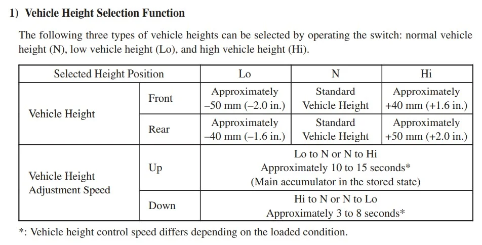

Just to mention that this response by the vehicle means that it is not in one of the 'fail safe functions' (phew!!) because AHC is at least working.
It is still important to check that the AHC system is working correctly and that a raise has been completed correctly -- even if no DTC's are recorded on Techstream or other scanner. The fact that the raise stops and the AHC Pump stops and the green AHC light on the instrument panel stops flashing does not tell you that the raise has completed correctly.
It is essential to check hub-to-fender physical tape-measurements AND Height Control Sensor readings -- this is basic data. Results should include all Height Control Sensor readings on Techstream near zero +/- 0.2 inches AND physical measurements similar to below:
The attachment to Post #11 at the following link shows what can happen:
In this case most of the relevant components are new and individually they test correctly per FSM on a 'young' 2006 vehicle. There are no DTC's. AHC Pump stops, AHC green light settles at solid green, stops flashing, all as expected after a raise. However, the vehicle has not completed the raise correctly when the hub-to-fender measurements are taken AND the Height Control Sensor readings are observed. Connectors and wiring harness are next on the list in this case.
Just to mention that this response by the vehicle means that it is not in one of the 'fail safe functions' (phew!!) because AHC is at least working. It is still important to check that the AHC system is working correctly and that a raise has been completed correctly -- even if no DTC's are recorded on Techstream or other scanner. The fact that the raise stops and the AHC Pump stops and the green AHC light on the instrument panel stops flashing does not tell you that the raise has completed correctly. It is essential to check hub-to-fender physical tape-measurements AND Height Control Sensor readings -- this is basic data. Results should include all Height Control Sensor readings on Techstream near zero +/- 0.2 inches AND physical measurements similar to below:
In this case most of the relevant components are new and individually they test correctly per FSM on a 'young' 2006 vehicle. There are no DTC's. AHC Pump stops, AHC green light settles at solid green, stops flashing, all as expected after a raise. However, the vehicle has not completed the raise correctly when when the hub-to-fender measurements are taken AND the Height Control Sensor readings are observed. Connectors and wiring harness are next on the list in this case.

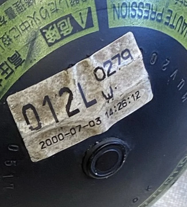

Couple of thoughts on new-ish globes failing:
Killer of globes is excessive pressure on them. With fronts this can happen with improper T-bar adjustment. Which can be from neglect, mostly to LF globe. Or sensor lift and or extra weight in front end and not compensated.
It's also possible old stock used when replaced. All globes have a date codes. What date are on your bad ones?
Read as 2000 July 3rd at 2:26:12PM
Additionally: it is best driving practice, to dial to AHC Comfort, when on bumpy roads/terrain. In sport mode, the globes, shock & shock bushings take a beating.
Wrong fluid used, perhaps! I have one front shocks (rears not tried) are supper stiff when working in and out by hand off the vehicle. It had a blown out FR globe.

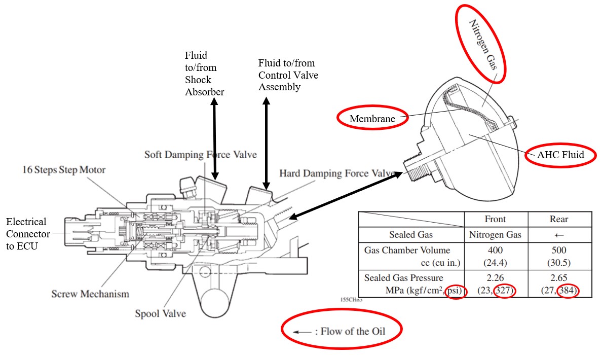

An expanded explanation and pictures are offered below and may be of interest to others.
Over-pressure in the hydraulic side of the membrane will be matched by the gas pressure equalising as the nitrogen is compressed on the gas side of the membrane.
With high AHC pressures, flexing of the membrane may be extreme during suspension movements while the vehicle is in motion -- from the “protective button” touching at or near the gas fill-point at the back of the ‘globe’ to touching the AHC Fluid entry point where the ‘globe’ screws into the Damping Force Control Actuator.
The flexing will be worst in rough conditions. In those conditions, the “Comfort” setting adjusts the valve settings within the Damping Force Control Actuator to allow the suspension to move more quickly at bumps by providing less damping force to resist suspension movements. The vehicle (bushes, ‘shock absorbers’, chassis, body and passengers) will feel less shock loadings than at the “Sport” settings where valves are set to increase damping force and provide more resistance to suspension movements.
In this situation, there will be more deeper and faster movements (flexing) of the membrane at the “Comfort” setting, made worse and more violent by excessive AHC Pressures.
Eventually, flexing under increased AHC Pressures will weaken the membrane more quickly than under FSM-specified AHC Pressures. Nitrogen will pass into the AHC Fluid and AHC Fluid will pass to the gas side of the membrane. This may happen slowly or quickly. The ‘damping effect’ provided by the ‘globe’ and Damping Force Control Actuator, acting together, reduces and eventually is lost. A springy (pogo stick) undamped rough ride is then experienced in the vehicle.
So the moral of the story is that long life of AHC ‘globes’, good damping and good ride quality all require that
  1. AHC pressures be monitored from time to time -- say yearly or whenever major permanent additions are made to the vehicle, and,
  2. AHC pressures be maintained within FSM-specified ranges by adjustment/re-indexing of Front torsion bars and upgrading Rear coil springs to compensate for added permanent loadings.
Just very, very basic maintenance. Easy!
