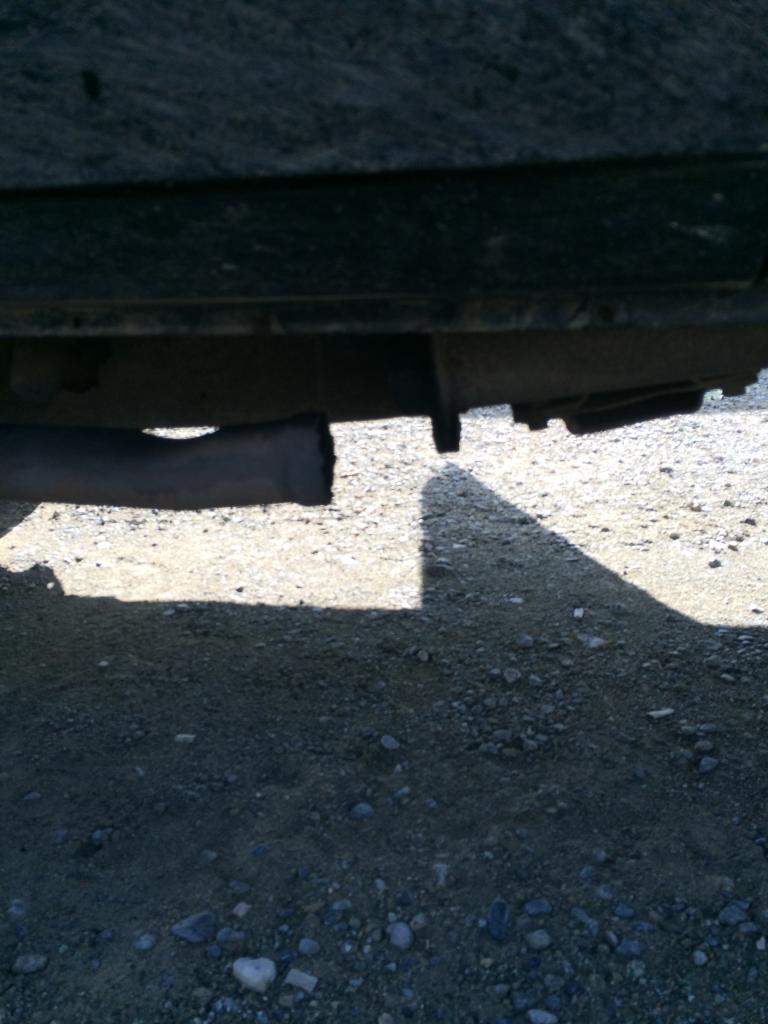

Left the shop last night and all of a sudden everything got a little louder. Got out to look and had a "there's your problem" moment. I guess my afternoon is planned out for me today.
Doh! Going to throw a new muffler on there, or redo the whole exhaust?
Are you planning to turbo the 3B in the future?
I bought a mandrel bent 2.5" aluminized pipe kit from Lordco when I did mine, and it has stood up well. Went with an Aeroturbine muffler which I've been very happy with, but it might be a bit loud on a non turbo cruiser...
It will be getting a turbo sometime in the future, when It does I will be using the second half of a universal stainless 2.5" dual kit my friend has. (The first half is in his celica). So for now I'll just be patching things back together.

That first section of pipe was still available at toyota when I had my 70. Made life easy, not cheap, but I don't remember it being that bad.
It actually just broke right at the clamp, so there's still some over lap. I should be able to get away with a new clamp and some muffler cement. And if not then ill break out welder.
I'd clamp and weld it. Cement has never worked for me.
I ended up clamping it and giving it one good tack weld. I used cement but more just to seal it. Should hold for a while... Hopefully
