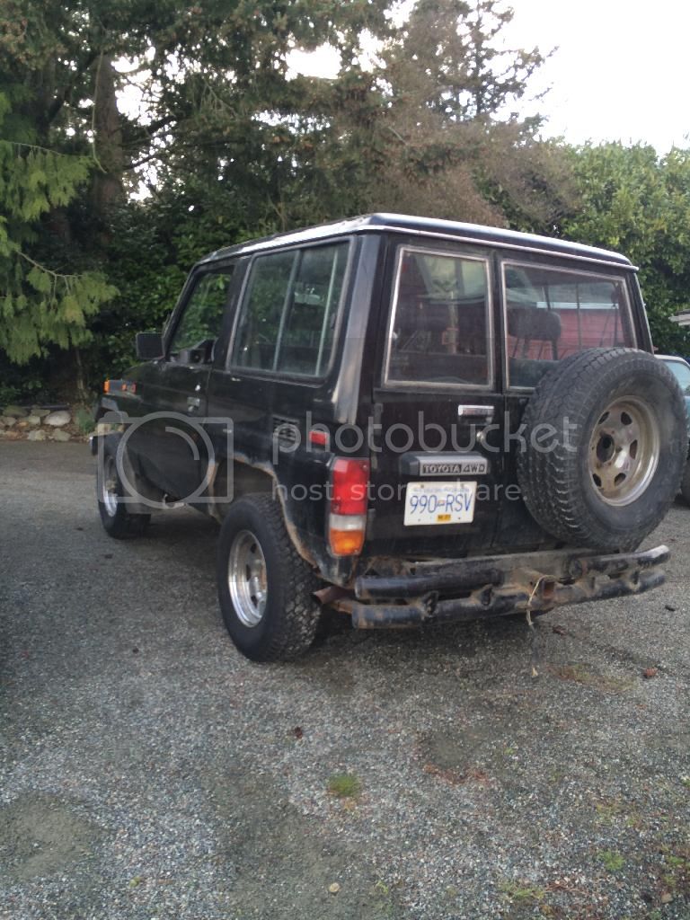

So against what was probably my better judgment, I sold my 83 pickup and bought the bj70 I was looking at. I was able to get the price down a bit from the asking price although it's not the deal of the century by any means.

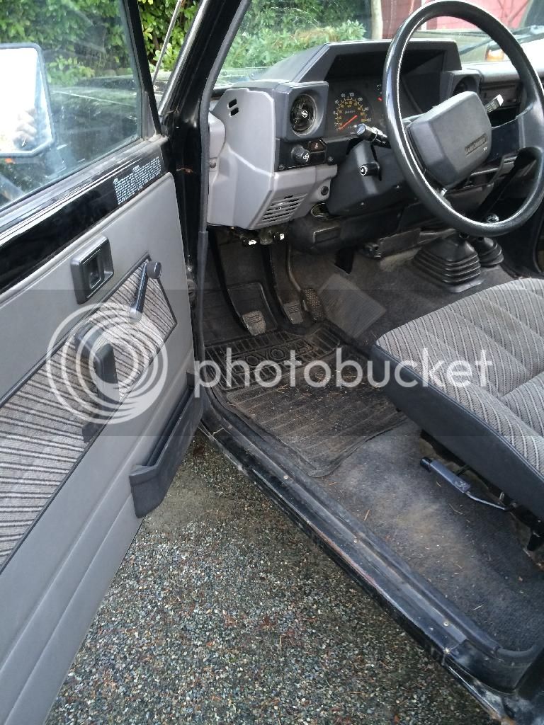

Well anyways it's an '86 368km it's very stock, interior is great, just needs a cleaning. The thing drives awesome... No complaints there.
It relatively has more power than my pickup did. And im so glad to have a low first gear again! Going into tugwell with the pickup was painfully fast to not stall it.

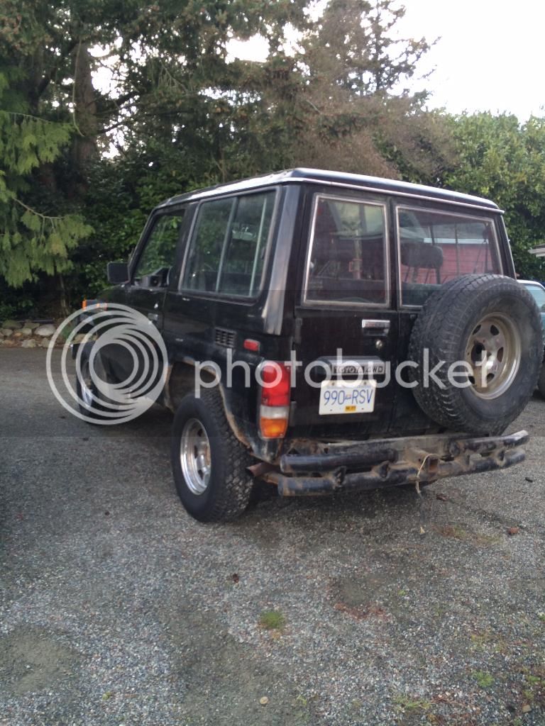

The bad part is the rust, the rear quarters are pretty bad, but the rest is pretty sound. It's decent fenders doors and floors. I have a pretty good idea of my plan for the rear quarter repair, going To fabricate new panels from scratch.
