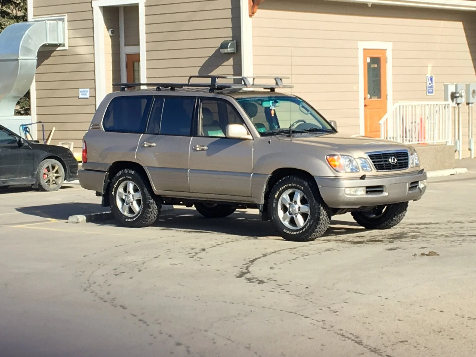

Tundra wheels on 100 series photo thread

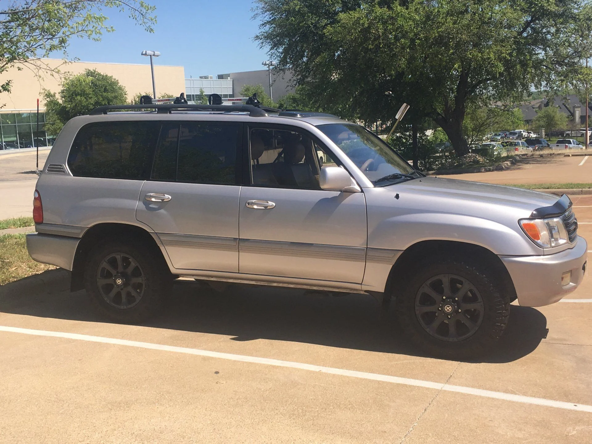

I personally went with the American Racing AX188's. Great fitment without spacers, and I got a deal on them from a member here. I removed the fake plastic chrome studs on the edges of the wheel to tone them down a bit.
The only problem you might find with those wheels is the front hub clearance with the provided hub cap.

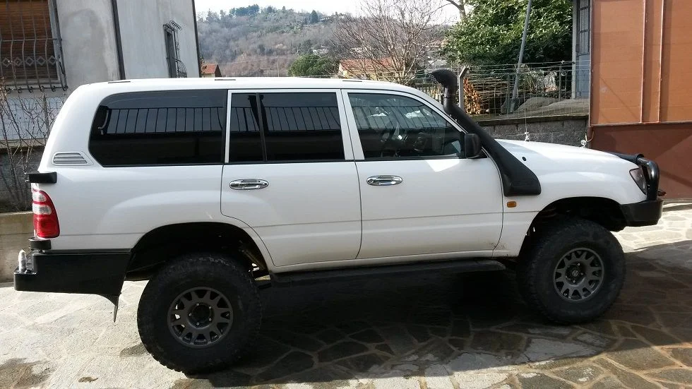

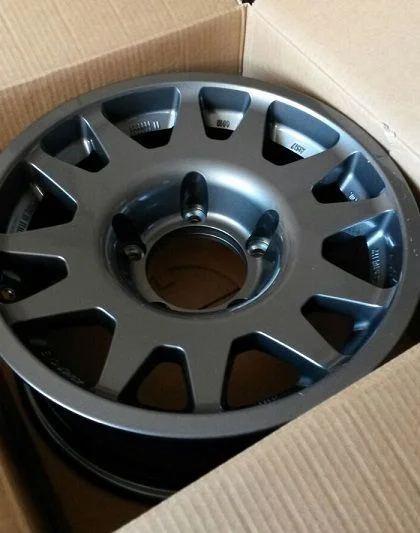

here's my hzj 105 that mounts rims of EvoCorse model Dakar zero 16 x 7 et -10 with 295/75 tires r 16
the rims, are a competition model, with a breaking load of more than 1500kg and weighing 12 kilograms each.
They are also available in 17 x 8,
4 standard colors, black white and charcoal gray.
this year, is expected to arrive on the market the same rim measuring 16x 8
Rims are made entirely in Italy.
