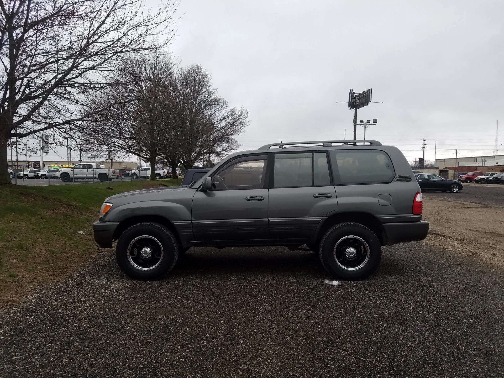

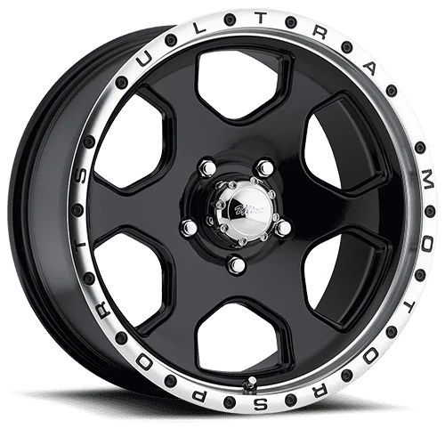

I ended up going with these, Ultra Rogues wrapped in Kumho Road Venture AT51 275/70R18, and I'm happy so far
