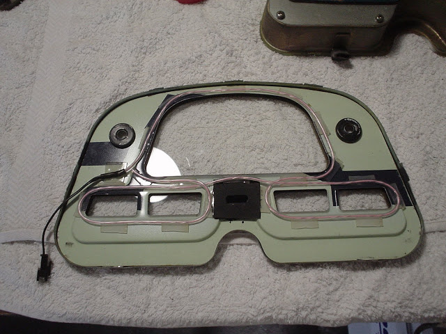

Just wanted to give a little input to anybody on the fence about this. Do it! The EL wire works awesome. I hot glued it in place soldered the wires into the back of the pins on the pc board and I can see my gauges at night again! Thanks again Drew.
Just finished installing the EL wire to my 40 and I am absolutely chuffed. What a change. One of the best mods I have done to my 40.
I used very thin double sided tape to hold the wire in place. No glue needed.
I also ran tighter bends on the outside of the small clusters. No dark corners.

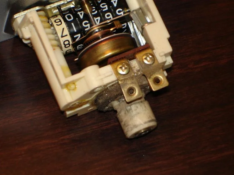

I am putting together my cluster and noticed the speedometer dosn't have the cut out for the two electrical connectors in the back. Here is a pic of it. im not even sure what it goes to.
Its a speed sensor for some emissions control doohickey. Many speedos have it, but I wasn't aware of it when I made the kit, as many speedos don't.
If you still have a 2F with functioning emissions doo dads, just bend the tabs down and hook them up (don't let them short against the gauge bracket).
If you've swapped the 2F or emissions whatsits out already, then just unscrew those terminals and discard the reed switch all together.

Christian - the EL wires can be dimmed with a variable resistor/potentiometer/volume control on the power supply wires. It will stay lit all the way down to 3 or 4 volts, where it will be quite dim.
As for your dash lighting, EL wire might not be a perfect choice. Because its a strip of lighting instead of a point source with a reflector, the light does not carry very well. If you want to light up a surface, the wire needs to be less than an inch away or its not going to do much good at all. This is why it works well in a cluster, where the wire is only 0.25" from the gauge faces. It might work, but no promises.
You are correct that the light is very white - it looks more like fluorescent than incandescent. I can get yellow wire, but thats going to be tooo yellow. You'd probably have to mix a stand of white with a strand of yellow or orange. I might be able to try this out for you sometime in November if people are hating the white look.
