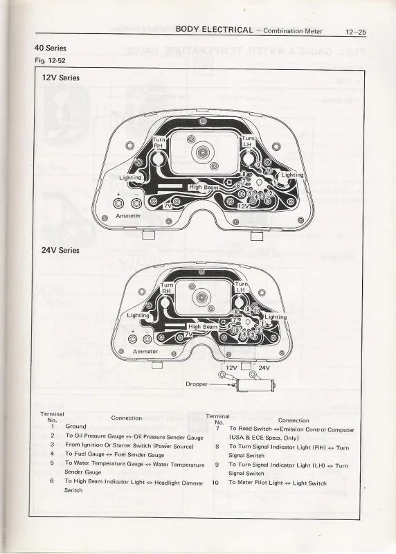

How would I power it?
If you remove the 2 light bulbs, you can solder the wires to the blank copper tracks or solder the wires to pin #10 (+12V meter pilot lights) and pin #1 (ground).
