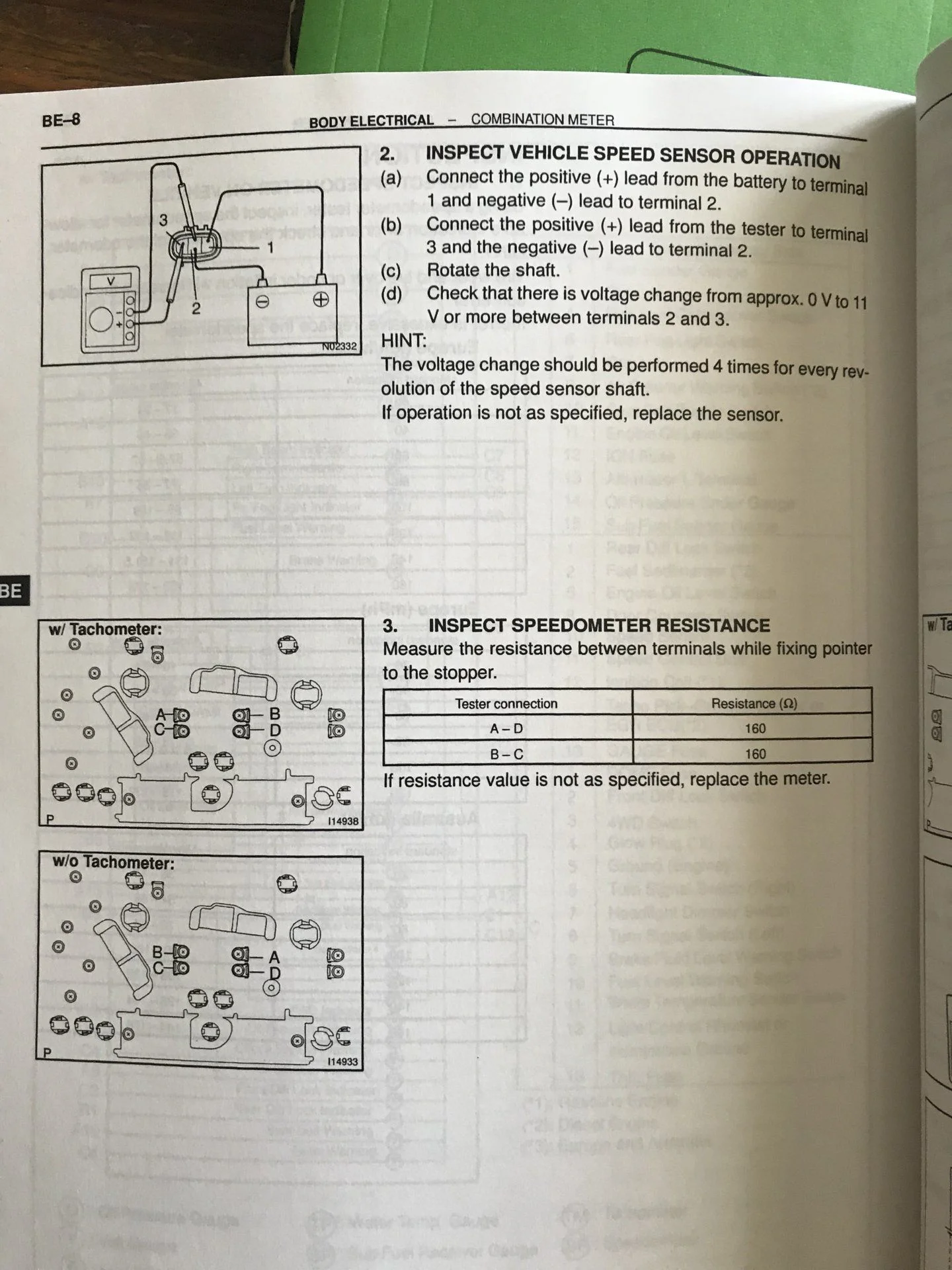

Thanks for the tips, really helpful.
Thanks for all those informations. Great help. I am away from my dear Troopy until Wednesday night. She is waiting in the airport parking garage while I am on a business trip in Paris.
I will keep you guys updated.
Thanks again. Love the repair manual! Where can I get myself one of those?
