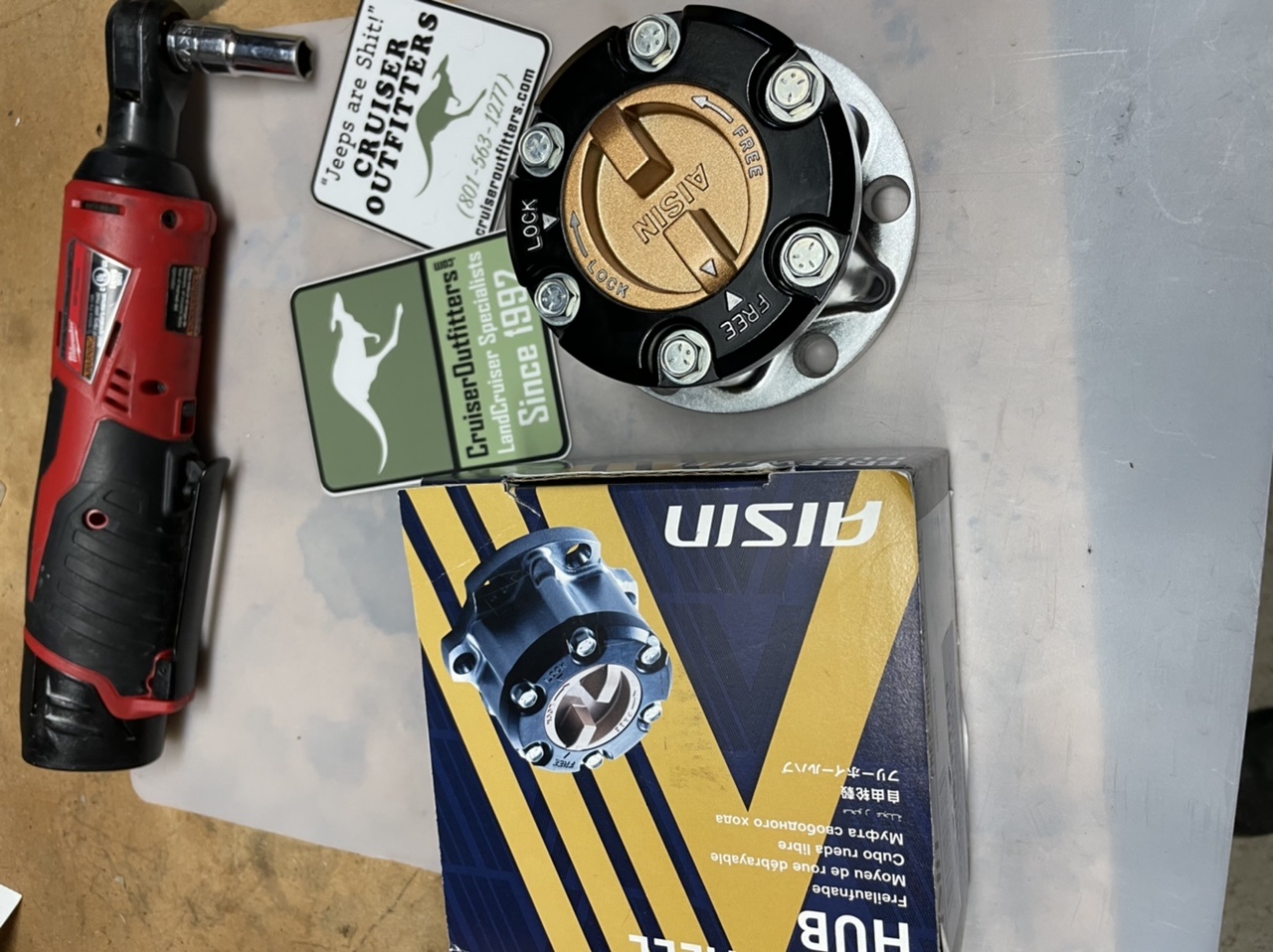

It started when I was in Salt Lake City last week to visit some family that lives in Sandy. I had to make a pilgrimage to the Land Cruiser Heritage museum while I was in the vicinity. Which is awesome BTW. I was looking on google maps for a restaurant when I saw Cruiser Outfitters was nearby. I’ve been wanting to buy some new hubs for my truck so I figured I might as well pick them up and save on shipping. After some scrutiny from TSA I was able to bring them home.
My main question is what is required for lubrication. I’ve seen them installed basically dry to fully packed with grease. Any slick tricks for getting the cone washers out?

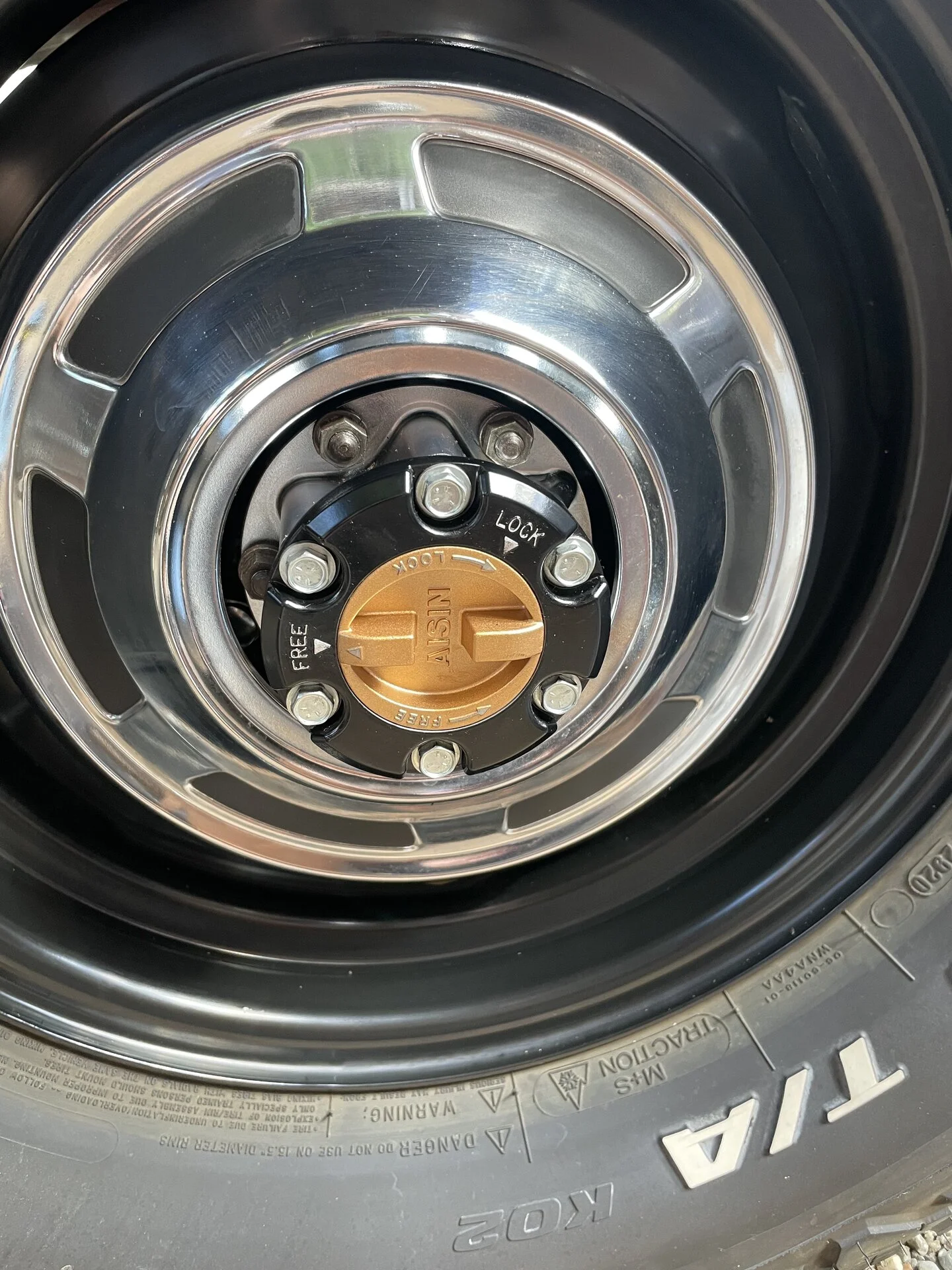

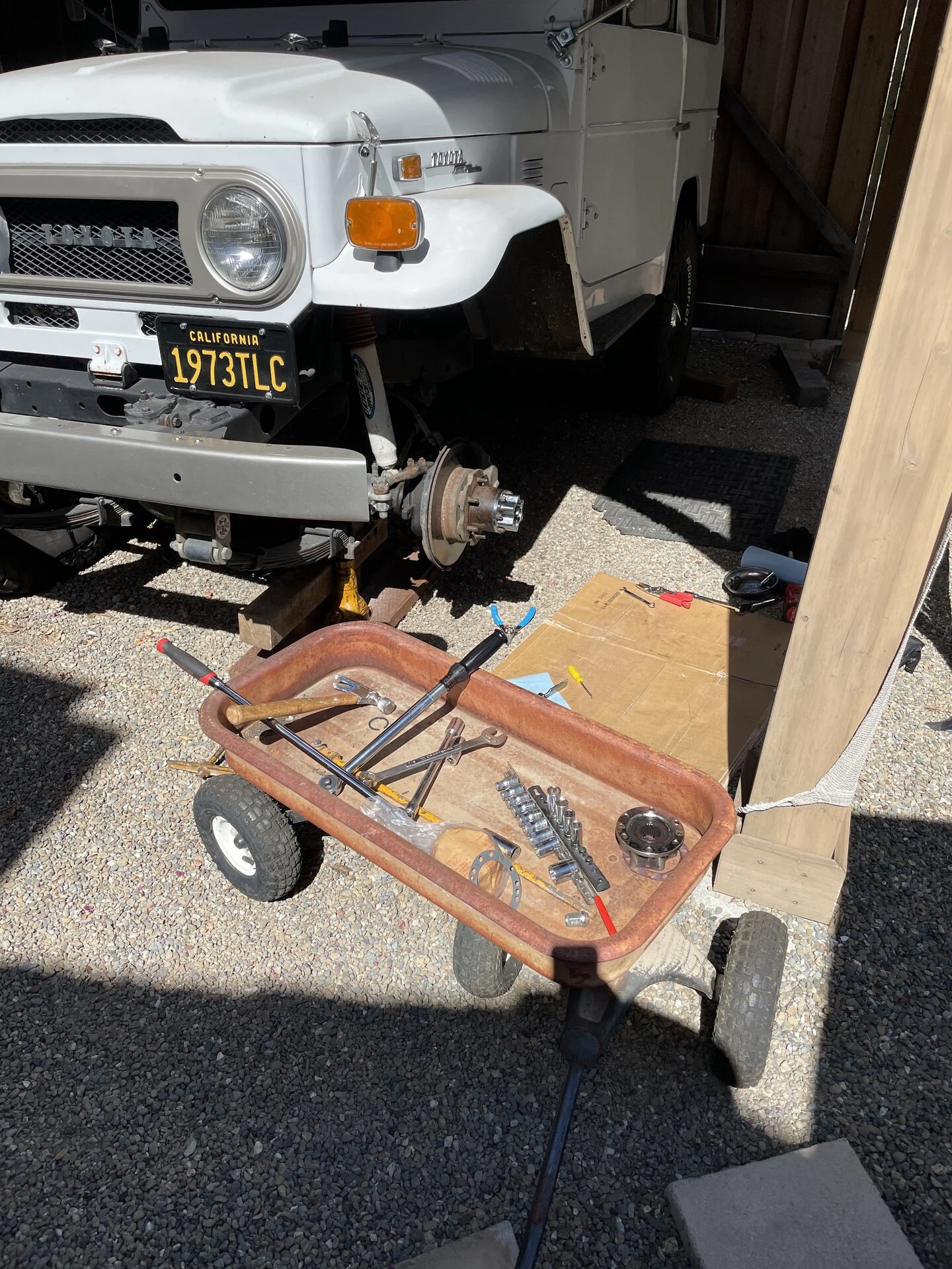

Got it done! I didn’t feel like going to HF to buy some tools I might never use again, so I went with what someone said is in the FSM. I took a chisel to the side of the cone washers and they popped off quite easily. After I chased a few that went flying, I put a nut on the end of the stud. I was surprised how well it worked.

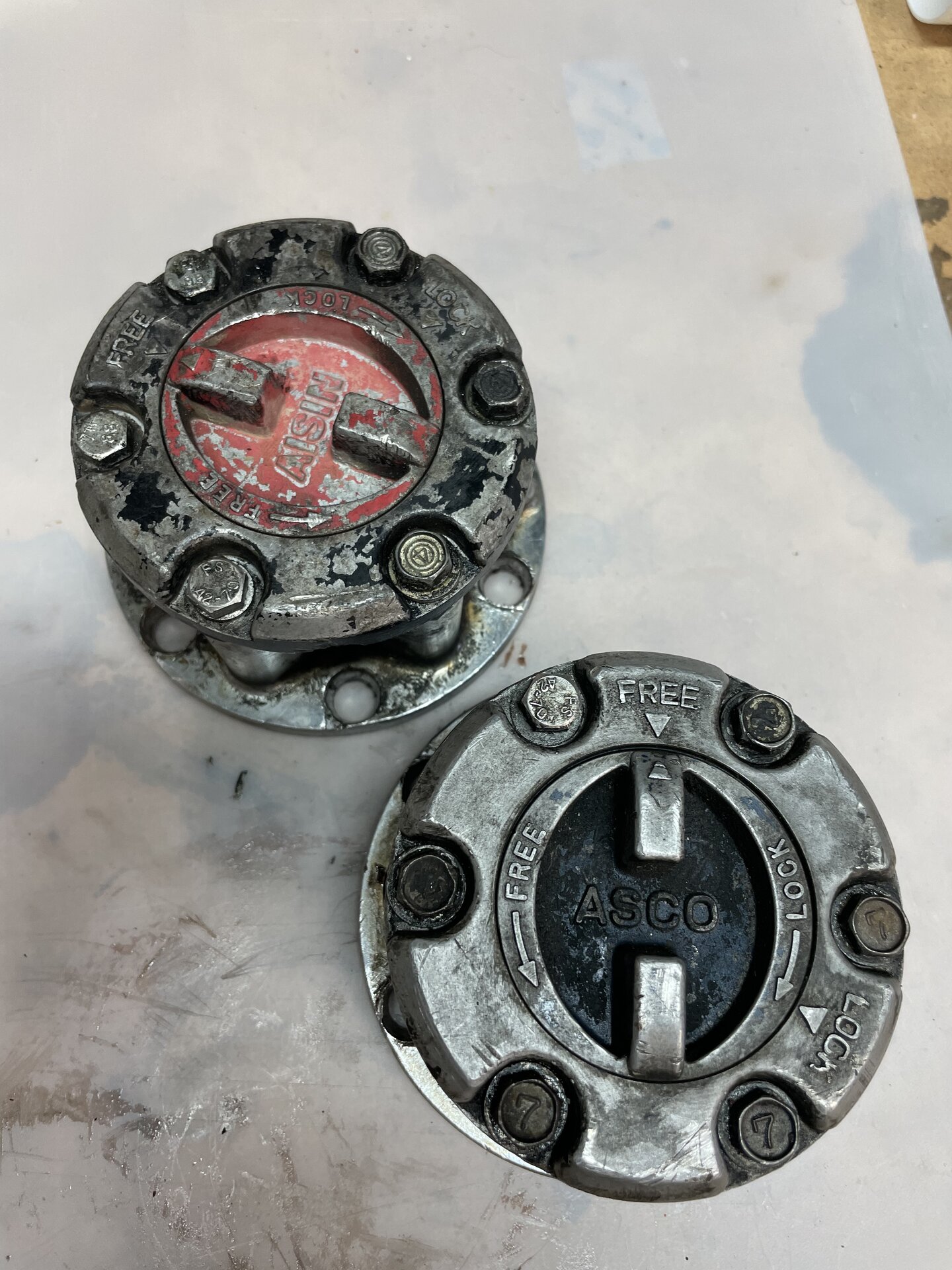

If someone wants a mismatched beat up pair of hubs, make me an offer!
