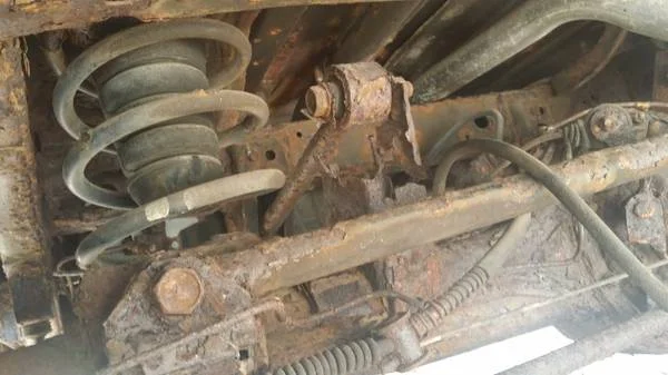

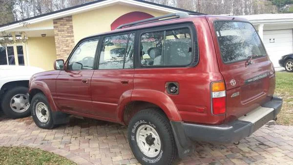

I'm looking at this 1991 FJ80 it has under 80,000 original miles. However, it is rusty underneath. The body looks ok and the interior is very good. Price is around $1,000.
The engine, interior and transmission should be fantastic. What do you think about these options.

For 1000 you really can't beat that, but for how rusty the undercarriage is, I would check under the hood. Don't just assume that low miles means no issues.
That looks like the under side of mine. With that came leaky brake lines and rear coolant pipes, holes in the gas tank, and frozen e-brake cables. I got mine for free so I'm trying to fix it. I'm searching for parts from down south that I'm going to swap in. Good luck.

Drive it?? Unless it's just the angle/view, it would appear that the DS rear upper control arm no longer attaches to the axle...
Looks like it was often parked axle deep in the ocean...

It really depends on what $1000 means to you. I bought my 94 with 80,000. Being a newbie to old vehicles I had no idea what a pain it would be with the rust. If I could go back and start over I woulda bought something with 200,000 and no rust. Runs like a champ but 20 hours to change the rusted out radiator just sucks.

That looks like some Katrina funk..negative ghostrider!
Rust is the reason I am no longer maintaining like I use to and the one in pic doesn't look safe to drive.
Nothing wrong with a $1000 rusty beater but from the pic, the suspension is gone on that one.
You could try and pull the drive train out but you most likely will break every bolt removing them.
