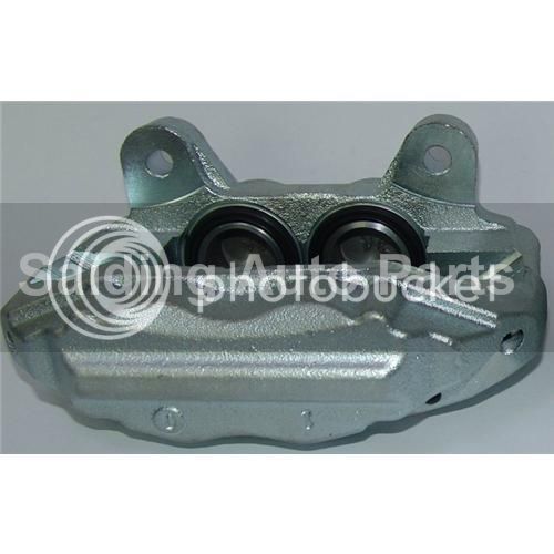

Another horrifying tip I see too often: Just grind a little off the caliper until the wheels fit.
Yeah, don't do that.

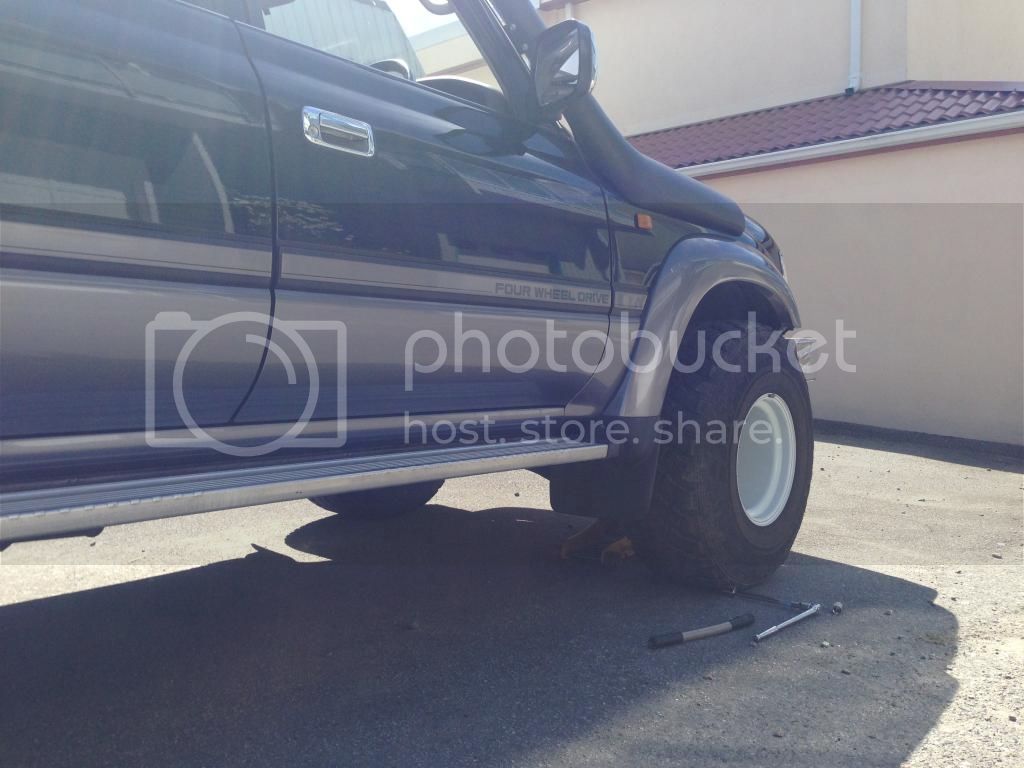

I downgraded to pre 95 hdj81 rear disks and I shaved 1mm of the flat ridge on my front caliper. Like a glove. 15x12's all day long.
Just a very light pass on the bridge section on the outer 2 pistons.

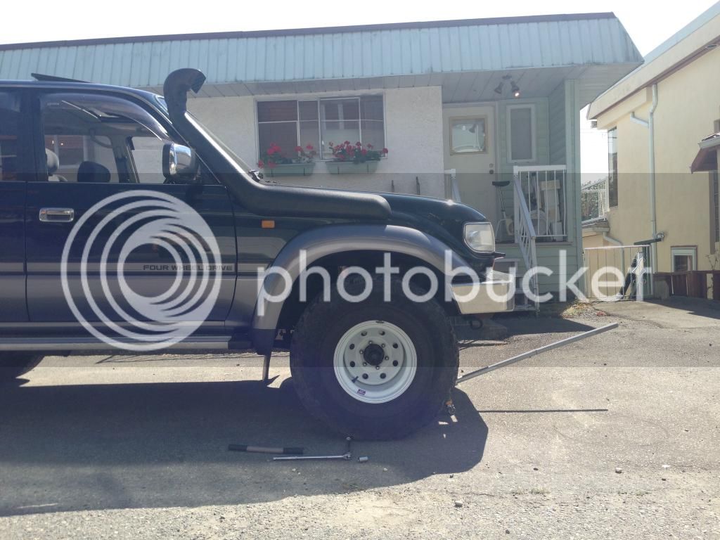

as for 15" wheels... i'm running 15s with a 2.5" backspace... they fit on the back and i had to grind the front calipers a little bit... the design of the wheel can make some difference too...
