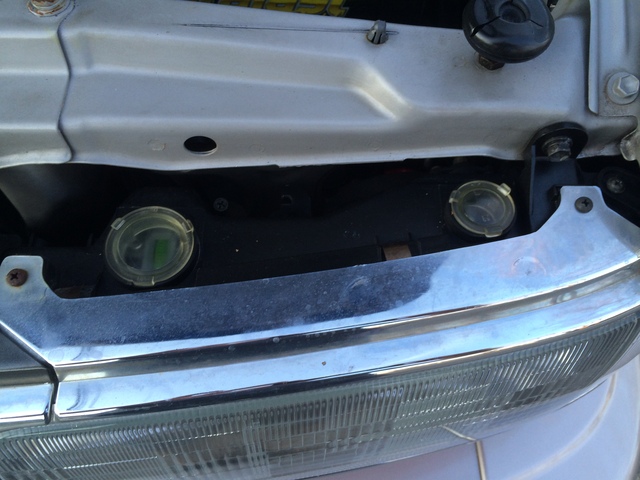

I just picked up the 2016 Version of the LED 9006's from E-bay and WOW !! they make a big difference !!! After the install I need to adjust them down a bit and wanted to make sure I'm not missing something because I have NO movement with the top adjuster screw...
Bulb's that I installed:
Headlamp Assy. ( Not sure if the Toyota Headlamps are the same ? )

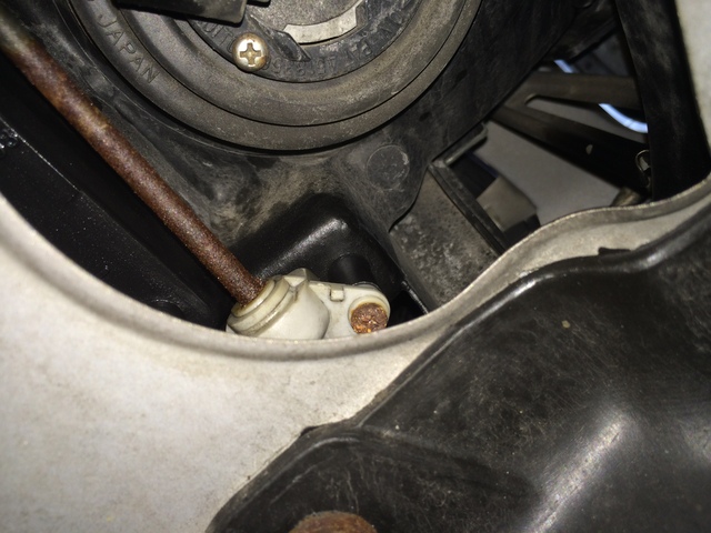

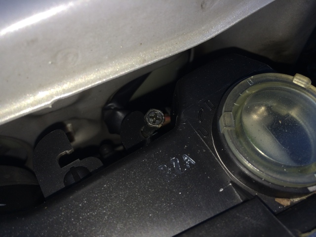

Top Adjusting Screw:

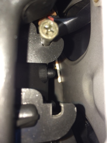

The Screw goes down to this:
I'm thinking this Adjuster is the Left to Right ??
So am I missing something or is the Adjuster broken ?
It seems to be a somewhat common problem. The gears get stripped/damaged and the adjuster screw just spins. There is a thread on here that describes taking the lamp assembly apart and repairing the gears. I ended up going the DEPO replacement route.
Good Luck
