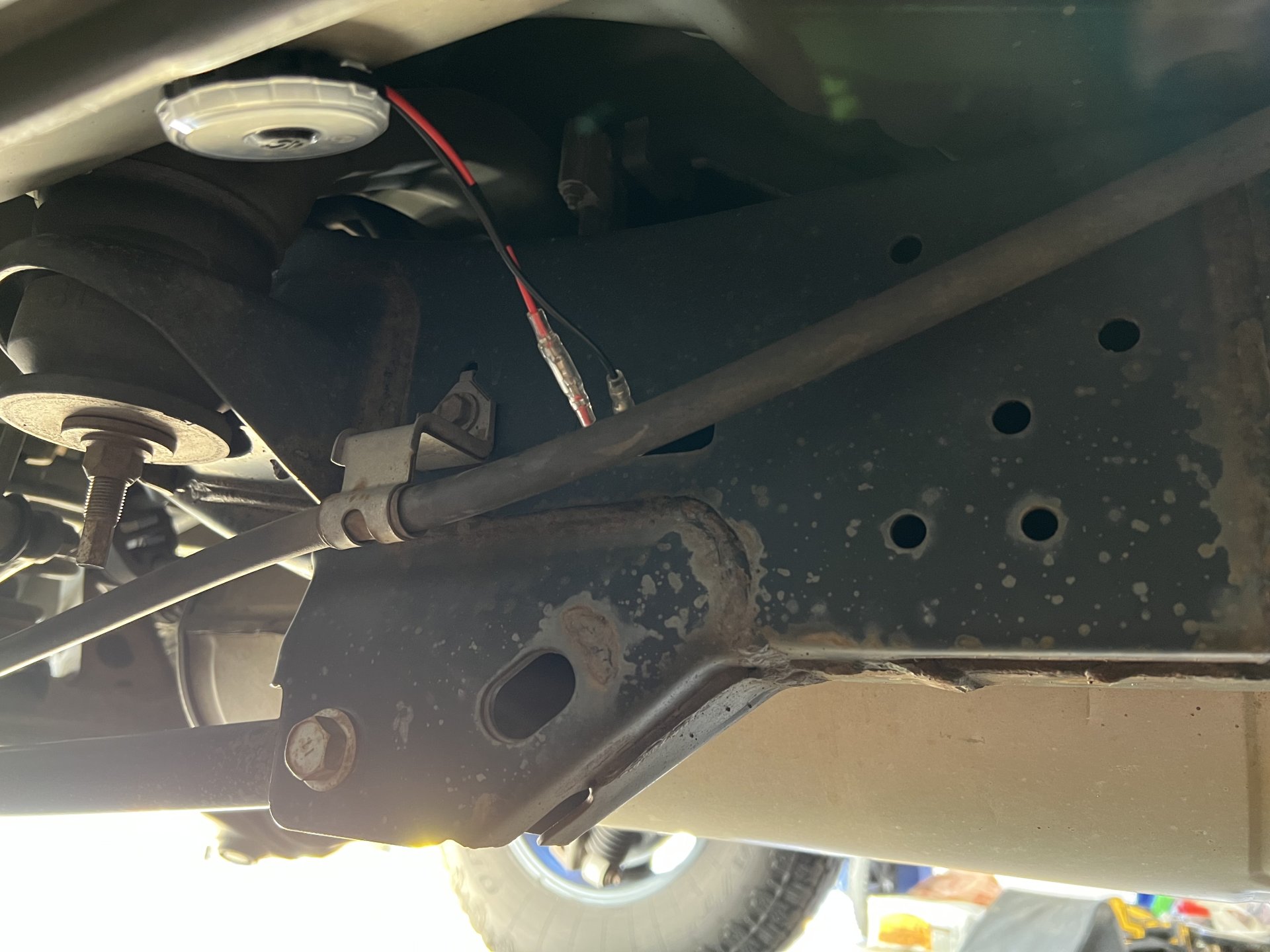

Finally got mine wired up over the weekend and am having issues with it.
The lights only turn off if I double lock the doors, or seem to time out after about 15 min if I open a door or unlock the doors and don’t relock them. They don’t turn off when I start driving so I had to pull over this morning and unplug them.
Doing some searching it sounds like others have had the same issue:
One thing to explore is I wired them in parallel, possibly lower resistance could have some some impact? I can try to wire in series and see if they even turn on.
I also touched the leads together accidently testing the lights which popped the dome light fuse. Replaced the fuse and everything works again but hopefully I didn’t screw something up.

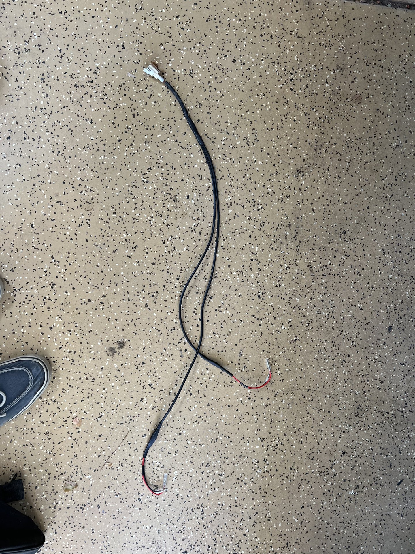

Definitely watching for a go at adding a switch to these. I used the factory harness and 194s and just beat the factory light mounts into a new shape and bolted them to the step holes. Free. But a switch would be perfect.

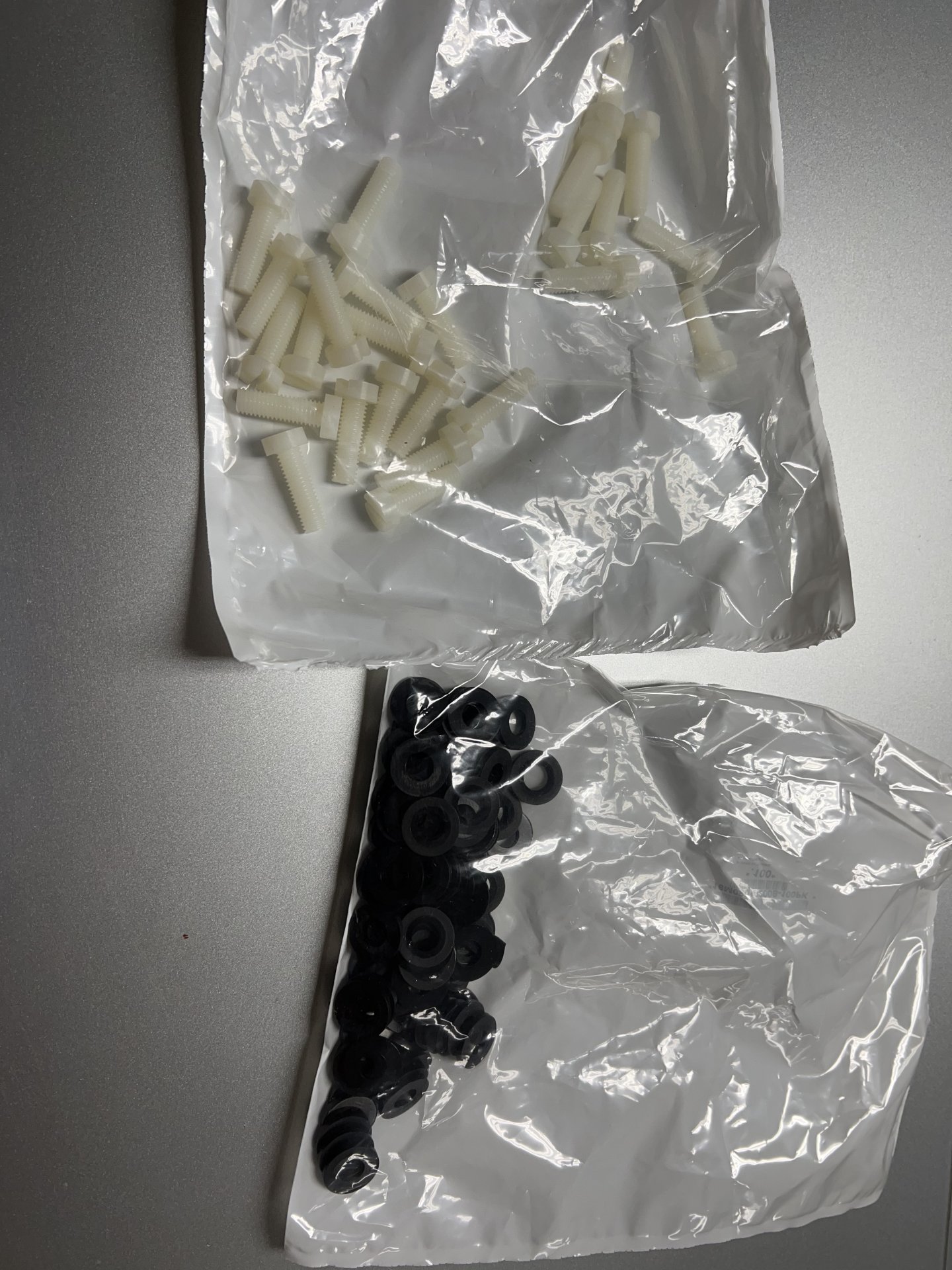

I did some testing last weekend by wiring up a jumper to go from the positive of one light to the negative of the next, wiring the two lights in series. Only one of the two lights would turn on which was making me think maybe they had too much resistance. Scratching my head and trying to think of a path forward I started unplugging everything when I realized the light was staying on with only the positive wire attached.
This is when I realized that the Cyclone was grounded through its aluminum housing. Recall that this circuit is switched via the ground, with the light constantly grounded it won’t turn off. I ordered some nylon M8 bolts and washers from McMaster to,replace the stainless hardware I originally used, isolating the light from the body so it’s no longer grounded. Now everything works as intended, even gradually fading on and off the same as the factory lights did.

Dug around this thread trying to find this connector and ultimately had to search "2-pin toyota waterproof connector and look around at pics in google til i stumbled upon it. And, you of all preople will appreciate this the most, final hurdle is that the connector isnt readily available and listings give little indication what youre actually getting (none mention terminals included, in particular). I ordered a pair from a japanese parts house to see what I get in a few weeks, only other option is dealership inventory crapshoot.
