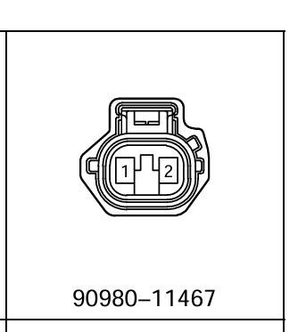

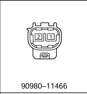

2 years later, but I think I found the connectors for the OEM wire harness that plugs into the running board lights as I plan to use the OEM connectors for some lights on Slee sliders
Female connector from the OEM wiring harness on the steps
Male connector that attaches to the running board lamp bulb
Just incase anyone ends up searching this post in the future.
Posting a correction, female part that is attached to the OEM step harness is part #90980-11162.
The male connector that plugs into the OEM harness is part #90980-11168.
