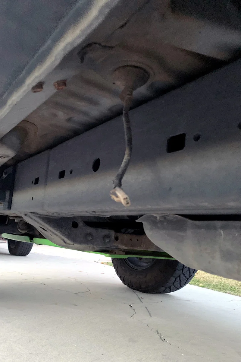

The PO removed the running boards and left the step lights wire connector in place:

At first, I was intent on re-using that hanging connector. However, it was taking me too long to figure out the connector needed to tap into the hanging connector. Since I had to create the rest of the wiring harness, I decided to cut the connector and use heat shrink connectors to connect to custom wiring harness I'm going to make.
I'll leave the picture of this diagram to see if anyone can figure out that hanging connector type. I could not read any part numbers on the existing connectors. Either my eyes are going bad or the connectors are too faded to still show the part numbers. If anyone figures out the connector part numbers, please let me know and I'll post here. Found on this MegaZip site

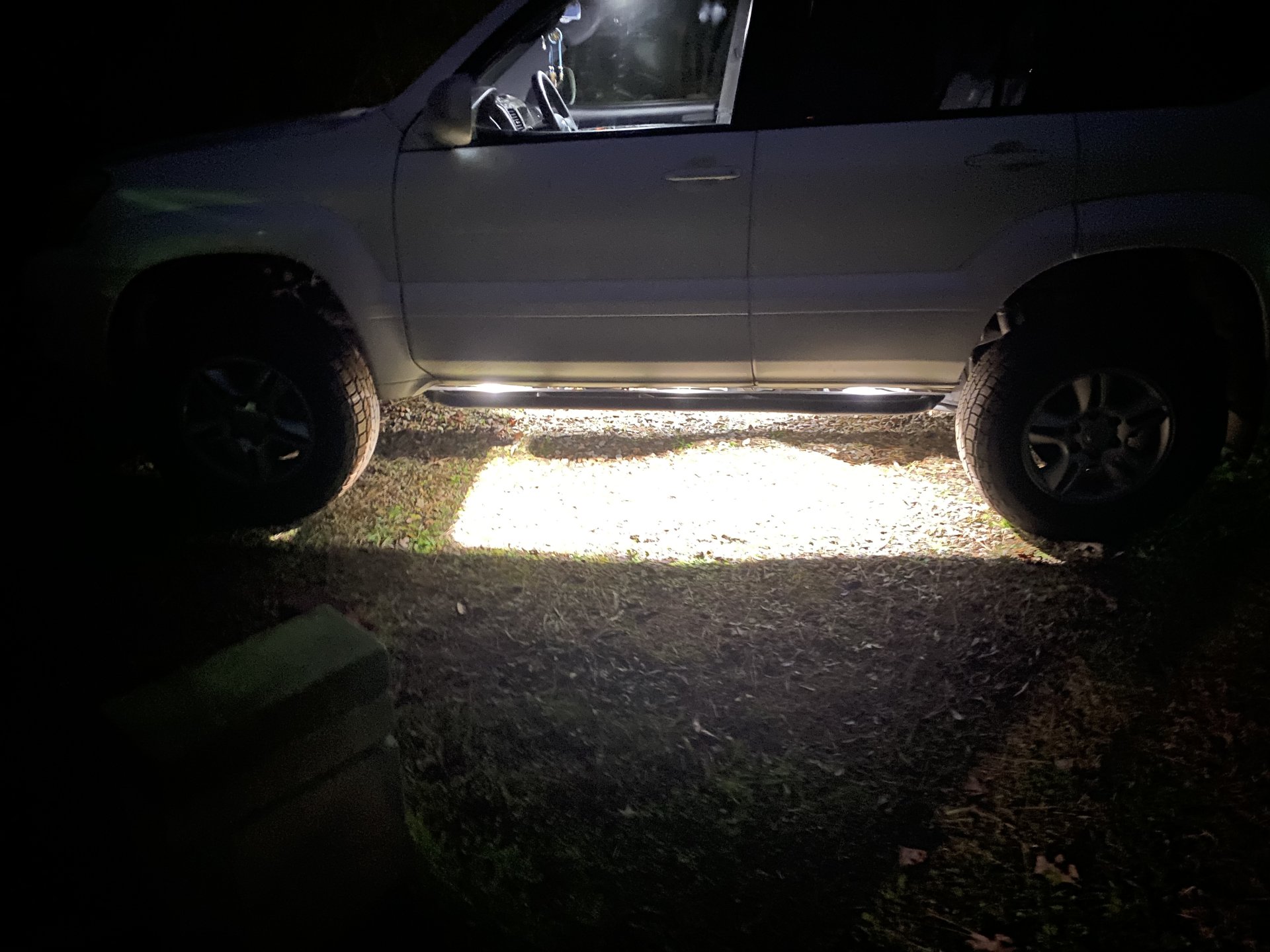

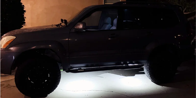

And here's how the lights look at night. This is just after two lights installed and no brackets. I had only completed the drivers side at this point and lights were hanging free. It looks brighter than after I added brackets.
And here's a photo with both sides completed with brackets.

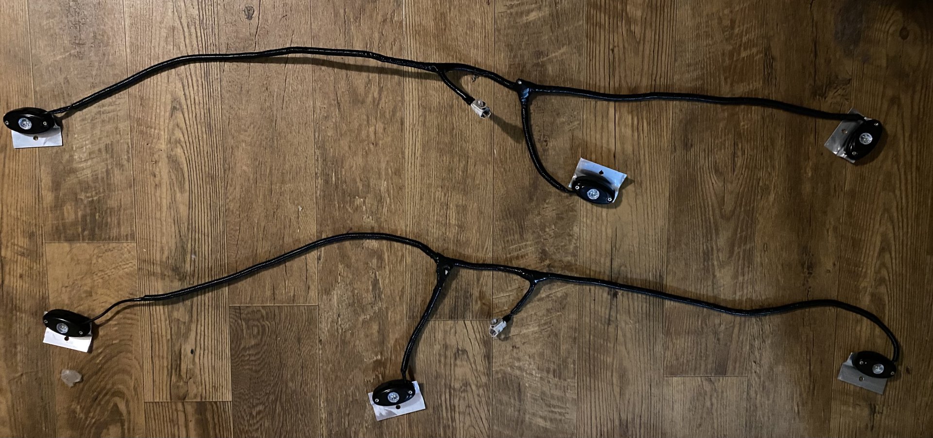

I used the stock wiring harness from my running boards, but cleaned it up a lot.
  • Trimmed off the lights at either end of each harness, and did not keep those plugs
  • Peeled off the old electrical tape or w/e was wrapped around the plastic conduit
  • Shortened the harness a bit (I think mine is 51.5” end to end)
  • Soldered rock lights to both ends. The lights I used had wires attached already. So it was easy to just solder and add heat shrink + electrical tape
  • Used a t-tap to connect a third rock light right around the mid point of each harness
  • Wrapped all of the soldered areas in electrical tape
  • Put the plastic conduit back on, and re-wrapped the entire harness in electrical tape

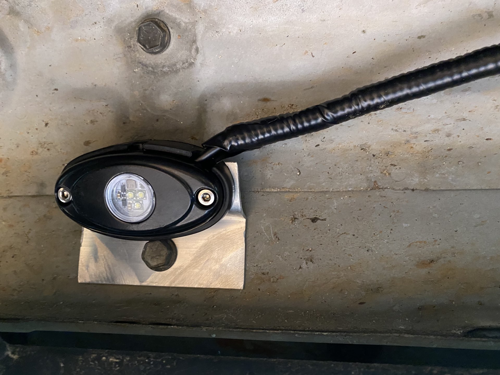

My brackets certainly aren’t pretty. I’d like to try and design some in a cad program, and 3D print them, but it’s not too high on my priority list.
I just used some aluminum T bar, cut into sections about 3” long (just enough to fit the light). Then bent from the 90 degree angle out more, probably between 135 and 180.
I used the bolts and bolt holes where the large L-brackets held the OEM side steps to attach the brackets. Then zip tied the wire harness up and out of the way.
Pictures below.
Bracket mounted

Wiring harness

You actually modified the existing step wire harness. I’m missing that portion of the wire harness and I’m trying to make one with the wires that come with the rock lights, plus the correct female connector to attach to the existing hanging wire I showed in my photo.
Any close ups of the female connector in your photo of the step wire harness?

Got it. I wanted to create a plug-and-play solution with heat shrink wire connectors and use the factory oem wire connector that's hanging. If I can't figure out how to do that, then I will have to cut that hanging wire connector and use connectors like @binaryaudax mentioned.
I did find the part number for my missing wire harness for the step lights:
(82157A) Lexus 82157-60010 Wire, Step Panel, RH
(82158A) Lexus 82158-60010 Wire, Step Panel, LH
These are the wire harnesses that get thrown away when you delete the stock oem running boards.
As of this post, the new price for each oem step lights wire harness is between $50 each to $67 each plus tax and shipping.
I just need to figure out the part number for the wire connector....and I couldn’t ready any numbers on my existing connectors.

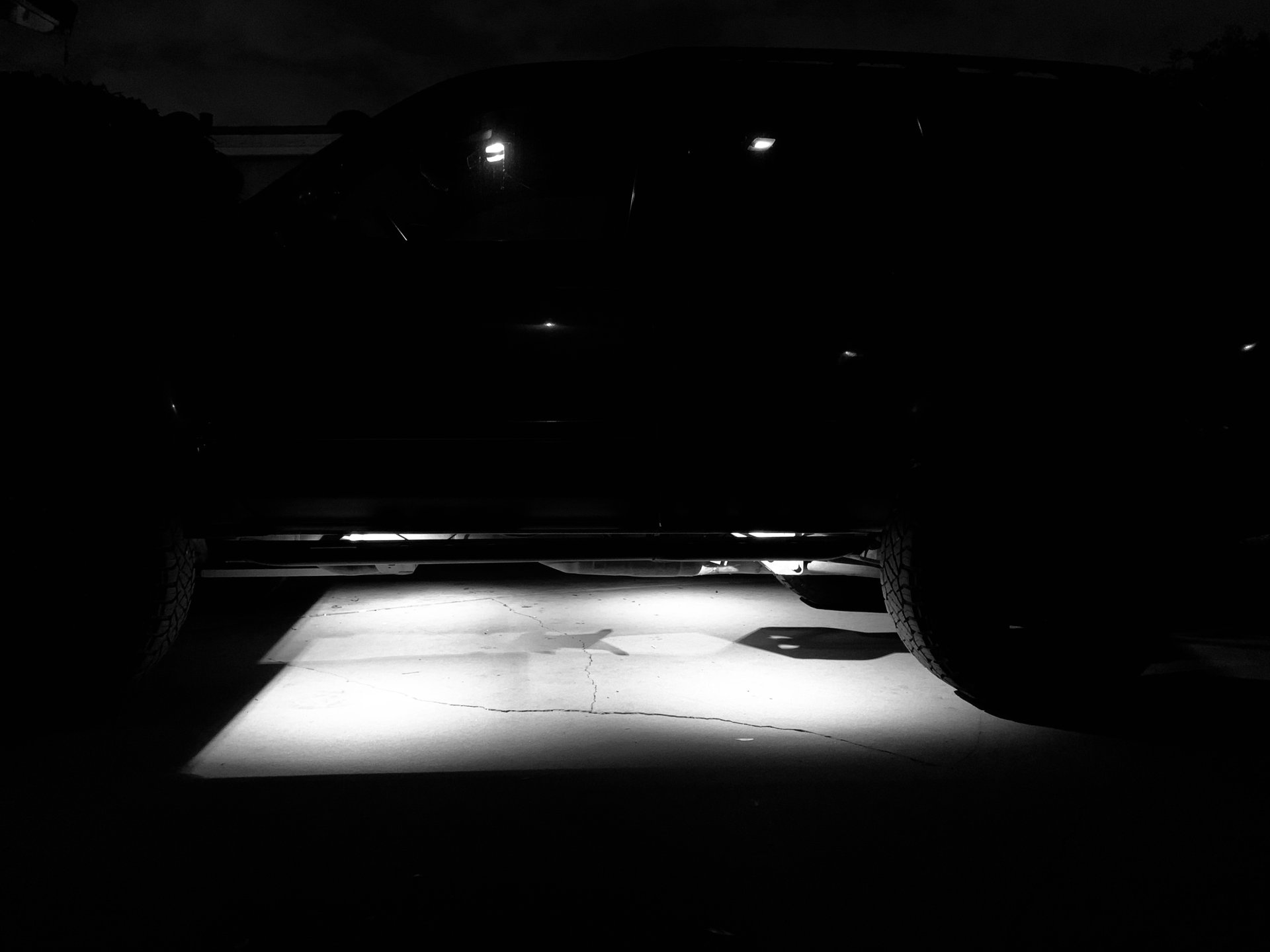

Pics after install!
