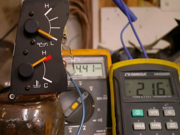

Ok got the 110 ohm resistor and diode bypass jumper/shunt installed and cooked,
RavenTai said:
Ok figured out Thevenin Equivalents as it applies to this circuit (I think) and did one calculation (takes a wile) on paper replacing the 75Ω resistor with a 110Ω resistor gets a 198°F "center" as above and at 226°F gets .3678 volt drop across L1, That is equivalent to the current 235°F position, or about the 3/4 mark.
Not even close, 226 wound up almost pegged, so apparently I need to do some work on trying to predict needle position besides center. This is good as that math went against everything else, now diode replacement resistors can be used to further get it where we want it. If 226 had come up low on the gauge we would be stuck with it with no adjustments
RavenTai said:
on paper these following resistors should center the gauge at....
110Ω....198°
Nope, center wound up around 188 (center found by eyeball not volt meter) Rick unless you are operating @ 188F your gauge may read above center with the 110 ohm resistor.
The rest
Pegged hot 230
Top of red 216
Bottom of red 209
Center 188
Cold line 165
Pegged cold no data

Well I don’t know, the Fluke Meter wound up watching source voltage for this cook, needle position per volt drop across L1 should be somewhat constant. (There is that S word again)

some pics from the last cook. volt memter is showing source voltage, the 1 is hidden.
but you don't want to have it in the red at 210 already, right? or do you?

yes, you are correct that the cook result is way off expectation on gauge response. We are shooting for 226 at the start of red.
