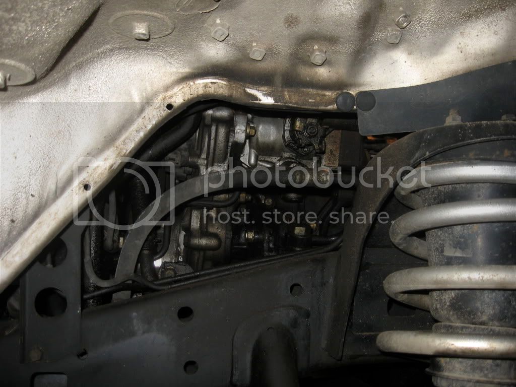

The truck is in getting a makeover so I finally got around to removing the ACSD. It was easier then I thought it was going to be. I am in the middle of a front axle rebuild so I did it all from in the wheel well. So here is a little right up on how I did it.
I picked up the plate and o-ring at a local injection shop for 5 bucks. I had the parts numbers but none of them seemed to work. I just described what I wanted and they knew what I was talking about. Got about a foot of 3/8 coolant hose and some clamps and I was ready.
The Start:
First I took off the bottom line of ACSD, Took the clamp off and then I cut the line to get it off. I had the new hose ready to put on so it didn't make too much of a mess.
Next I did the same to the top line:
Then I remove the ACSD: 3 bolts.....
This one was a bit tricky:
If this bolt didn't strip I would have had it all done in 45 min. grinding it out....... :bang:
Finished... :clap:
Now I feel much better. Now I just need to finish everything else………….:rolleyes:
I know this has been done before but maybe this will help someone.
Cheers
