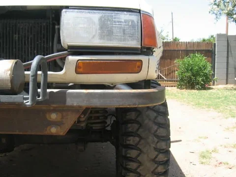

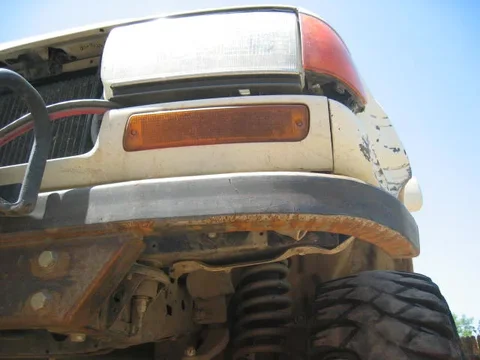

A long time ago someone found that some manufacturers' dryers are shorter. I visited several parts stores and found one that was at least an inch shorter. Then I simply twisted the dryer at a 45 degree angle and mounted it with one screw in the original position and the other in a factory welded nut that happened to correspond with the dryer's new position. Bending the lines was a bit nerve wracking, but it worked perfectly and the dryer is above the lower part of the core support and out of the rocks. Even with my minimalist bumper, the dryer hardly shows at all, which was the whole point. :D

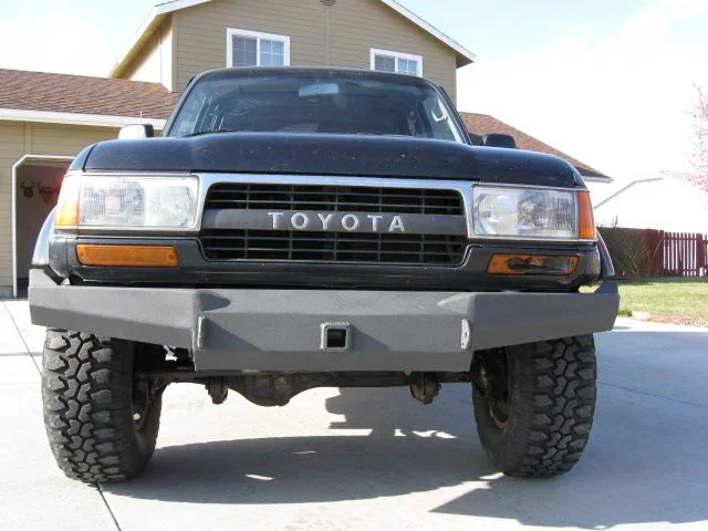

My dryer sits behind this bumper. I loosened the strap that holds it in place. Then I worked it upword. Both lines can be managed without problems. Just take your time and don't kink them. Once I had it where I wanted it I cut off the extra part of the cradle that was still hanging down. I raised it to the point that I can just bairly get the turn lamp in place. I also had to trim some of the plastic on the back of the turn lamp to clear where the lines go in the dryer. These cuts did not go through to the inside of the lamp. You can just see the dryer under the turn. Yea, in a collision the dryer is still toast. But, It's up out of the way and minor offroading bumps and hits it should be fine. Hope this helps.
