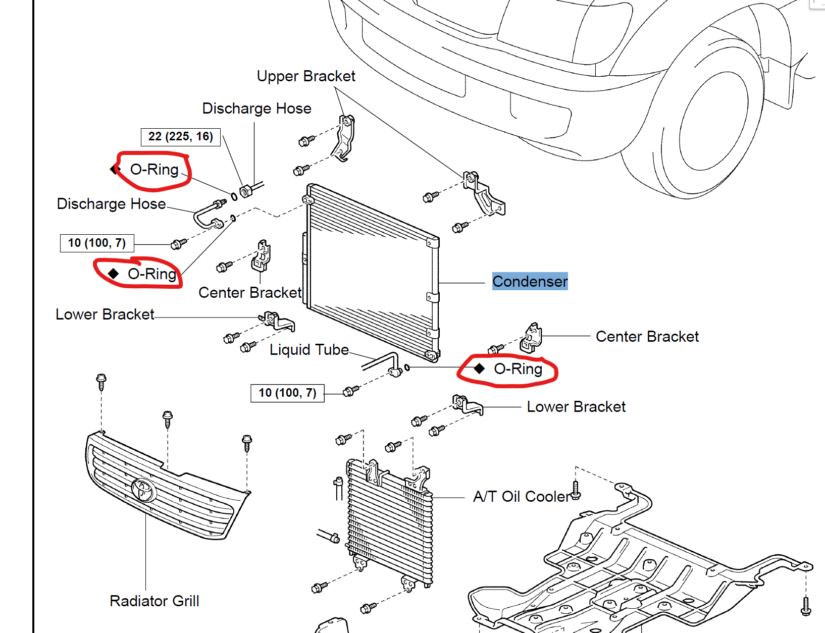

Okay, so trying to get all the other things I need. I think I need the three o-rings in this diagram. Do I need dealer specific o-rings? Or can I get any kind? I read something about green o-rings for A/C or something? Also in this video the guy mentions new seals... I assume he's just talking about the o-rings and not some other seal between the hardline and the condensor?
What is the source of this diagram?
Back in Business.

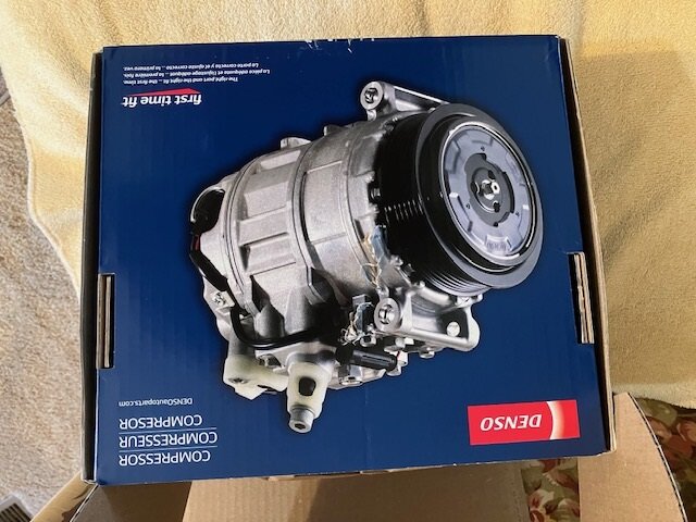

Did you buy the Denso compressor from Amazon? I got it (haven't installed yet) but the box was kinda beat up and the packaging was pretty lame. Just some brown paper rolled around it. Wondering if I should return it.
Rock Auto for mine. Too many 'fake' products on Amazon/Ebay.
Changing out the compressor (because of location) is no picnic. Don't want to be doing it again for a long, long time.
Just make sure its genuine and you should be good.

Here’s mine for reference from Amazon. Looks legit. But the box is best to hell and the pulley has a gouge in it.

Agreed, looks legit. Shipping company just played hockey with it.
'Ding' in the pulley can be removed with a file, no big deal.
How durable are these compressors? Just wondering if I should return it and get one from Rock Auto.
Very rugged.....but you'd certainly have a good reason to return if you choose to go that route.
I went ahead and returned it. I'm gonna try RockAuto. I wish I could buy it locally so I could look at the box/item first. I mean I can, but the compressors are $500+ special order at AutoZone and Advanced.
