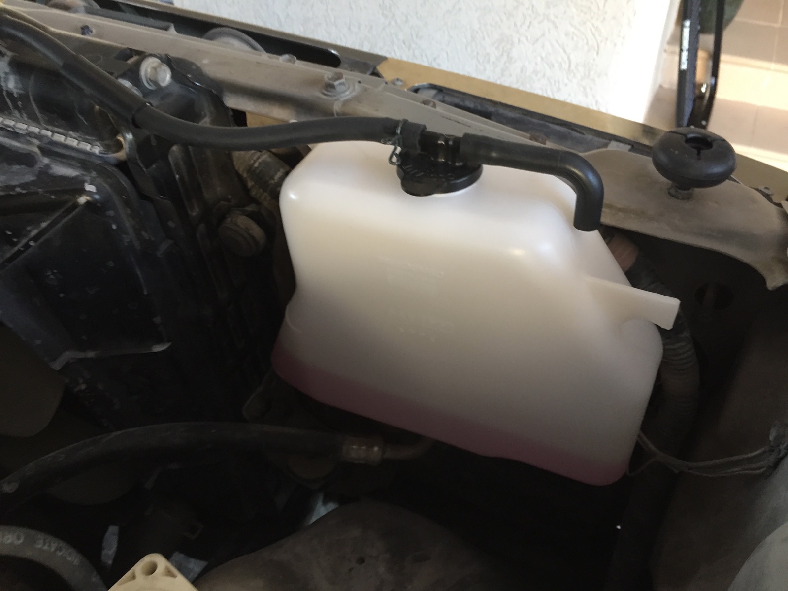

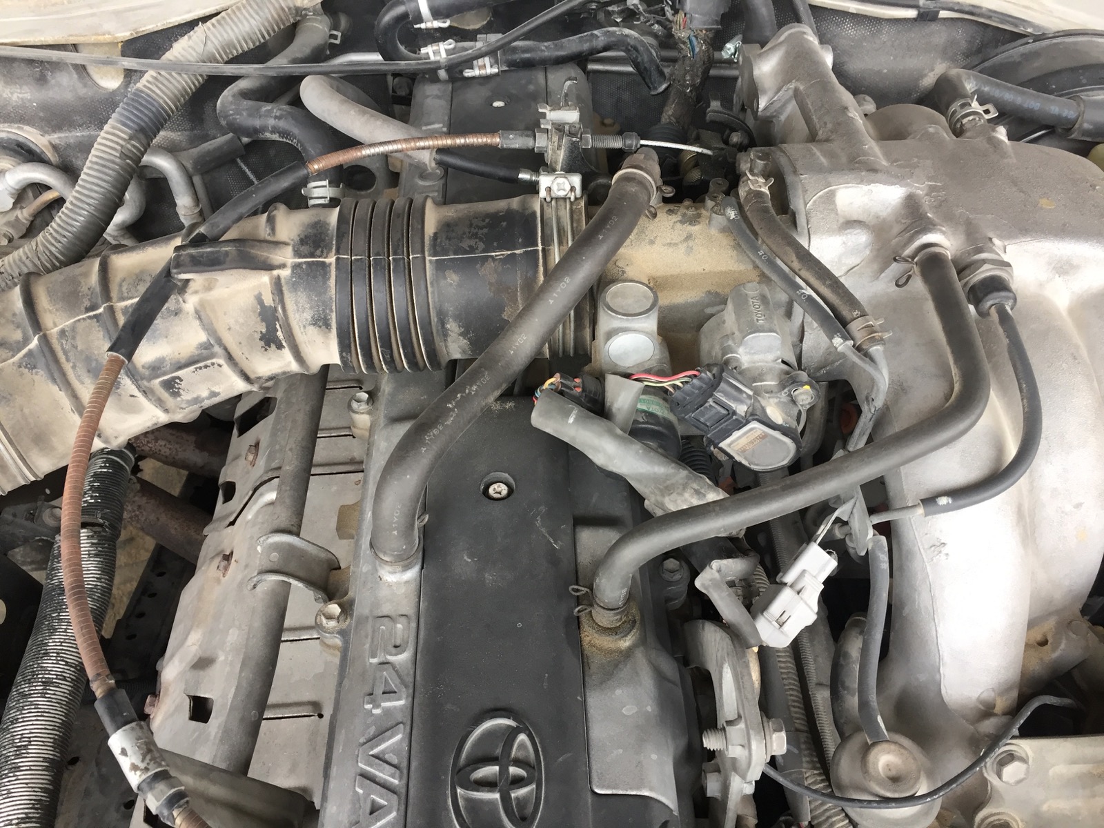

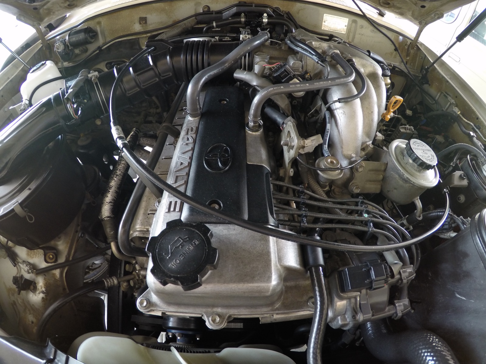

Prior to toasting that con-rod bearing I had been lamenting to my wife that I felt like I'd given over too much of the vehicle's oversight to the shop I have do the work here. Since it's cheaper to send it to a shop, and I've found a great shop here, I'd let my grasp of the vehicle's needs slip a bit. Following the engine rebuild I've resolved to completely reverse course on that issue.
They vacuum hoses were aged, a few were cracking, and I thought I heard a vacuum leak noise now and then.

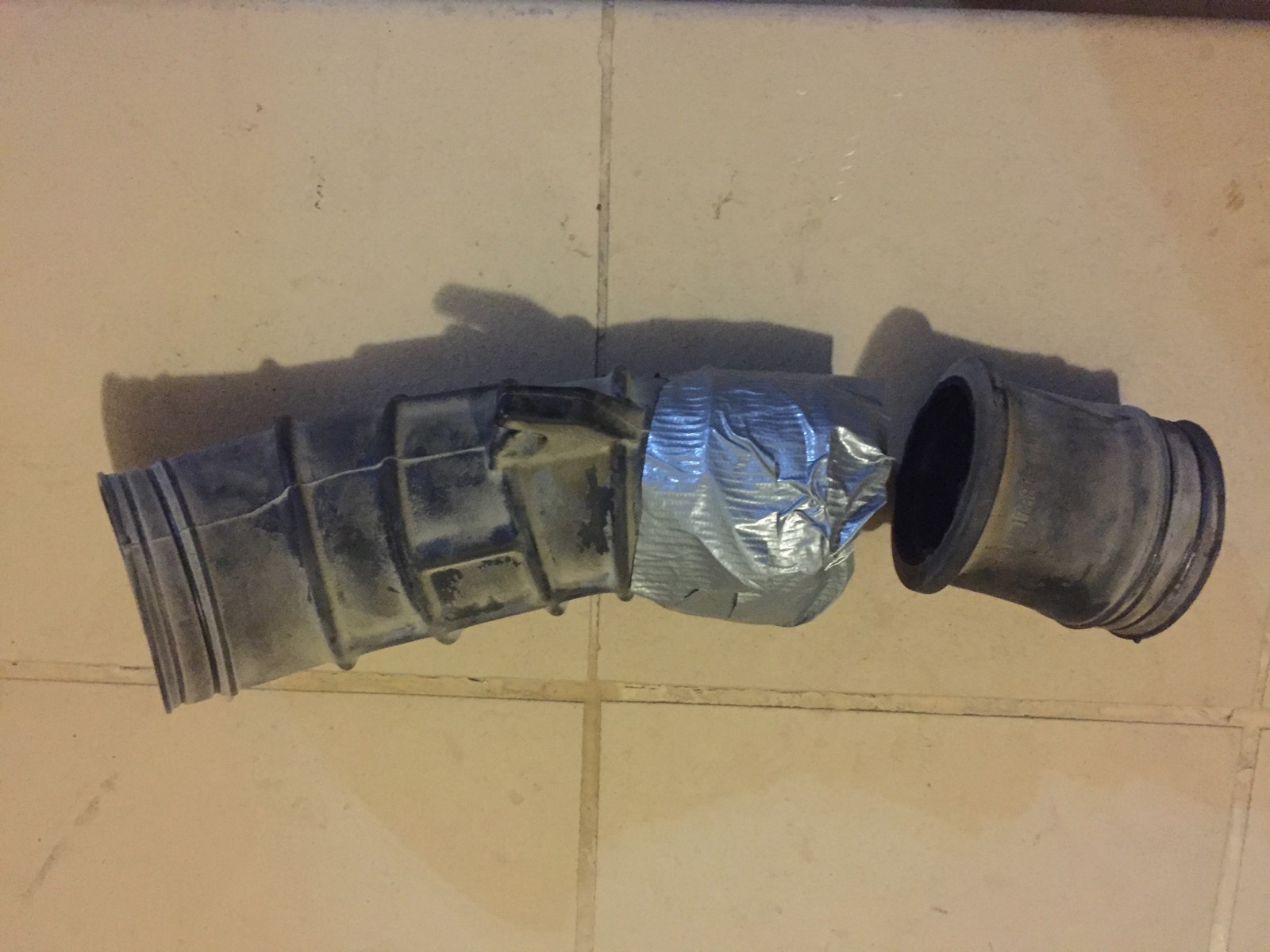

While futzing about I managed to break the air intake hose... so that went on the list.
As well as the hood bumpers.
And a new overflow bottle as the old one was brittle and the hose getting rundown.
I also replaced the throttle cable, distributor cap, and distributor rotor while I was in there.
Then I had the shop clean the whole engine bay up for me.
Next up is redoing some of the wiring harness where the loom/tape is old and crusty.

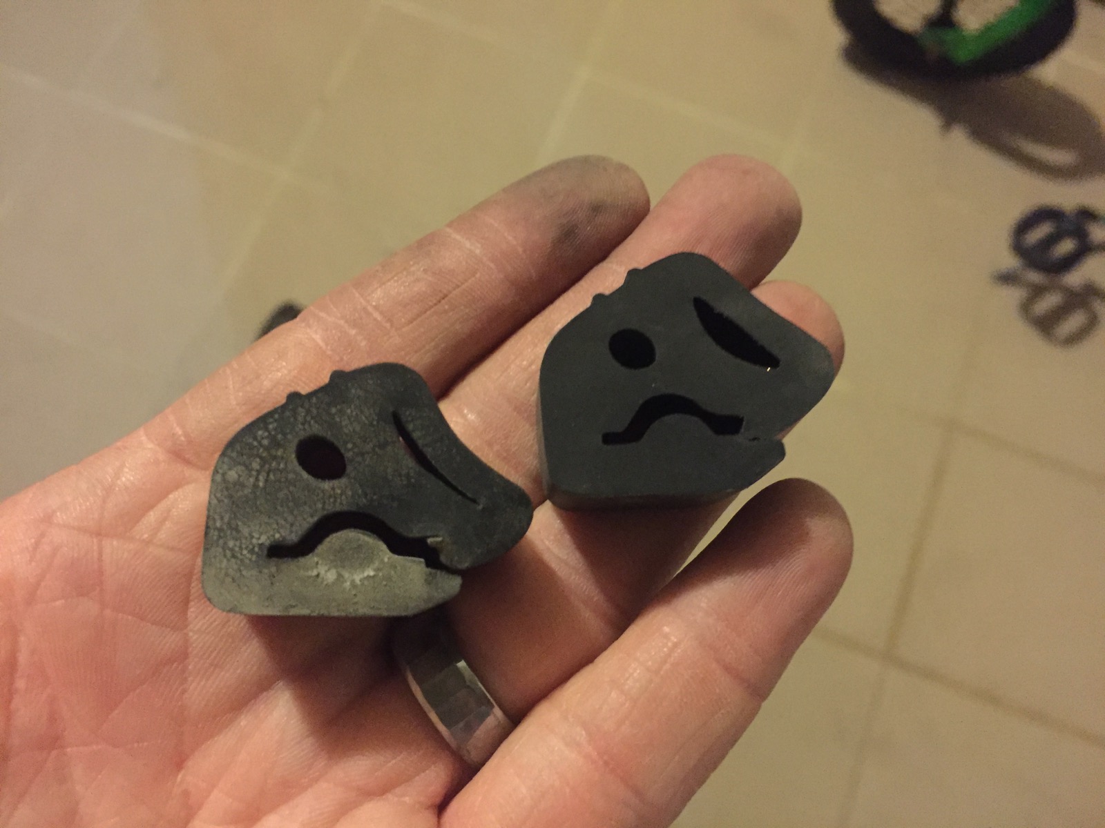

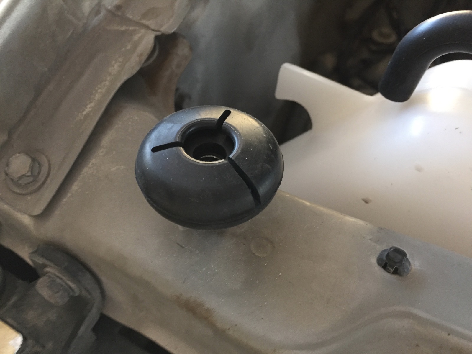

Nice rig, looks much better without that mickey-mouse grill, would you by any chance remember the part number for the round hood bumpers ? Thanks.
Yeah, so glad I ganked that hunk-o-junk!
Part number is 53382-60011

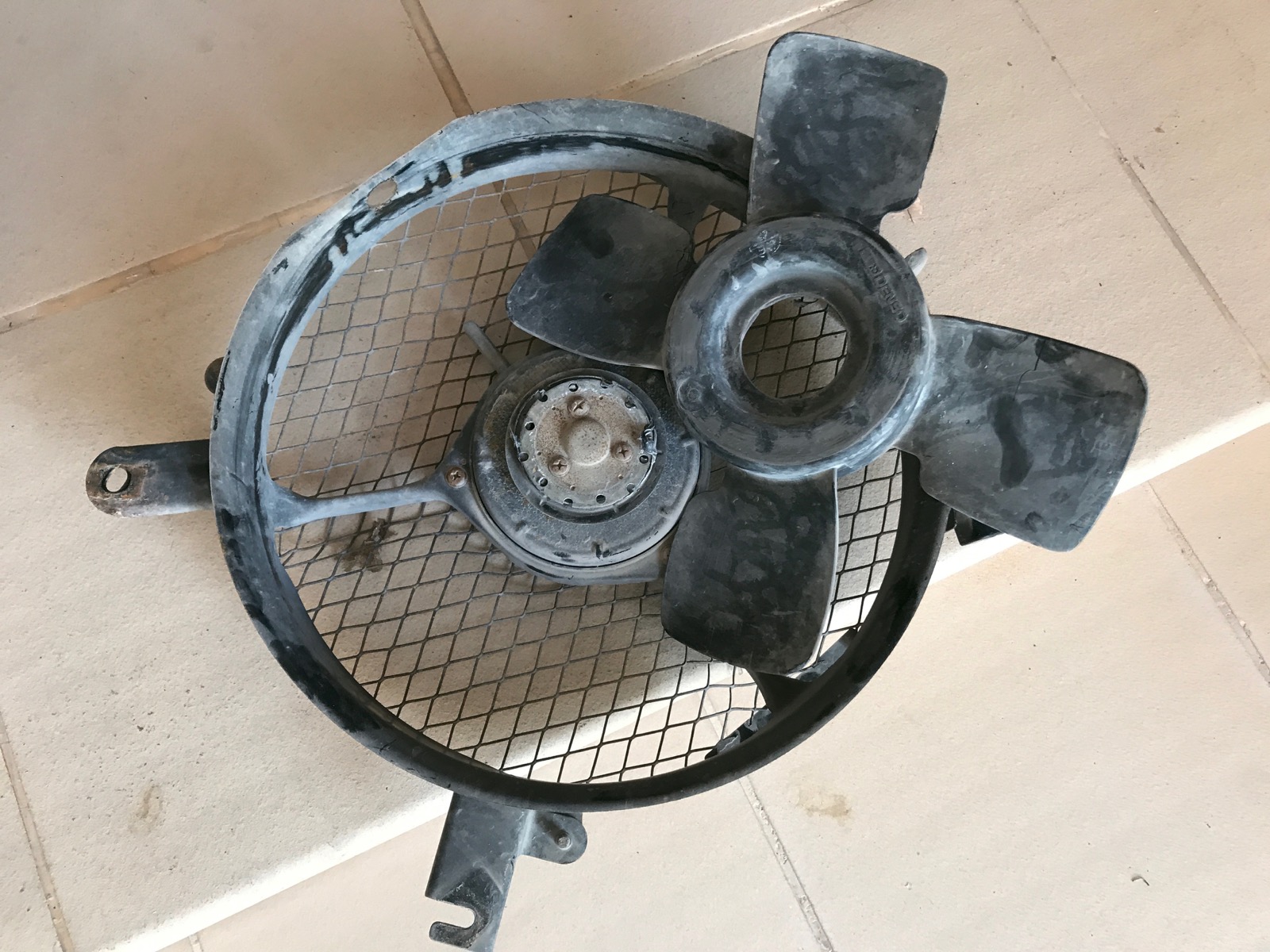

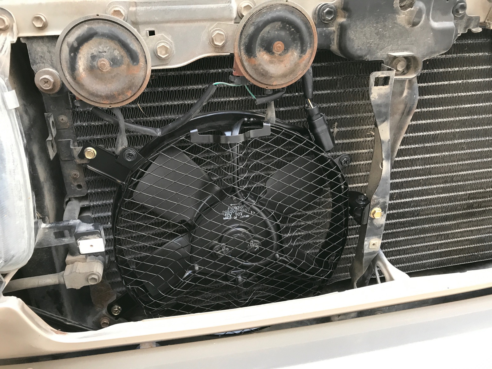

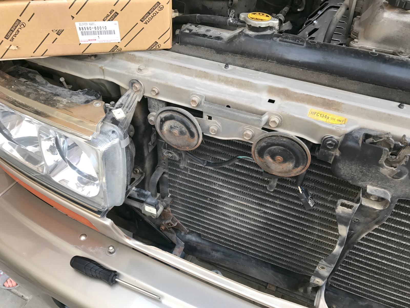

The electric auxiliary fan was toast...
So I snagged a new one and took care of that.

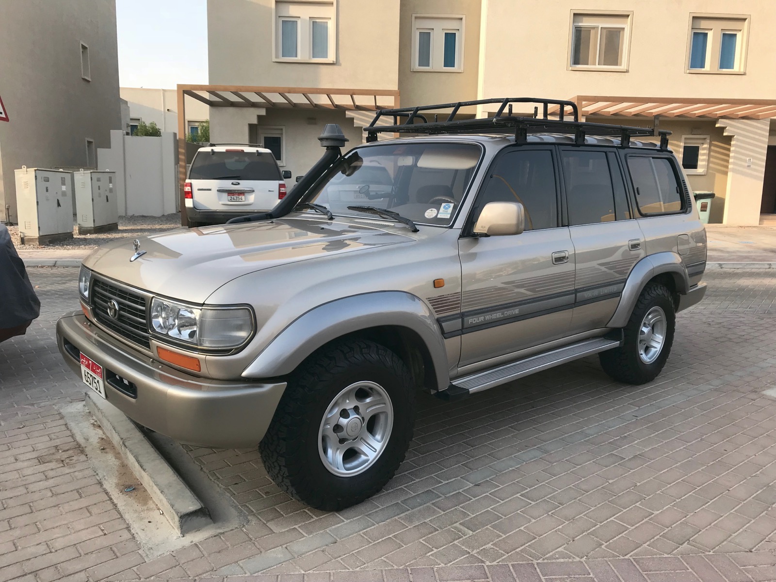

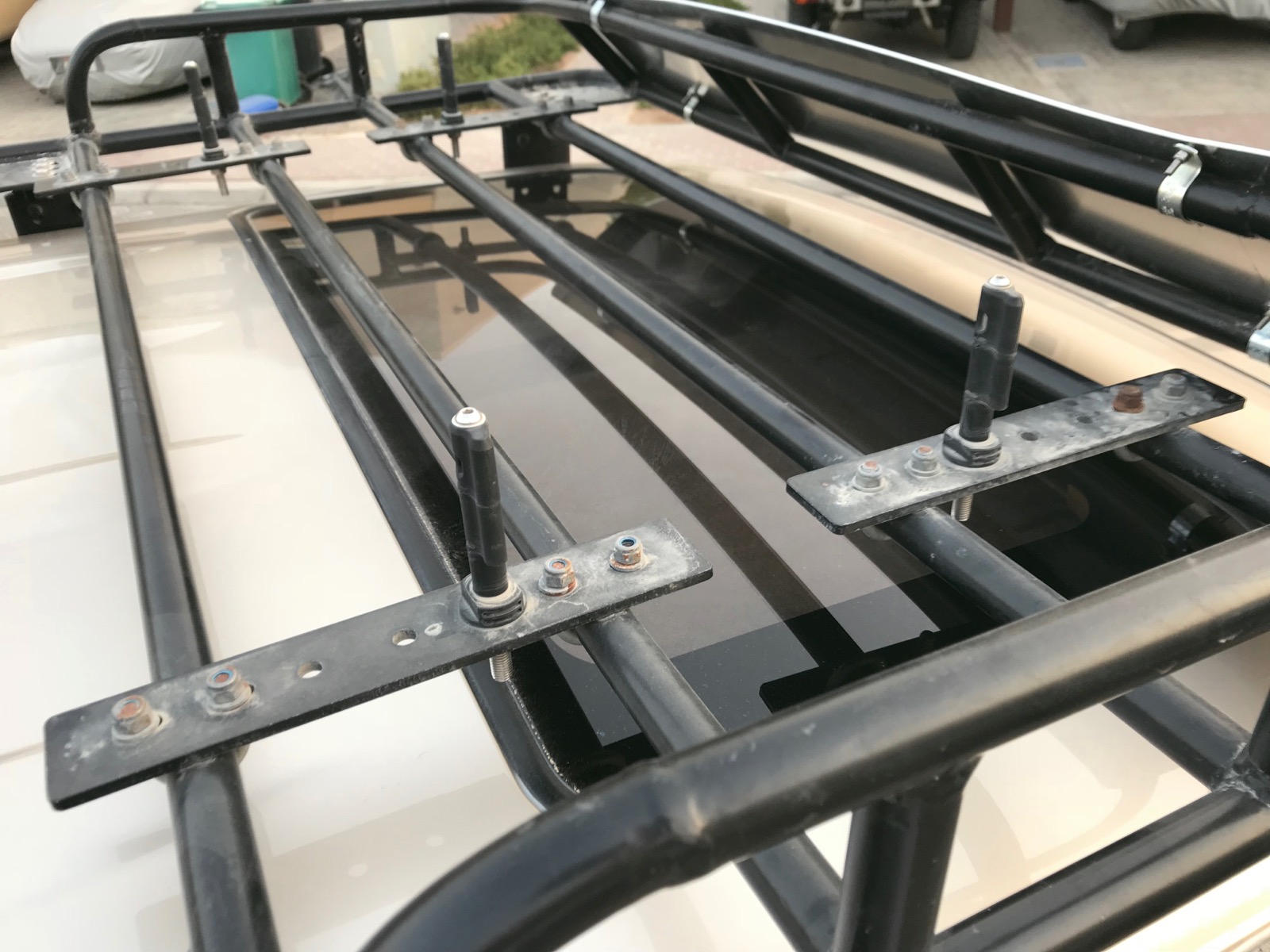

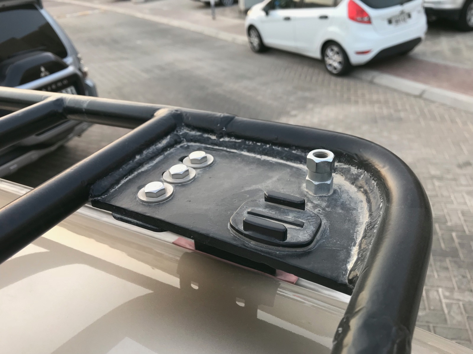

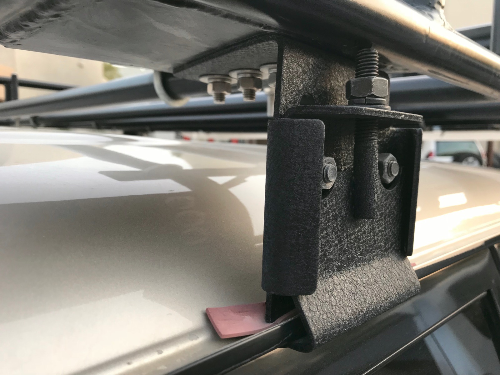

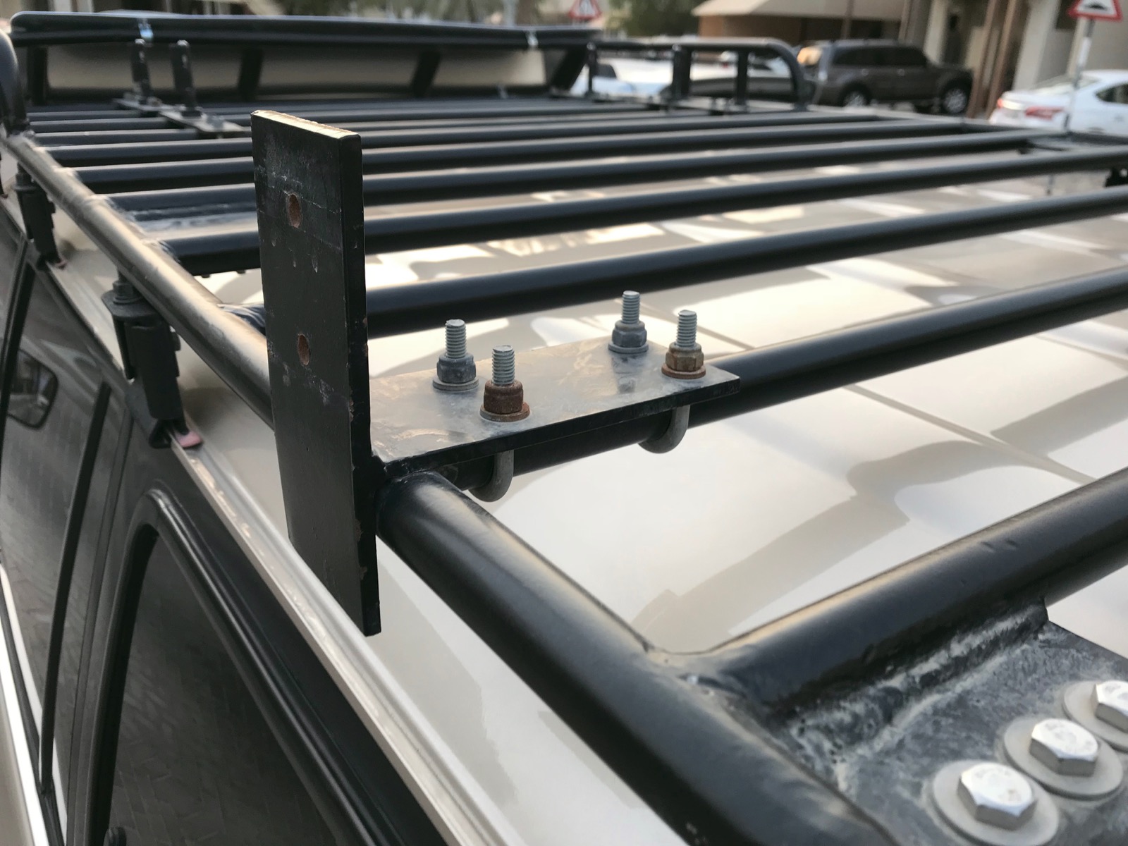

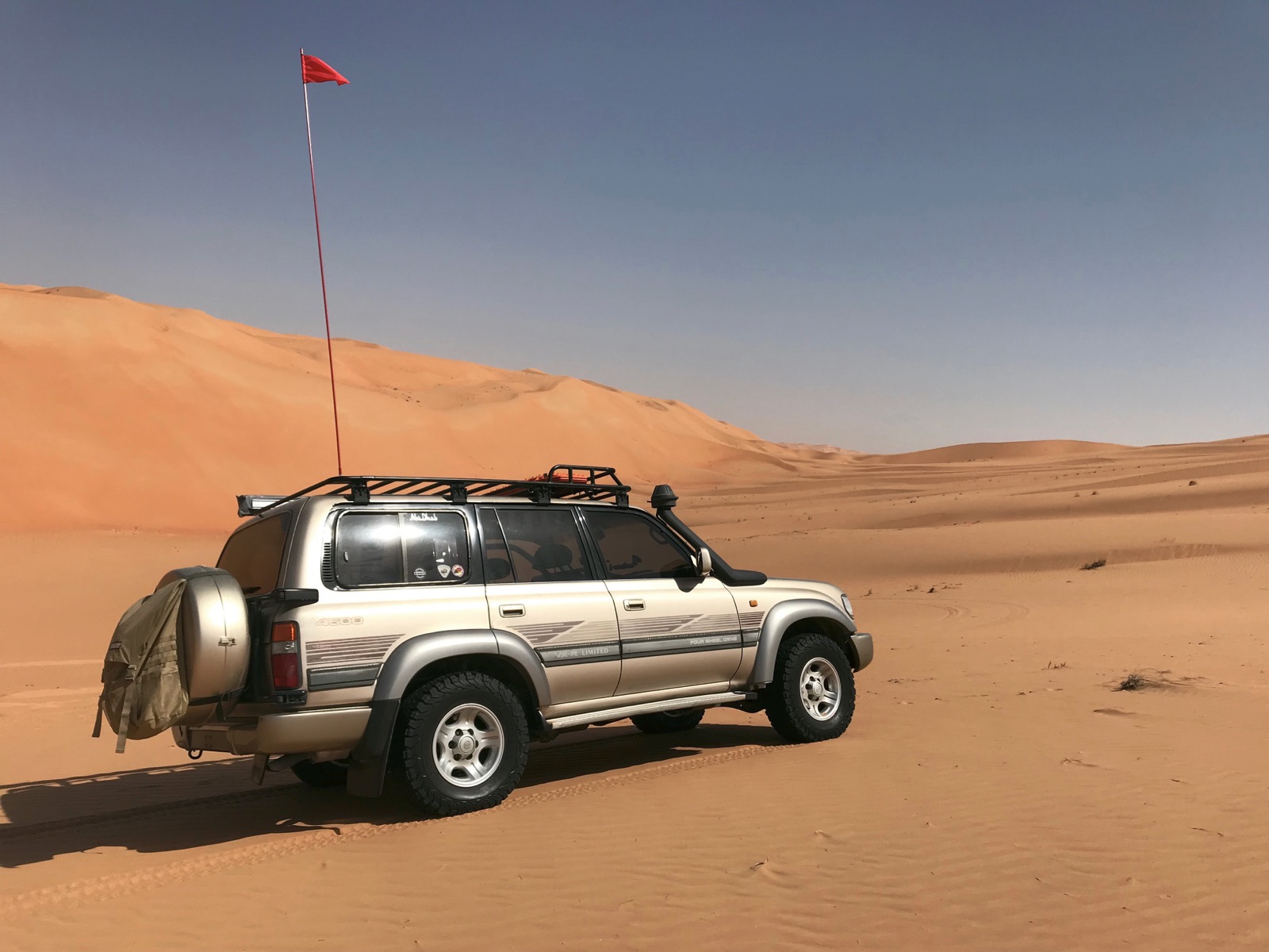

Also designed a roof rack and had it fabricated at a shop in the industrial area nearby.
GoPro mount and mounting point for my dune flag...
Maxtrax mounts...
It has worked out great for strapping down tents and camp chairs as well as mounting a shade awning (removed at the time I snagged the photos).

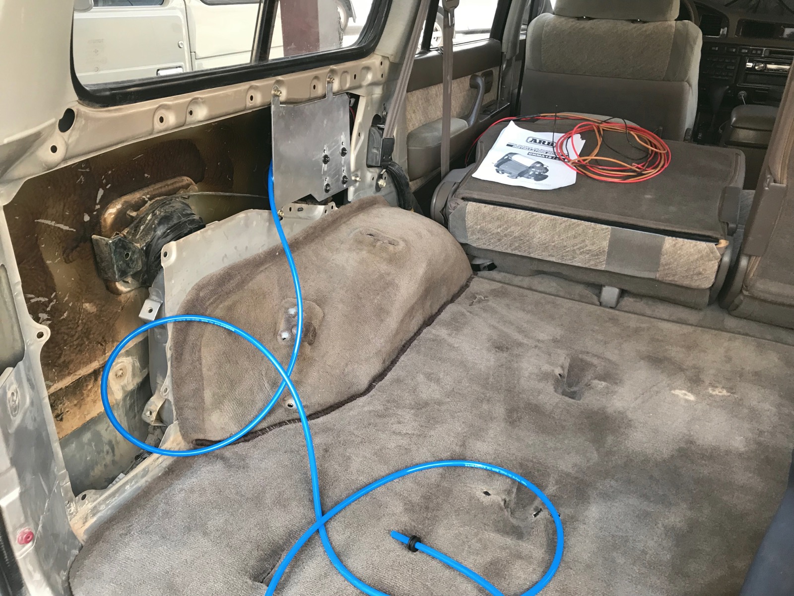

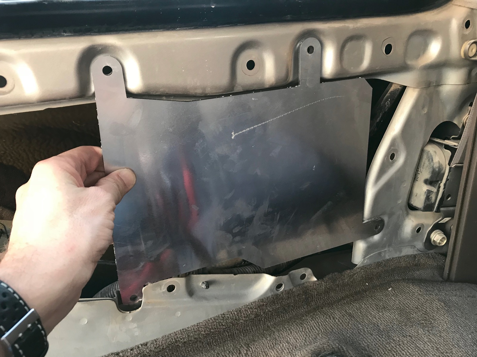

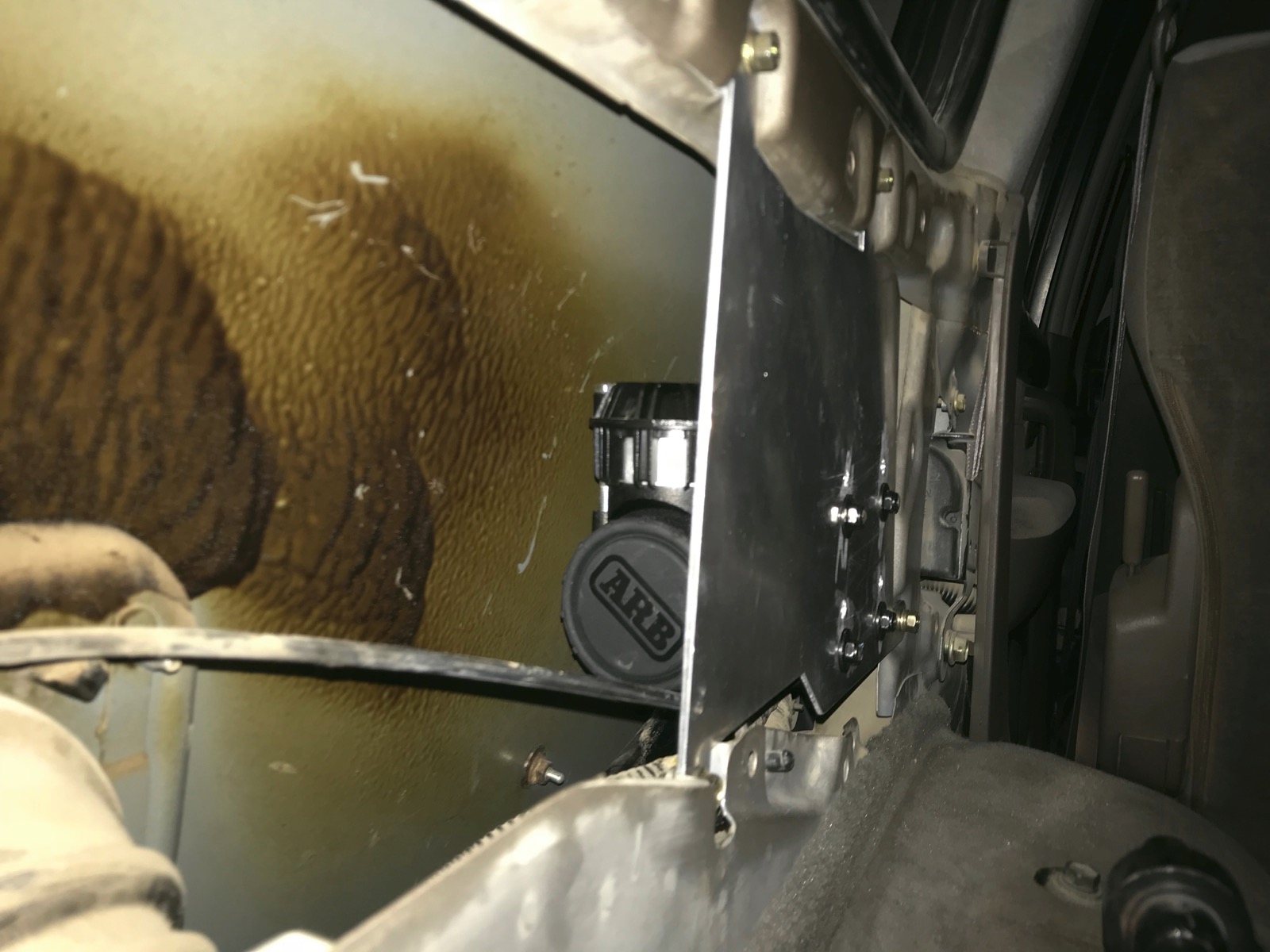

So with all the sand driving here in the UAE I do a lot of airing down... and airing back up... and I use a Bushranger Blackmax portable compressor to air up. But I'd managed a good deal on an ARB compressor and hose kit and wanted to have truly on-board air.
After some measuring designing I got a 4mm aluminum plate laser cut to fit in my rear-driver's-side fender well. It uses existing holes and bolts right in. (any interest in these?)
Got everything lined up...
Had a little help from the princess...

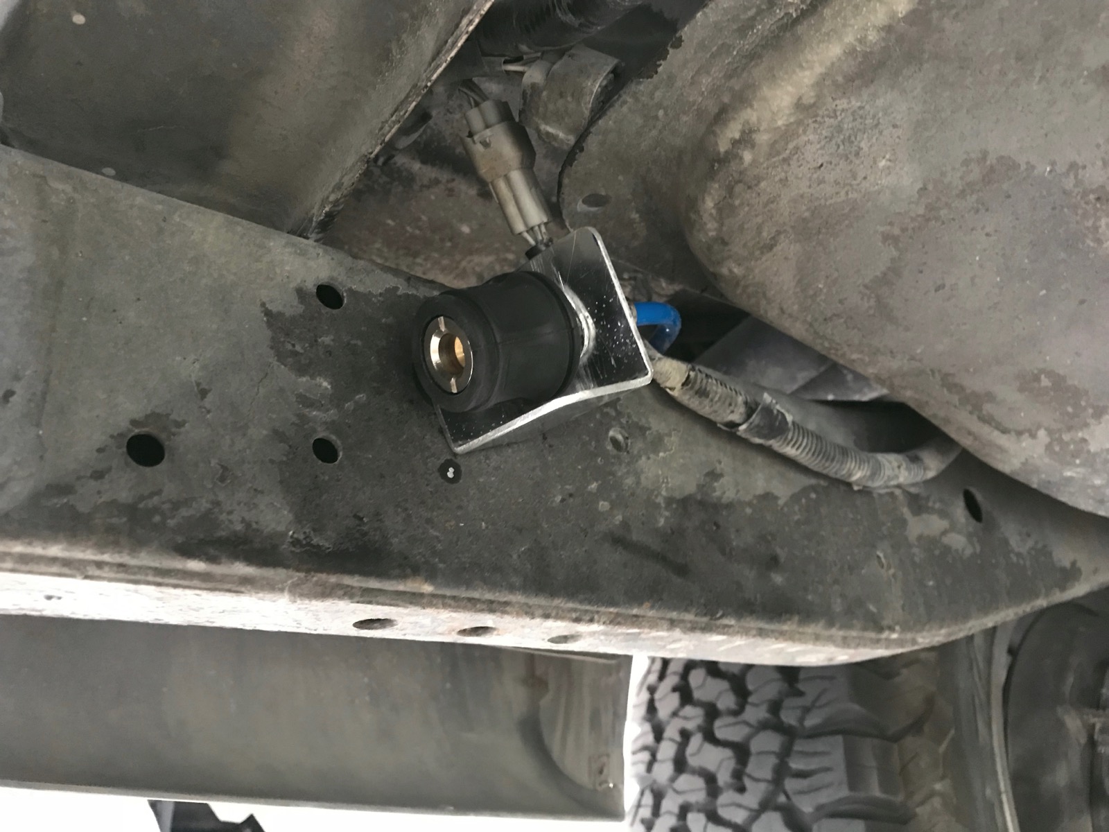

And mounted with an extension line that exits the fender well under the jack location...
...and connects to the ARB hose jack mounted on an aluminum bracket that is bolted into a factory captured nut on the frame.
And the switch is mounted in my nice accessory switch area.

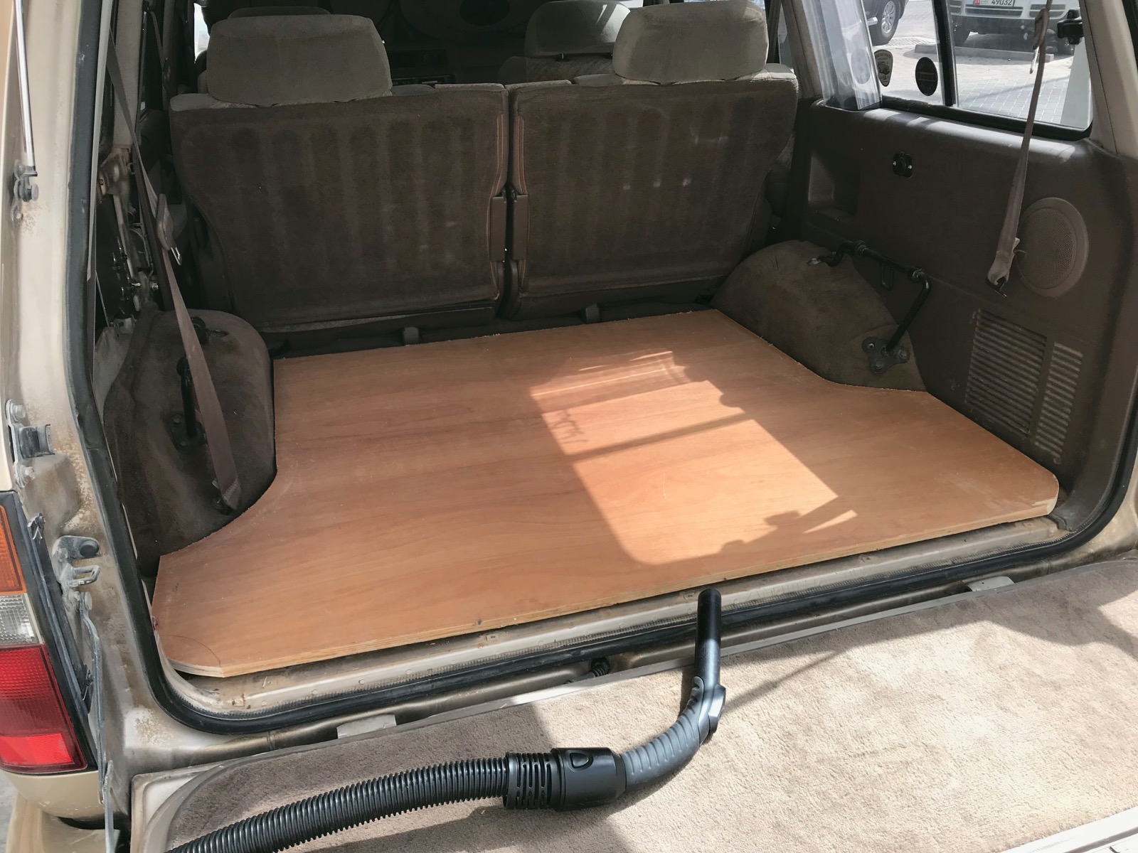

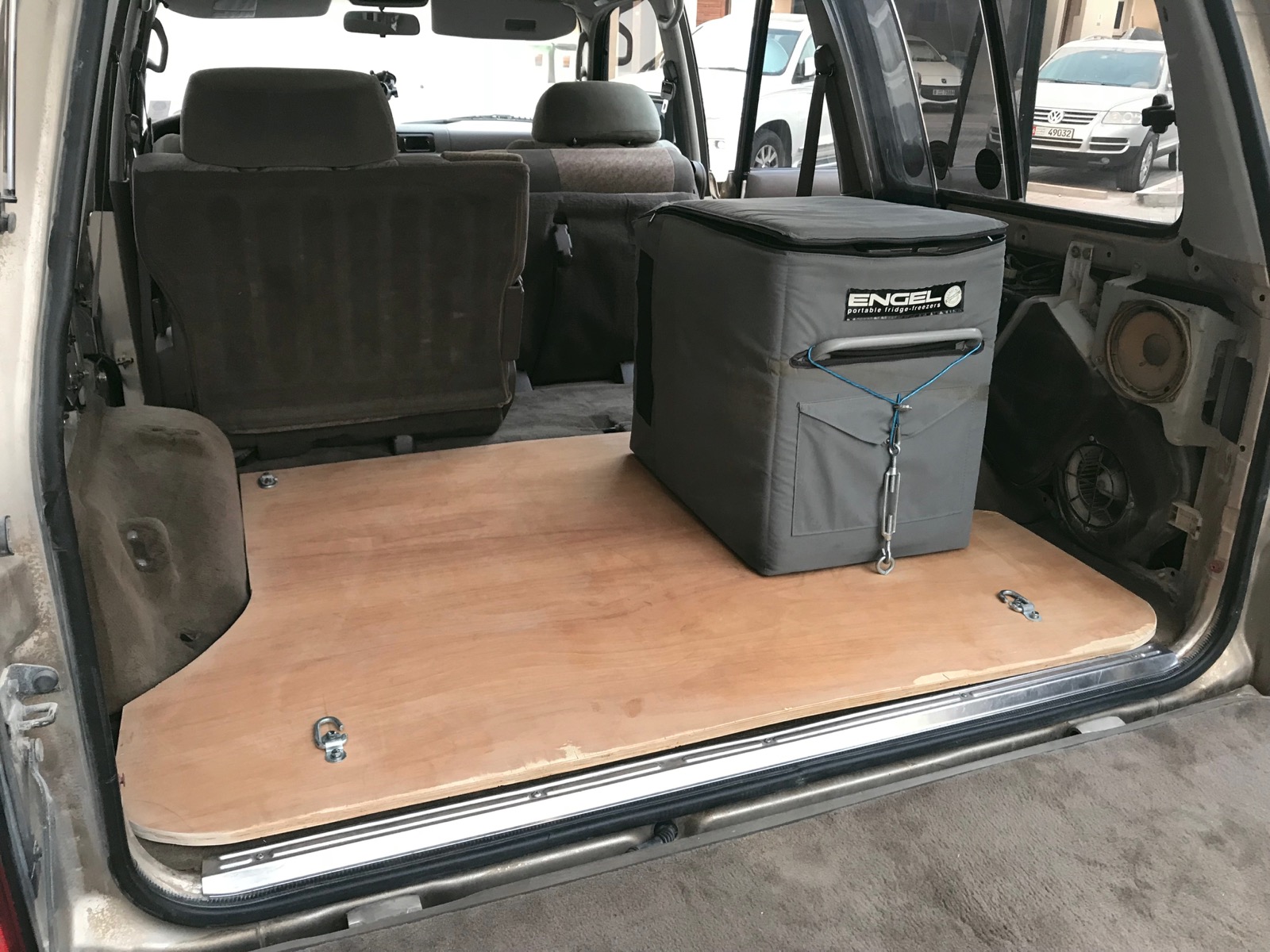

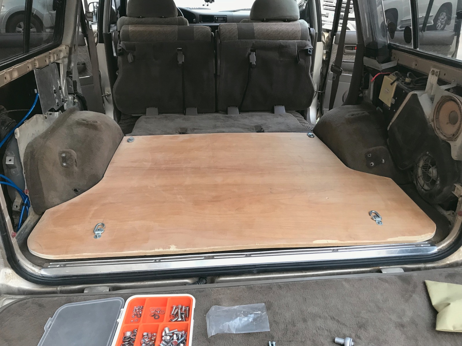

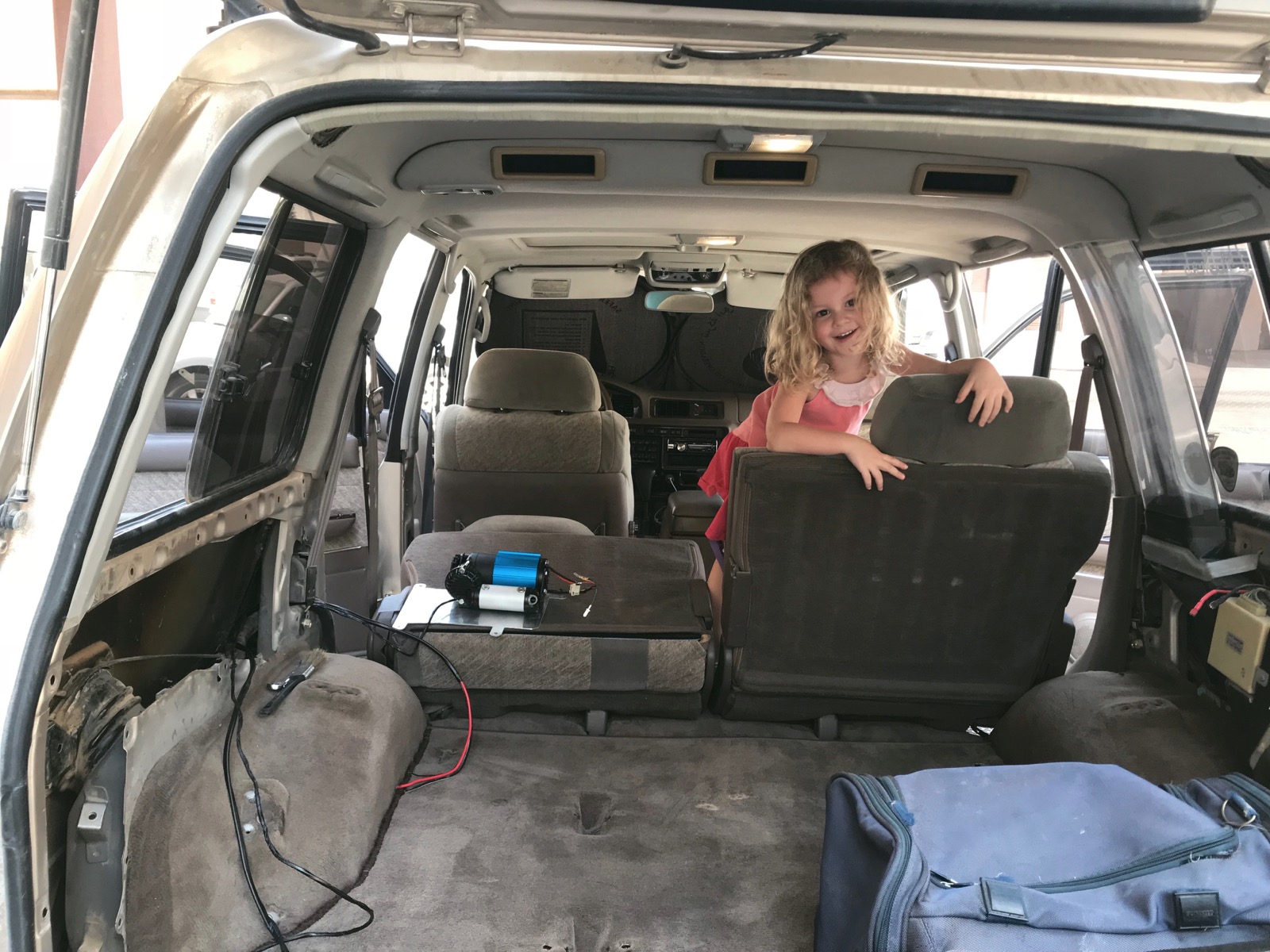

The 80-series has lost it's family car status... it's now my daily driver to work (short commute) and the camping car. So the rear area got some tastefully modification to suit our trips.

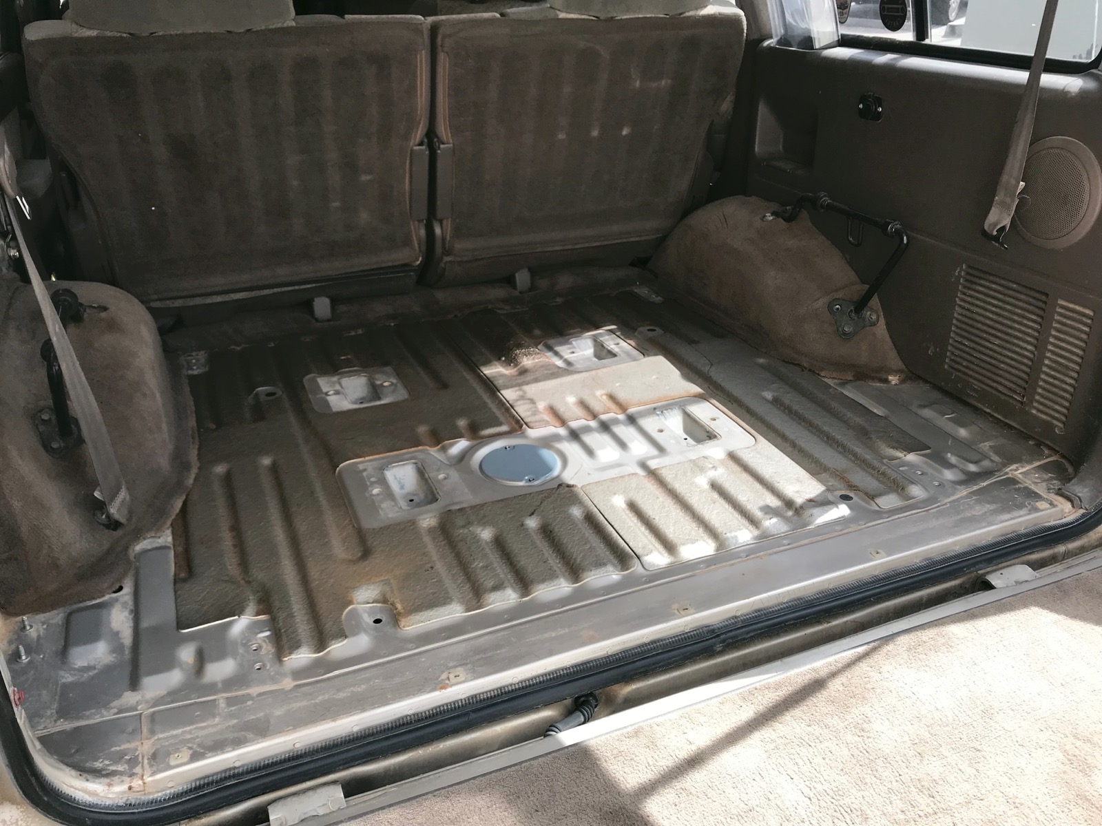

Gutted all the rear-seat appurtenances (even those brackets and seatbelts are gone now)
Custom cut some 3/4" plywood to make a little deck...
Used some longer bolts and the original tie-downs to secure the deck...
And the fridge/freeze is secured in place.
Next is to build a nice chuck box kitchen that attaches to the deck.
