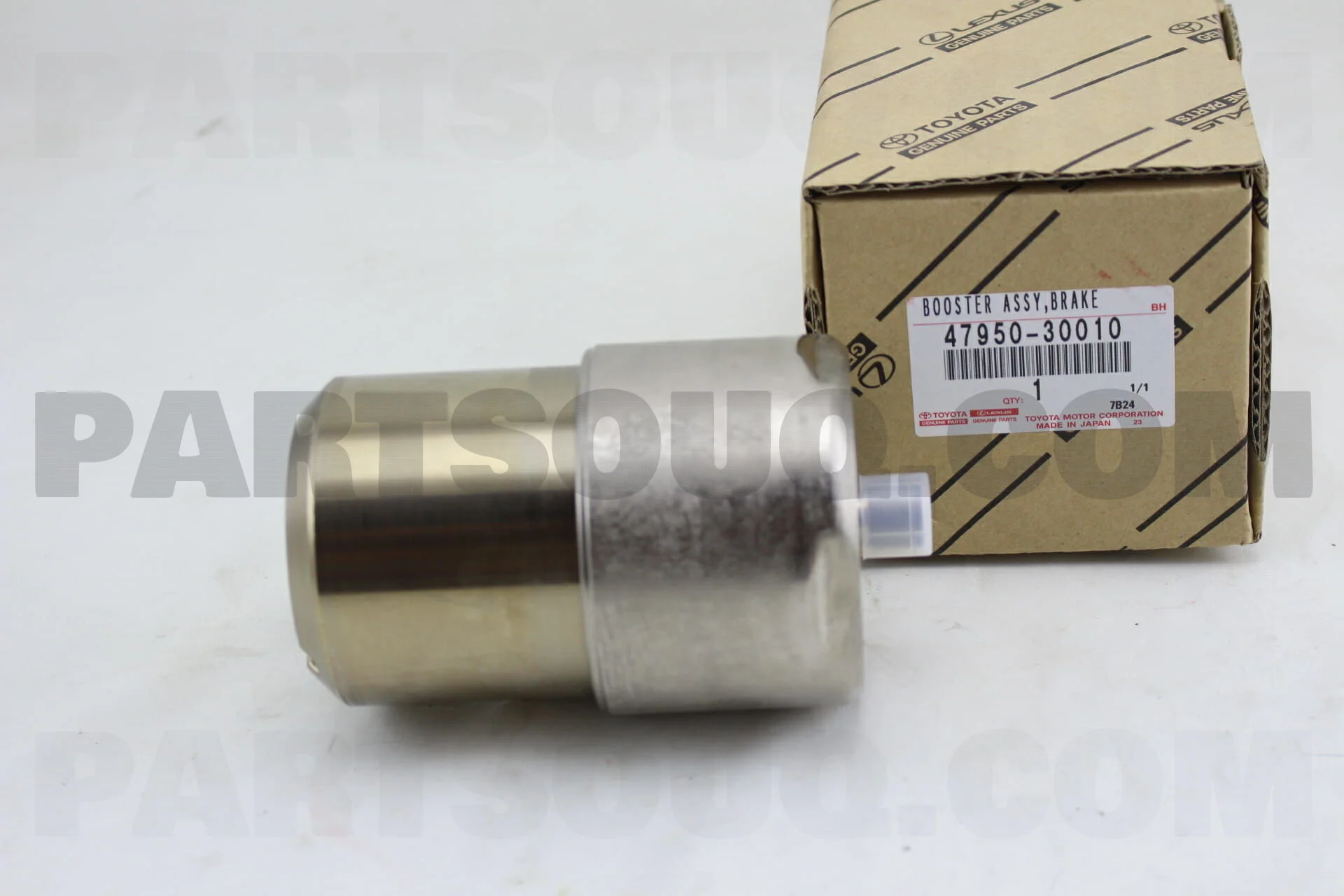

Looks like they sell an assembly with the motor and the accumulator and wire for almost the same price as just the motor.
Does that cover all the prices you recommend or is it still missing something?
it sure looks like it!
yeah that is correct.
My accumulator came today. I went ahead and ordered the larger assembly with the motor so I don't need just an accumulator, but if you need a spare accumulator I'm selling one here. $180 including shipping.
@bcomnes did the swap end up fixing the screeching sound? If so, still have the accumulator for sale? My dad’s GX screeched a couple times at start up this morning.
So the sound ended up going away after it happening that one time. The next time I was at the mechanic there were a bunch of ABS trouble codes that we cleared out, and I haven't hear it since. I guess I just have to attribute it to the massive rain storm we drove through maybe causing some electrical issues?
Ether way, I didn't end up doing the swap yet, however if it was indeed caused by mechanical failure, I'm sure this would address it. I do still have the accumulator available if you want it.
