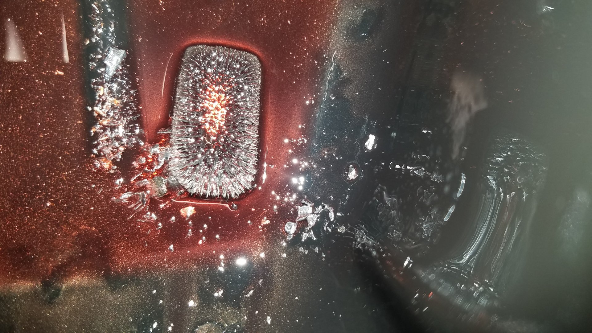

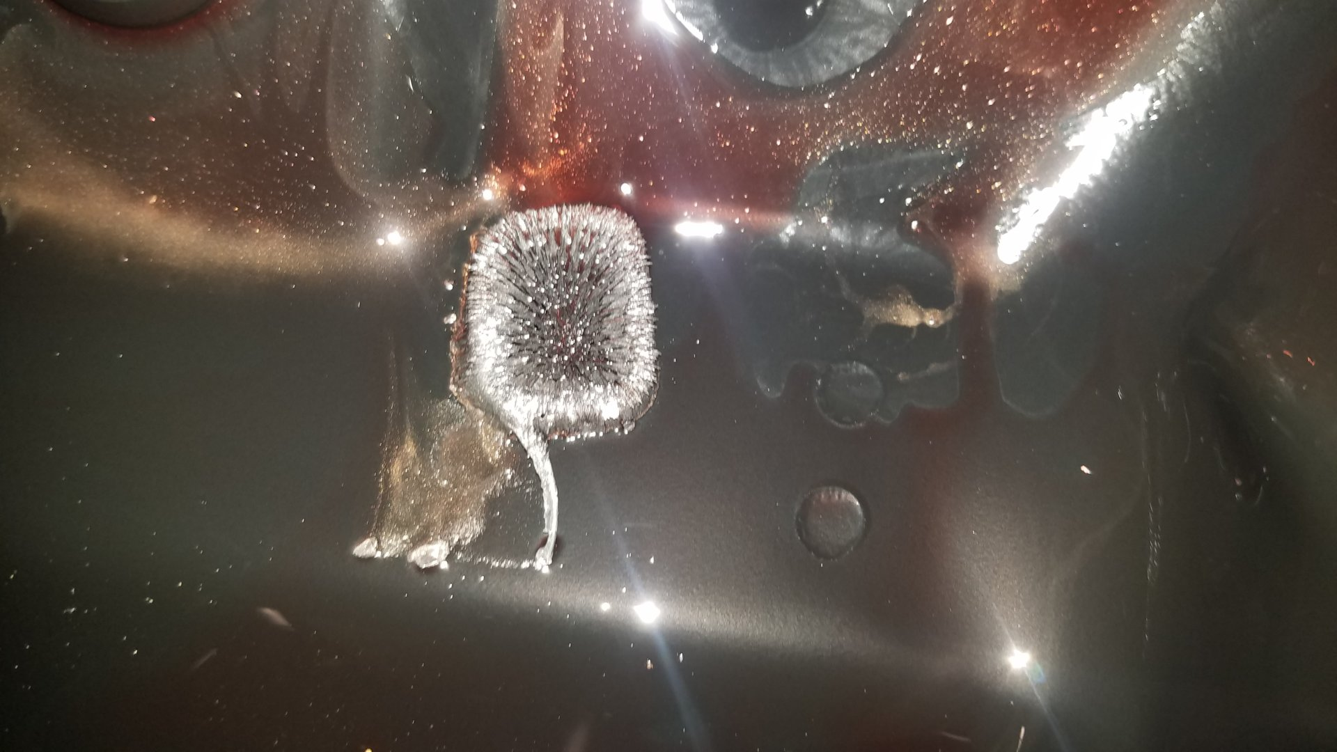

Mine went out :eek:, see Grinding noise: A442F Transmission Failure - https://forum.ih8mud.com/threads/grinding-noise-a442f-transmission-failure.1187315/. So now you have, but the junkyard replacement has been rock solid :rofl:
If the magnets in the pan look like this, then start worrying, otherwise you are probably fine:
