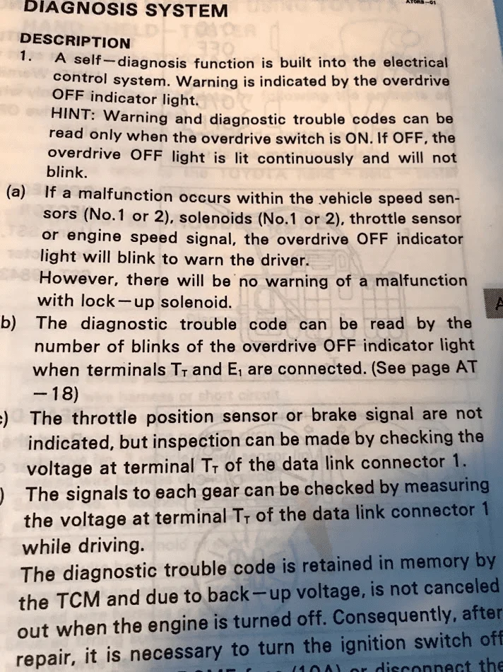

But why would the overdrive flicker like it does?

Same here, let me give a run down
the O/D light flickers (does not blink but flickers)
Slams into reverse if there is any sort of roll to it.
1st seems longer than usual and 2nd revs low. Kinda seems as if it’s in limp mode.
There are plenty of people on the board That are more knowledgeable the me, If you don't have a FSM you need to get your hands on one. I forget who, but you can down load one for free form one of the Mud members.

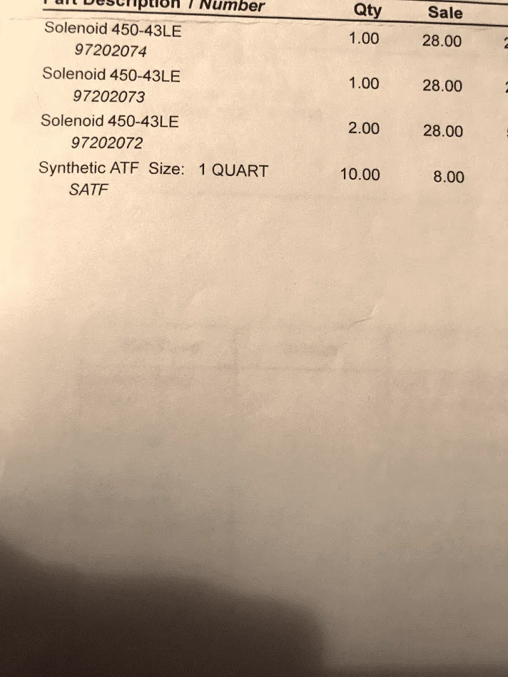

That being said the A442F is a very robust transmission ( sometimes referred to as Bus transmission) I have never heard of one going Bad. They are thought to be a stronger trans the the later model trans. However at there age they commonly have the solenoids go bad. I have a feeling that the solenoids mite be you issue.
When I was having problems with my A442F ( starting off in 2nd gear) the solenoids where the issue.
Mitsubishi solenoids can be used and can be found on line at a faction of the cost. It's also a one :banana: job to install them.
Here some info from my FSM and parts numbers of the solenoids. hope this helps
Note that you need 2 of the 97202072 solenoids if you going to replace them all and you should if you do it.
