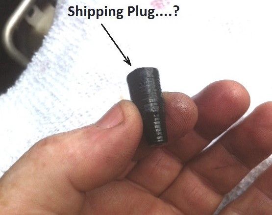

Hope they don't find one of these:
See if they can provide you with the offending blockage- strange that suddenly happens in what was a normally function system.

Had what appeared to be a shipping plug of some type manage get into the rubber line from my transmission to the oil cooler. Couldn't tell you how it got there...but it did. I suppose a hose could break down internally also...creating a full or partial obstruction.

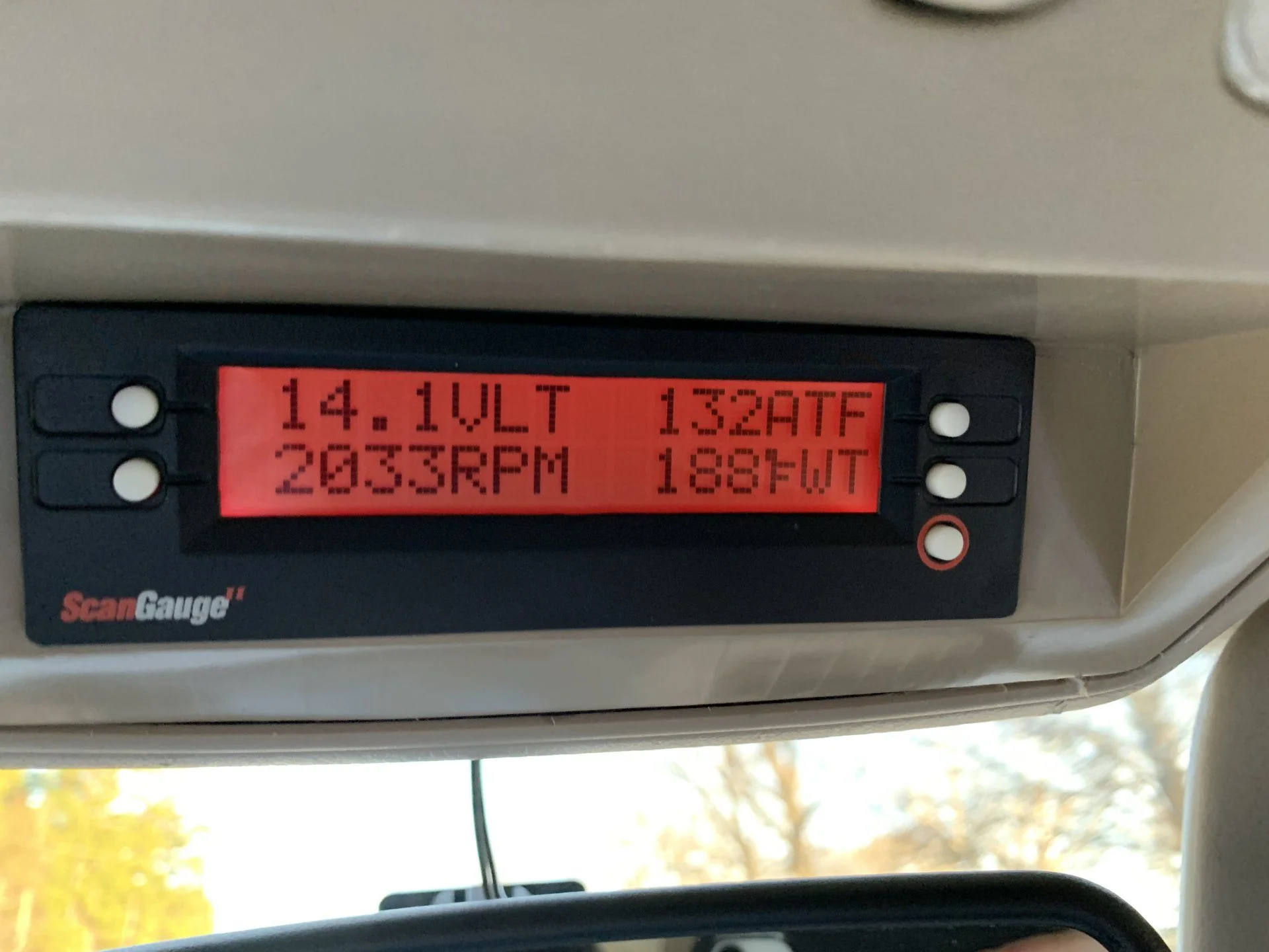

Just curious what everyone thinks of my readings. This was after 1hr of forest service roads at 30mph and then 45min of asphalt highway at 55mph. Are my coolant temps a little high?
That is about exactly where I would be too. About 140 and 190. At faster speeds, the coolant temp will drop to about 178. On sustained hill climbs the trans temps can climb as high as about 200 for me.

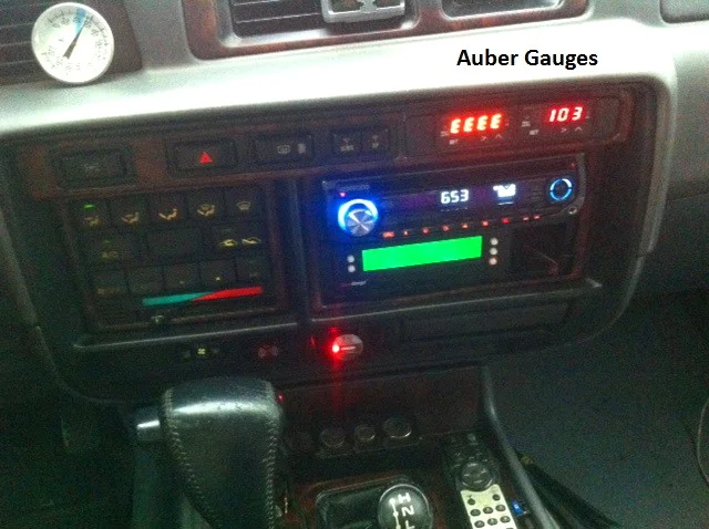

My Land Cruiser has a digital Auber Gauge and a temperature sender/probe
Would you mind post a picture where you mount your Auber gauge please ?
Pulled an 18' foot trailer, with 3700 lbs of payload (tractor, front loader and rotary cutter) for 2 hrs....up and down hills today and never got over 146°F. In my 80 series.
You can mount an auber gauge just about anywhere, but I put two of them (one for trans temp....the other an aux oil pressure gauge) in the space where the cup holder used to be (removed).
This makes a clean install:

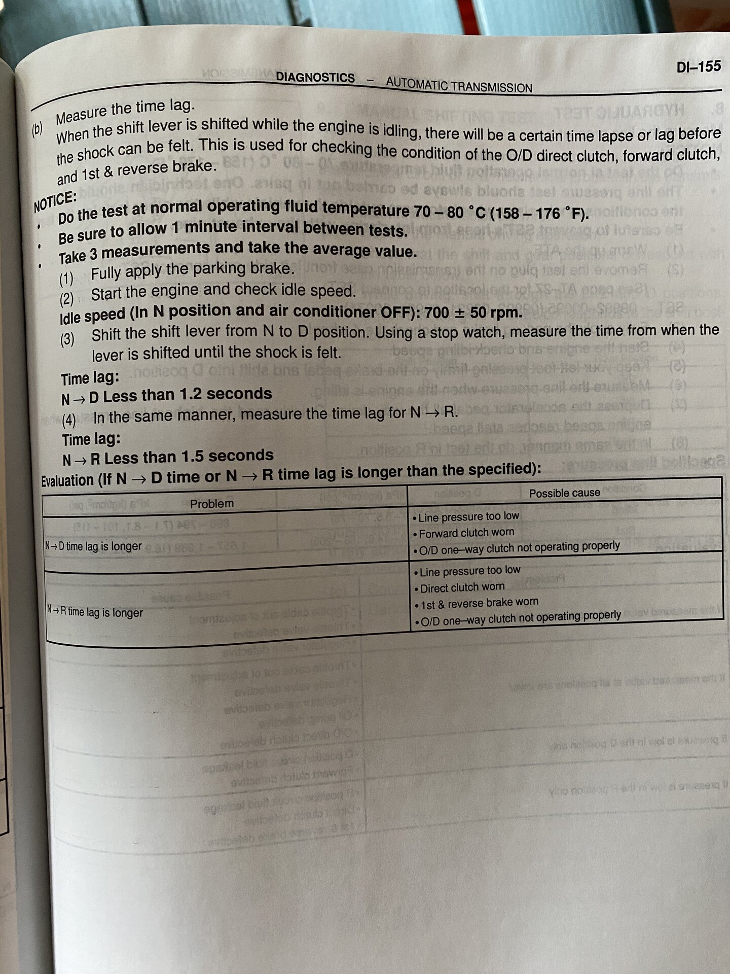

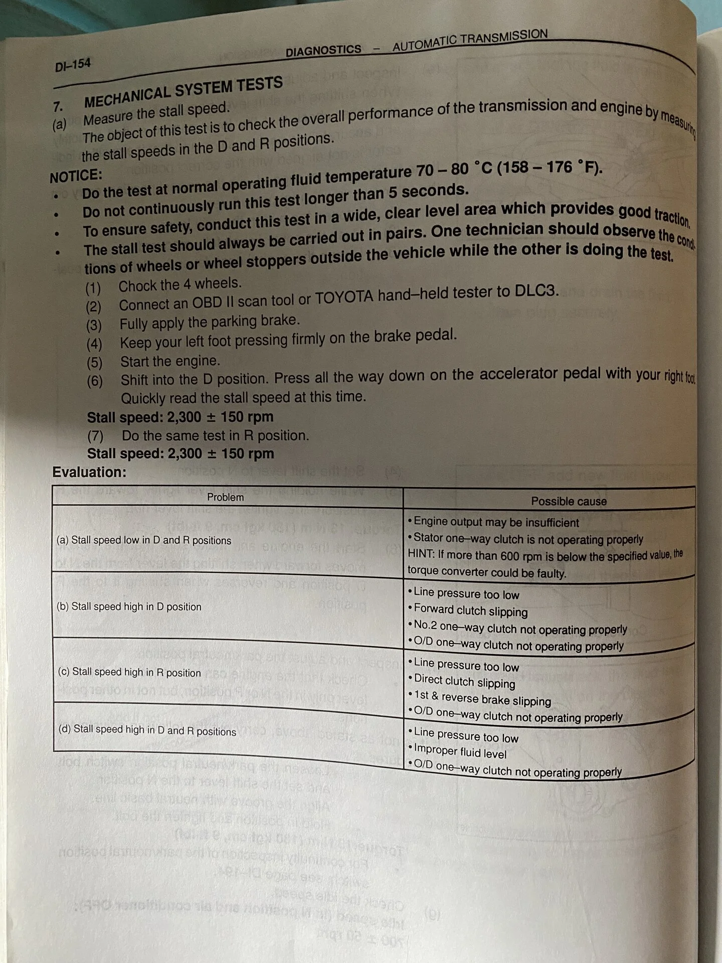

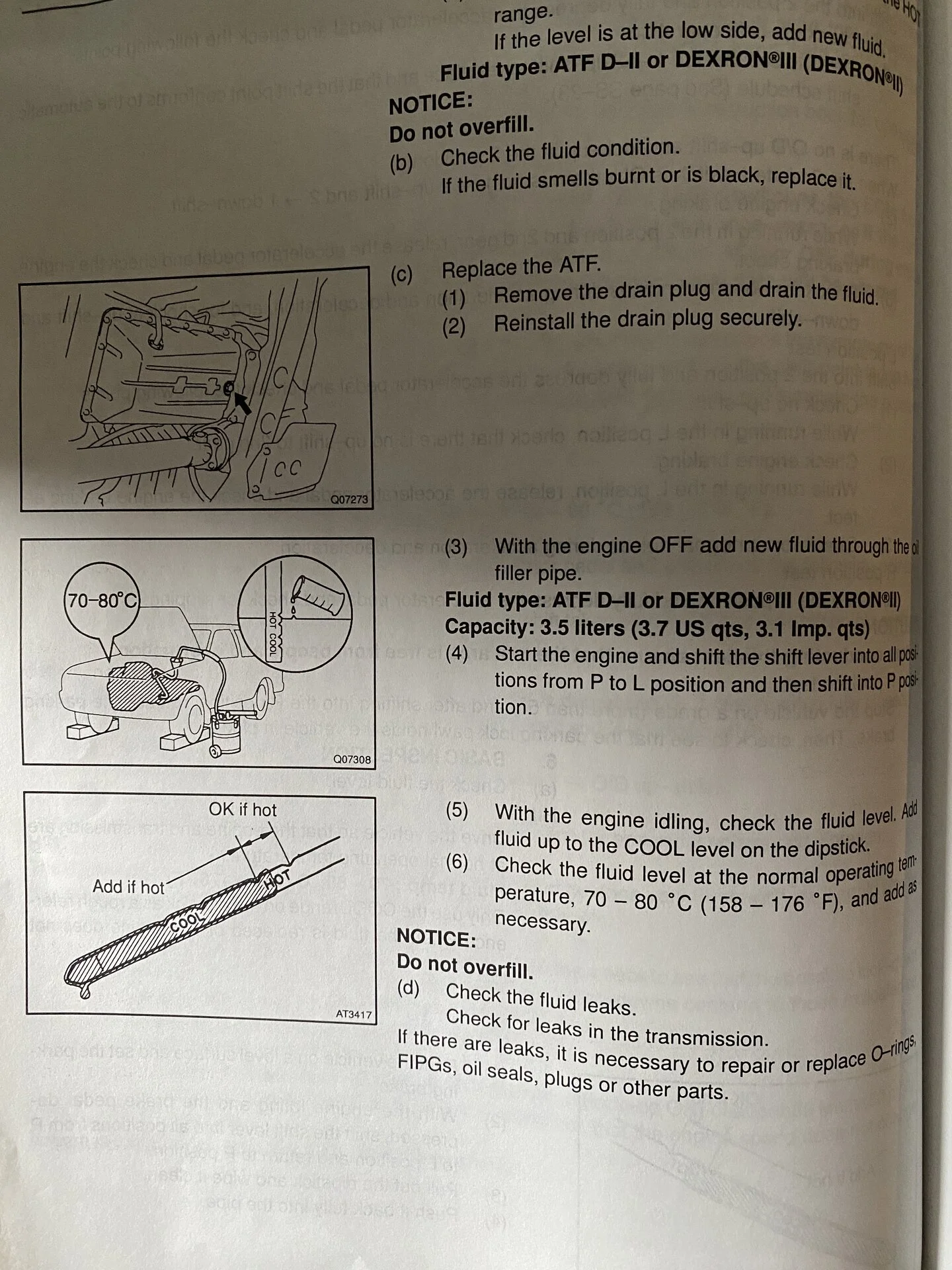

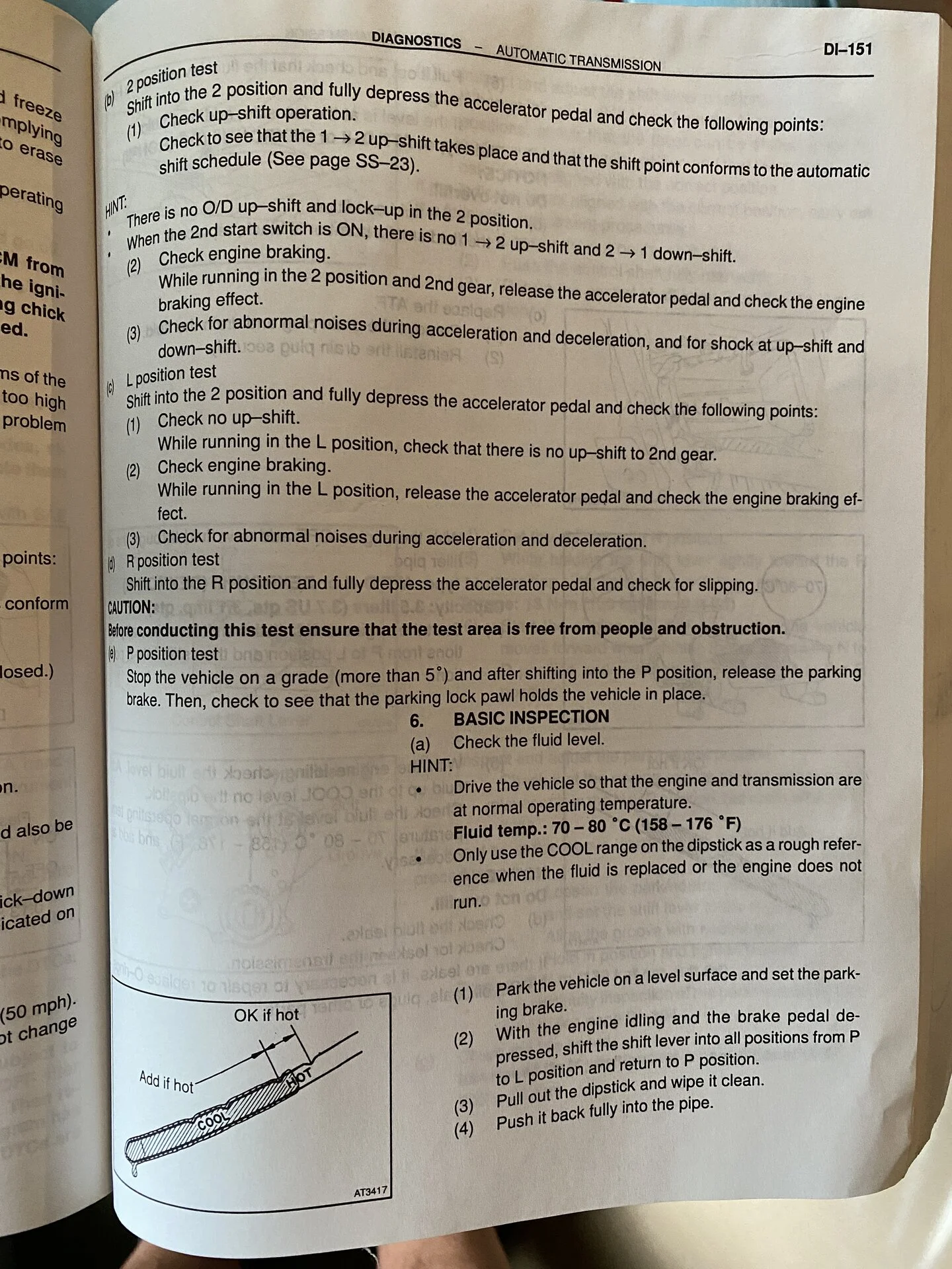

Okay, seeing some interesting variation in this thread. The FSM repeatedly says the normal operating range for the A343F is 158f-176f. But some seem to never get into this range, with typical readings between 120f-140f. I am seeing values in the FSM range during typical driving.
Youre lucky to have the A343- makes it easy to check on condition and level. Those regular temp numbers posted sound typical. I might do a drain and fill ahead of your Colorado trip (3-4qts) to refresh the fluid. Climbing trails puts a load on torque converter resulting in a lot of heat.
