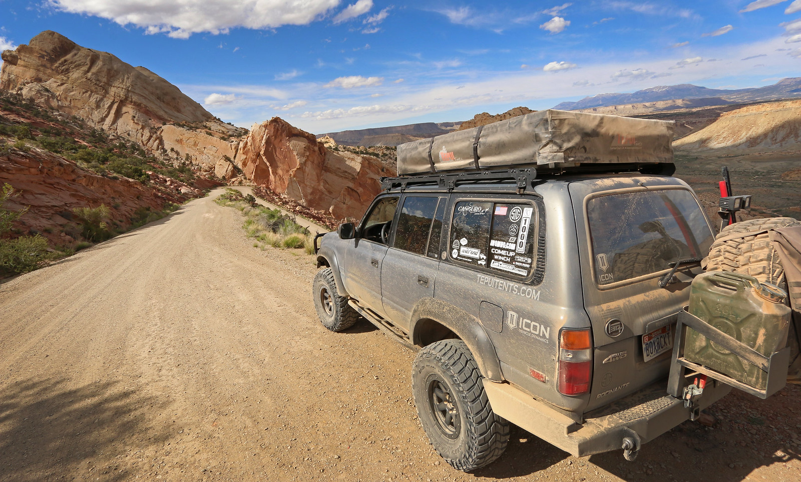

No disagreement about the gutter attachments being better on the Bowfin. It's a nice rack. I have had my Prinsu rack for 4 years now with lots of use, lots of miles, lots of roof loads, lots of fast offroad driving and have never had an issue with the Prinsu gutter clamps coming loose or slipping off the gutter. I've noticed that many prinsu owners over-tighten the gutter clamps which deforms the j-hooks and makes it easier for them to slip off the gutter. Just getting them snug is more than enough. Mine have held securely, and the rack has never moved.
Not trying to convince anybody to get one over the other, just sharing my experience and observations. I think whichever rack is chosen will make the buyer happy.
IMG_7291 by Adam Tolman, on Flickr
