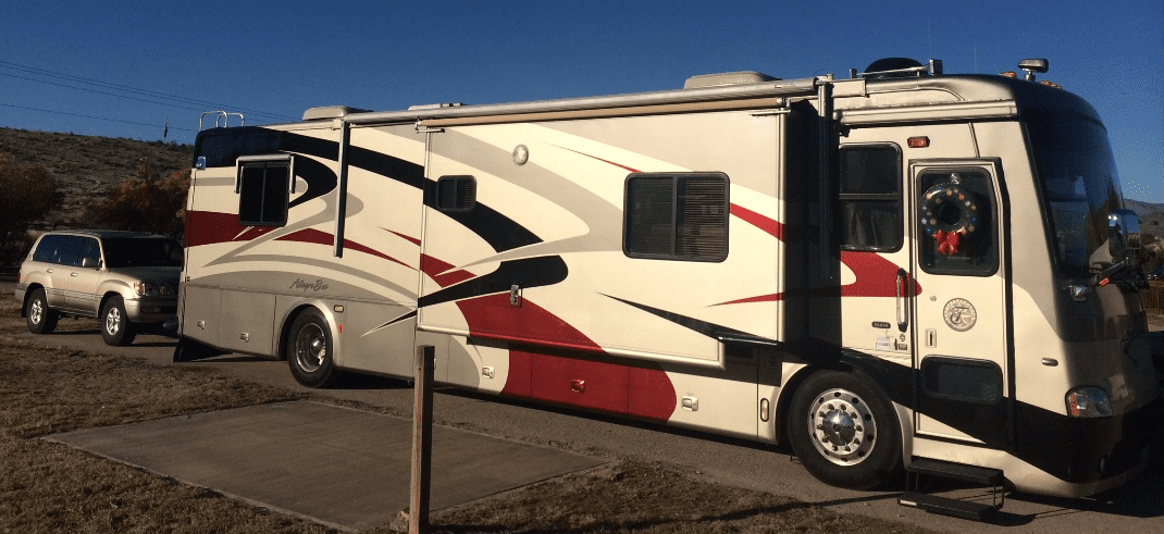

I flat towed my 2005 LX from South Florida to Utah. You absolutely have to put the key in the ACC position. Otherwise your steering wheel wheel lock because it happened to me at least in my year. I caught it pretty quickly and there was no damage thankfully but other than that I have to say don’t get a cheap Amazon knock off battery maintainer. Spring for a roadmaster white blue ox because mine did not work and killed the battery. I ended up having to put a charger maintainer under the hood and run an extension cord from the back of my boss. and run an extension cord from the back of my bus!
Here’s a picture of the rig.
